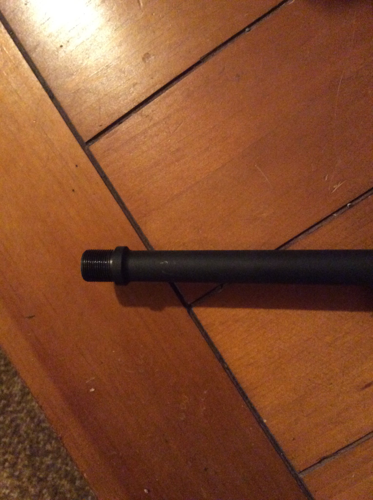

Does anyone or can anyone make a custom bbl for a 20” 6.5 Grendel build. I want a light (#4) but I need it contoured so the last finished 1” will be big enough to thread 5/8x24 and leave a shoulder. I prefer a cut rifled bbl just because. Thanks!!
A 5/8-24 thread has a major diameter of .625. Any barrel that’s roughly .725 and up at the muzzle will be sufficient.
Just a FYI. Any cut barrel maker will make just about any contour you like at no extra charge as long as you stay under their breech diameter and length limits. Usually that cutoff is over 1.25” diameter, and over 28” finish length. You can go bigger and longer, but you’ll pay extra for it.
I am wanting a bbl made like some pellet gun bbls that are swelled hvy at the muzzle. Not just custom “straight” taper. That way have smaller diam bbl but it will swell at end to have enough diam to thread muzzle
Contact your barrel maker of choice and they can probably do it. I have a Forbes rifle that was made like you describe.
You mean something like this? Reverse taper getting fatter towards muzzle? Contact John at Keystone Accuracy. He will contour anything you want.
This is a reverse taper then fluted.
Reactions: b6graham
No problem at all. Any of the high end barrel makers will do anything you want, and it won’t cost extra as long as you stay under the thresholds I mentioned above.
