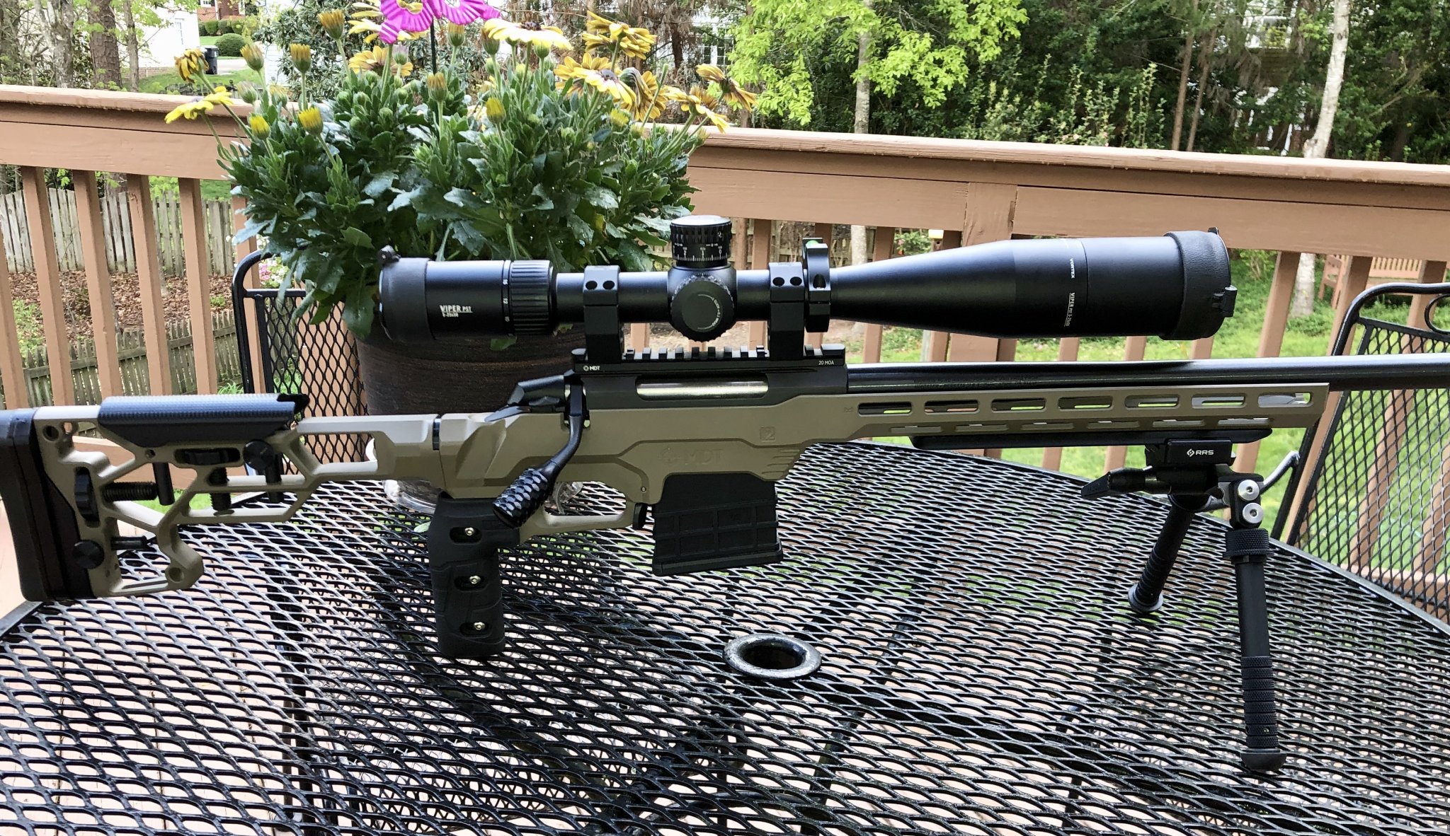

Here's my Tikka Varmint in .223 in an MDT LSS-XL chassis / MDT skeleton buttstock / 20MOA rail with an Anarchy Outdoors bolt handle (the "large" knob was too large; wouldn't do that again), MDT ARCA rail and vertical grip, and MDT 10-round polymer magazine. It's always puzzled me why Tikka sells so many of their rifles (TAC A1 notwithstanding) in those horrid rubber stocks...
EDIT: I added the MDT upgrades piecemeal over time. While the older LSS-XL chassis is a lightweight, excellent chassis, someone who intends to use a Tikka or whatever for PRS would probably be better served to purchase an MDT chassis created for the purpose.
