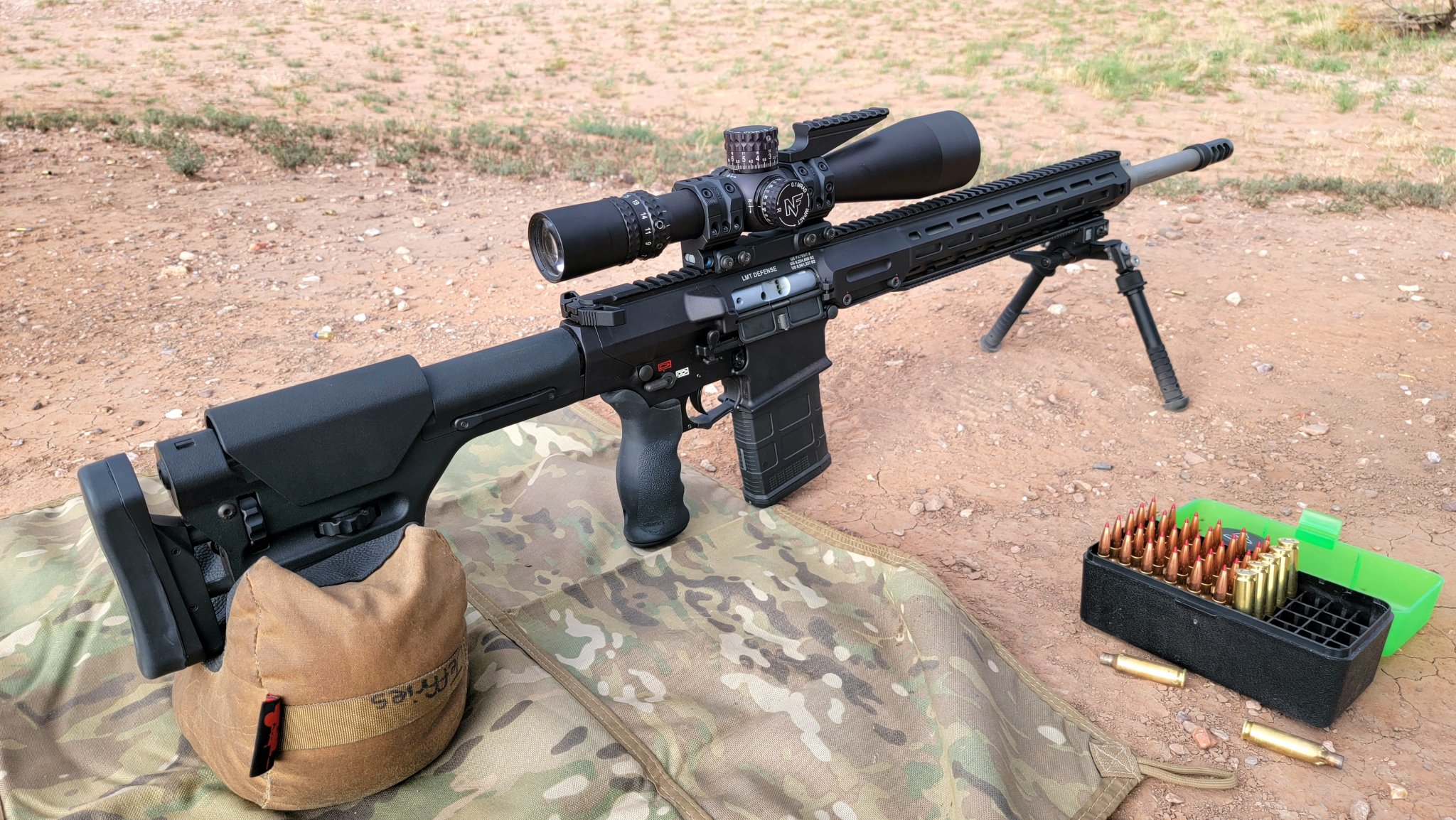

Craddock 22" 6.5cm converted by Dwilson.
Totally happy with the way it turned out and shoots.

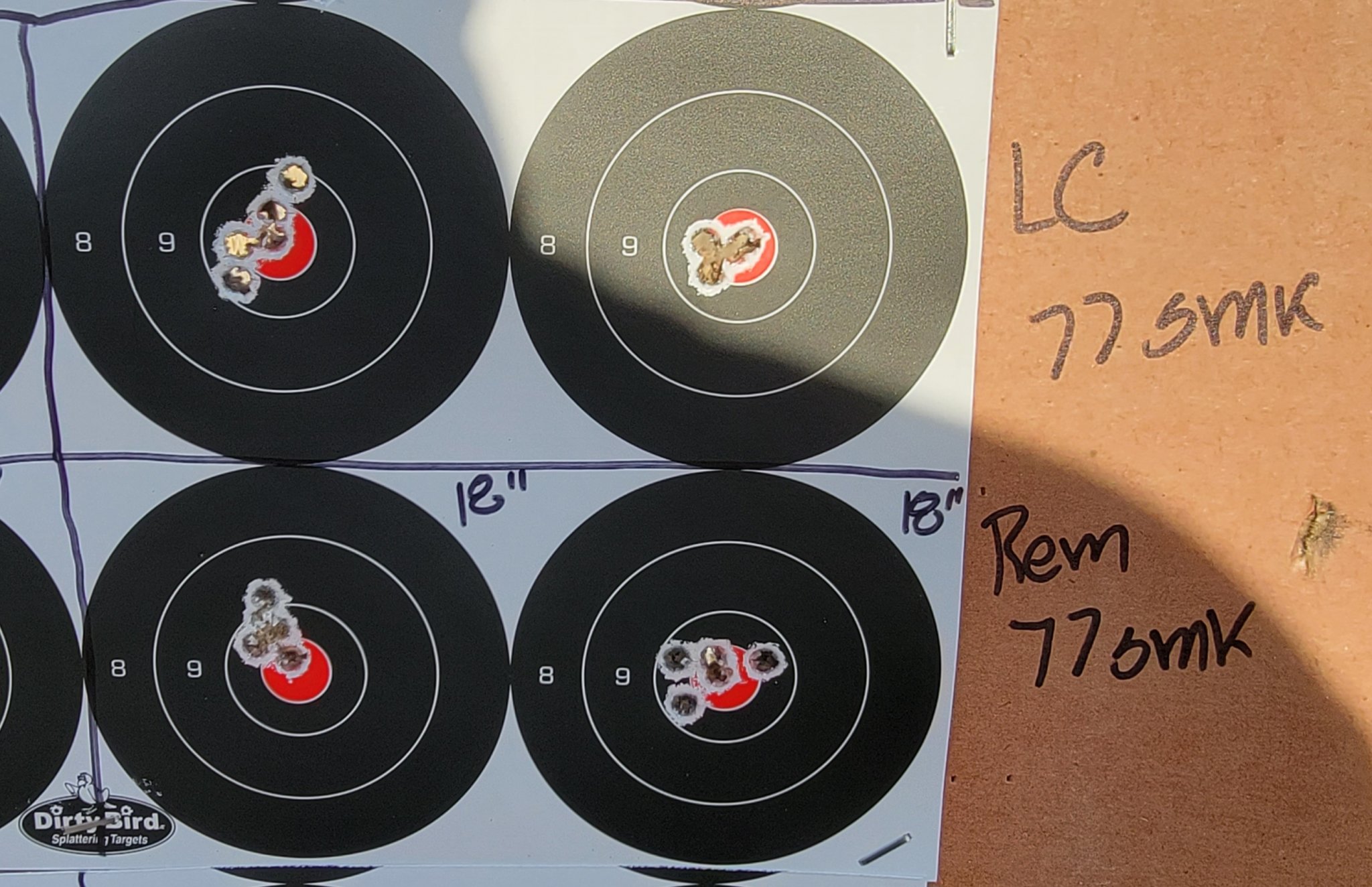

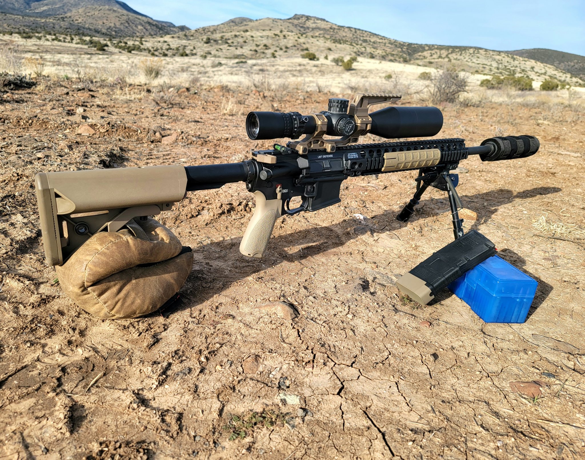

I will vouch for the accuracy. I don't have any pics of groups handy on my MWS posted above but I also had him do a 223 Proof for me recently and got these the first trip out a few weeks ago just testing loads. Rifle picture as well. Other loads tested didnt fare as well. (75 hornady BTHP) but the 73elds showed some good promise. The 4 groups pictured of 77s were the only 4 groups I shot with 77s that day and were clear winners. The MWS shoots just as well with 140eld hand loads

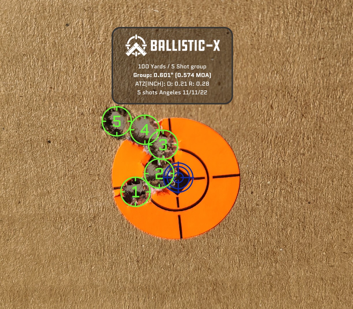

I have a Wilson combat super sniper 24" that D.Wilson converted. Shoots .6 MOA w factory NORMA 143gr. This was windy day. Board was blowing around.

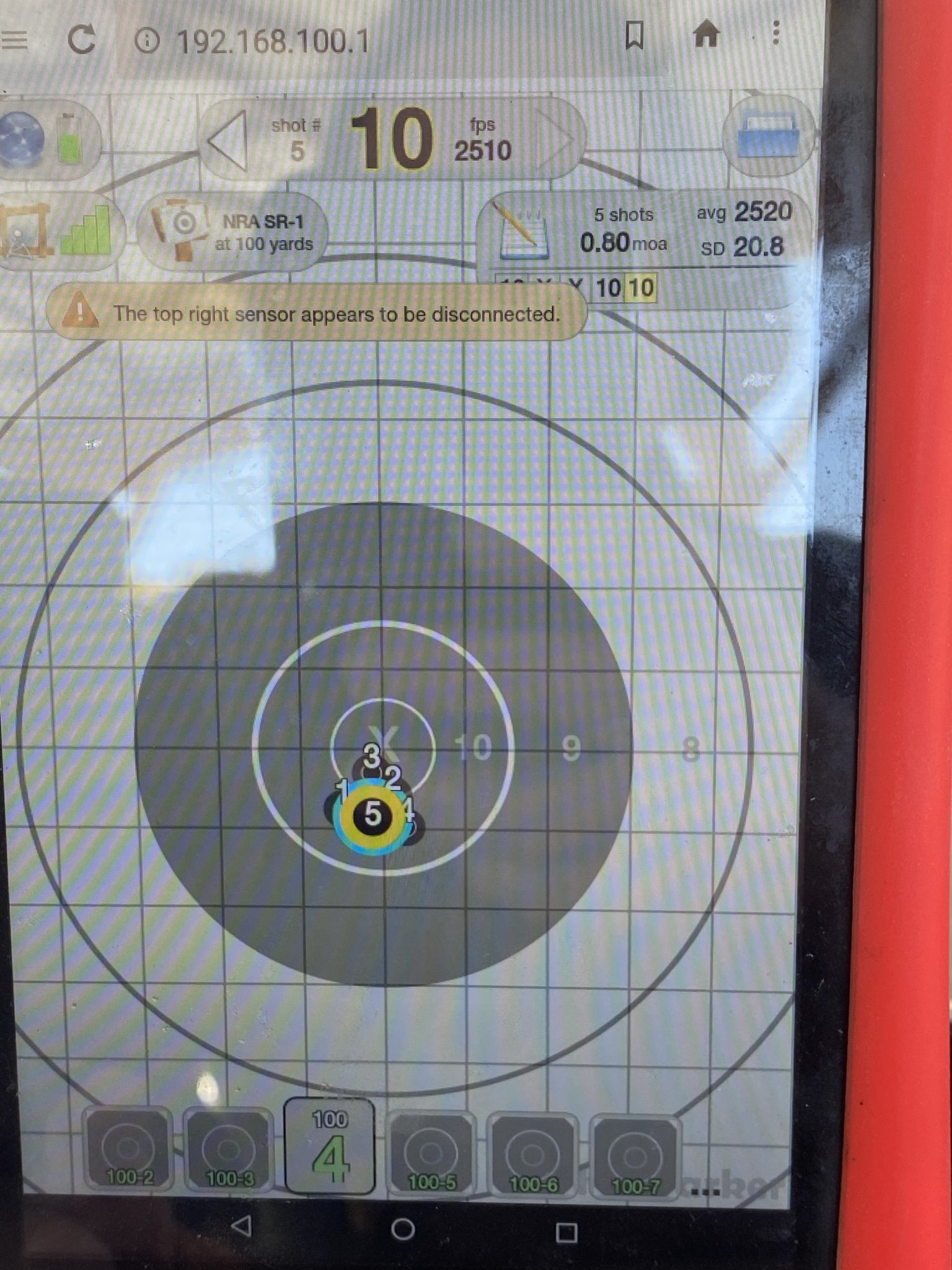

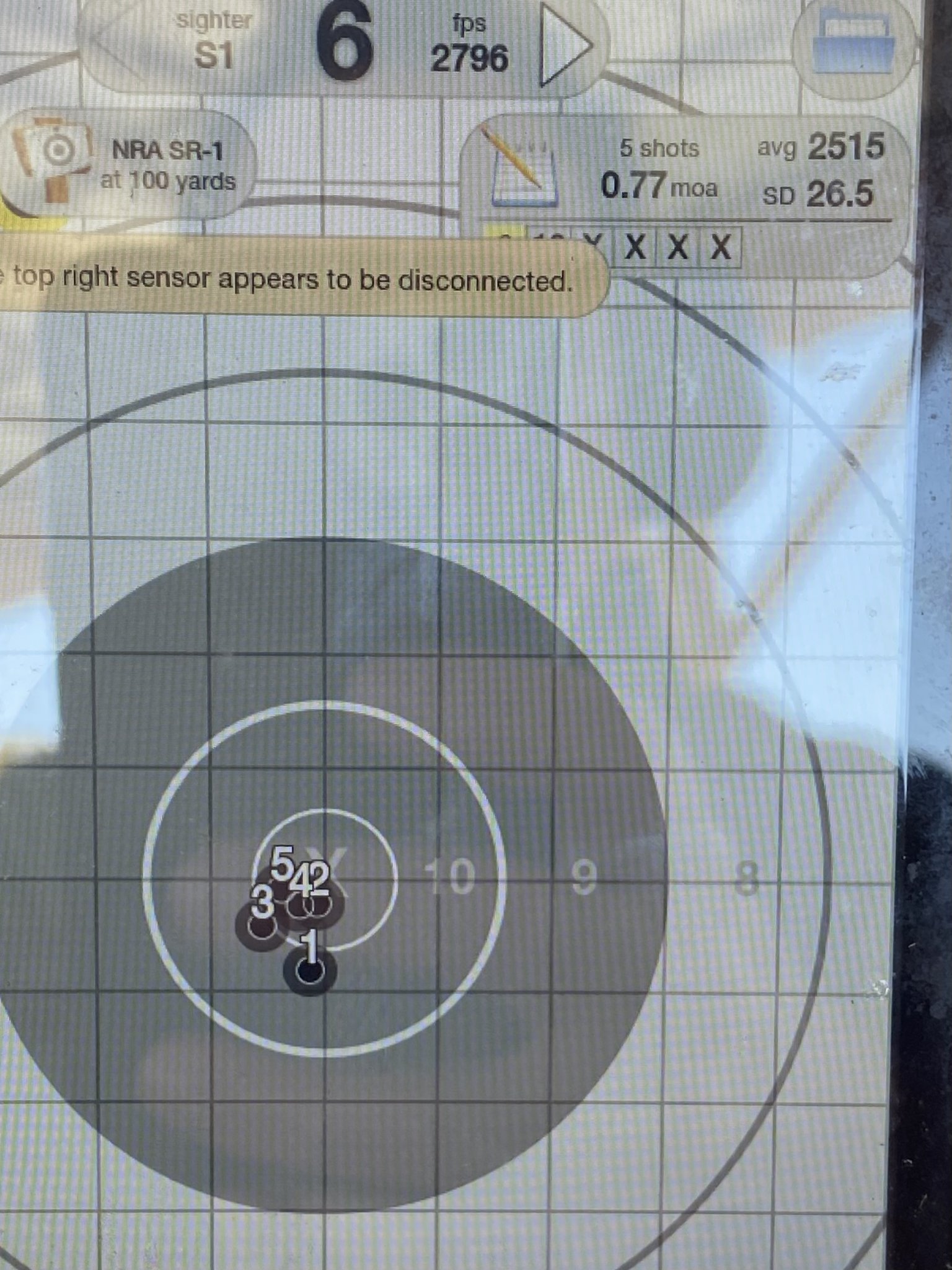

Nice (y) What barrel length did you choose and what ammo has been working for you. I've been contemplating a 22" Bartlein custom.
I bought the 22” Carbon Proof 6.5 CM barrel. I have been loading 140 eld-m over H4350 with 5 round groups 0.7-0.8 moa. I am not a very good semiauto shooter but have been really pleased with the results.
Reactions: eric90503
