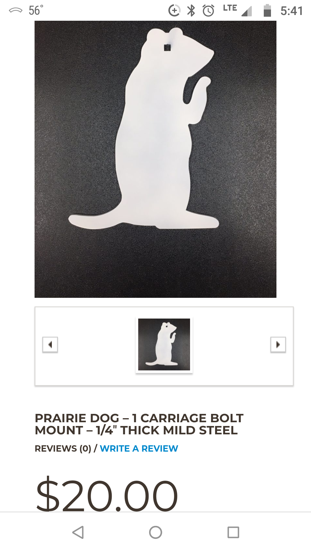

Best Targets supplies 22 steel to PRS style 22 matches and has a wide variety of targets. 1/4" is used, likely due to improved sound and plate reactivity when struck with a 22 projectile.
https://www.beststeeltargets.com/product/prairie-dog-1-carriage-bolt-mount-14-thick-mild-steel/
