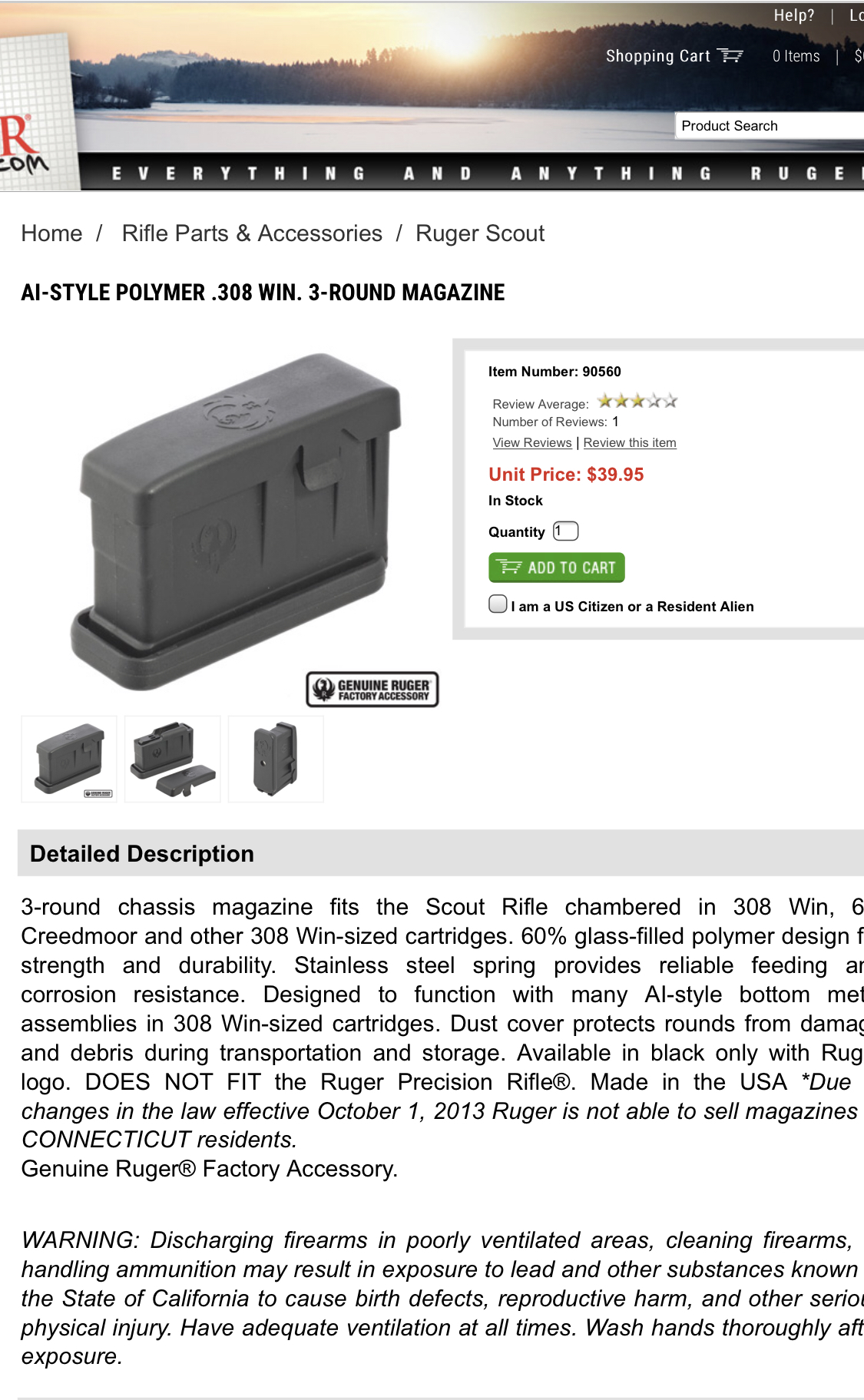

Ruger makes a 3rnd mag that is compatible with ‘most’ AI type bottom metals,there are two models one is for the Gunsite scout and the other for the above mentioned.They are plastic.
This is it here.Its not completely flush but as close as you’ll find in factory form.
