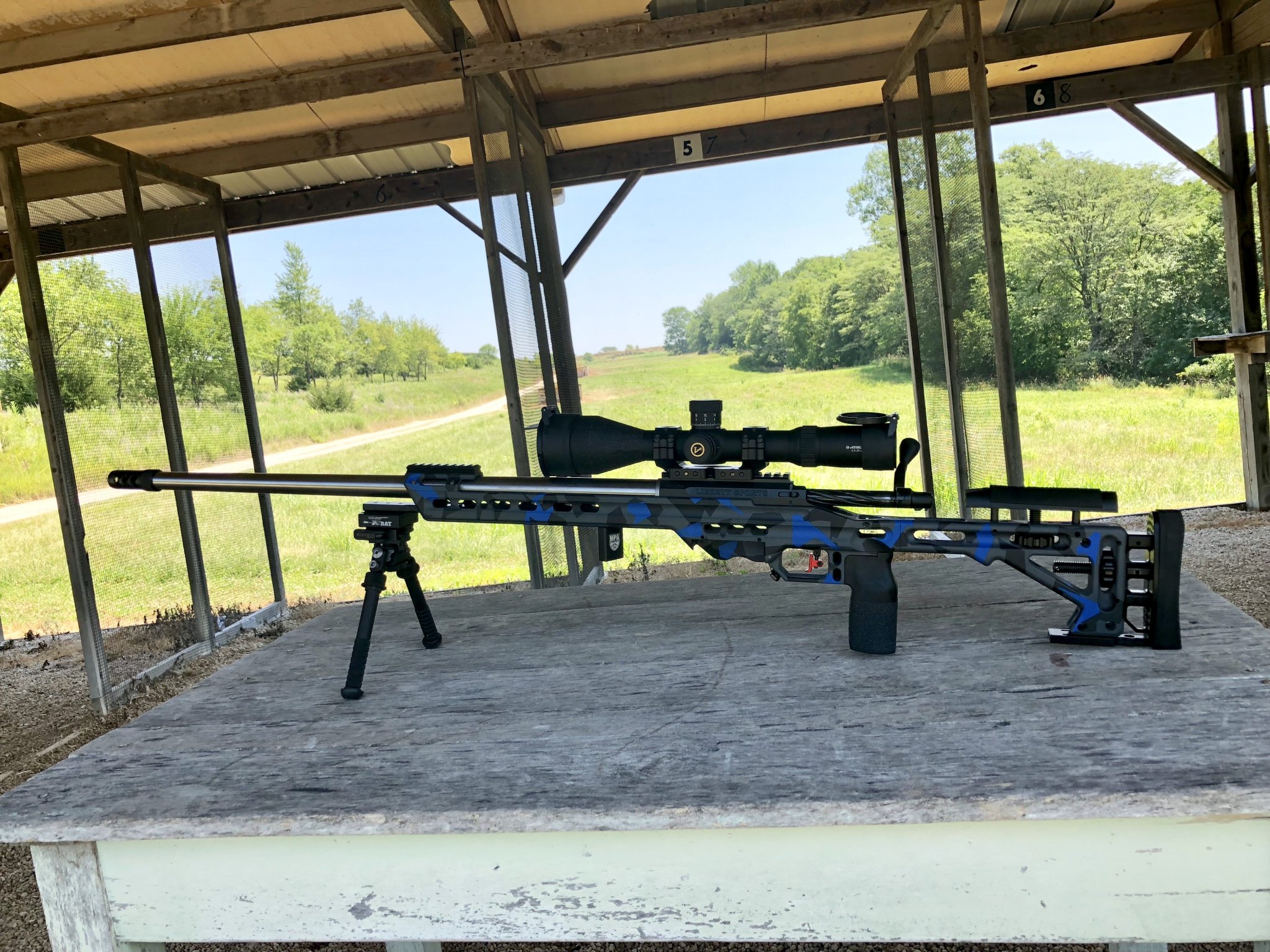

Who has cut one down? What did you use to cut it straight? I’m thinking a bandsaw would make the straightest cut but not sure I can clamp it down tight enough so it doesn’t move without eggshaping the sunshade.
Currently my sunshade is about 1” too long to clear the NV bridge on my MPA chassis. It hasn’t been a big deal running without a shade until a week or so ago when I was trying to get some practice in at the range.
