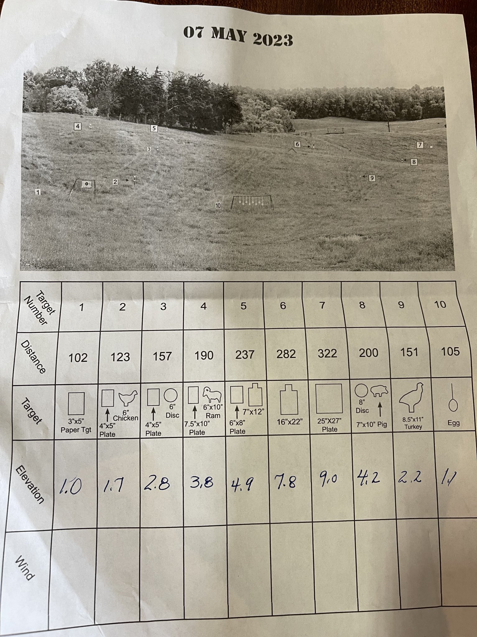

So….pictured above is the course of fire today. Temps were mid 70’s wind was light (as in slight breeze). Matter of fact, I only held edge of target to make my hits, no hold off required on any target. That ends up equaling about .2 from center of target to edge. That is not to say that I hit all targets center, but today was more of a learning shoot.
I don’t have a range where I can dope these rounds all the way out to 300 and beyond, so I relied on the Kestrel for doping. I think I have a BC input of G1 of .230.
So shot the first relay and adjusted DOPE. Adjusted / actual DOPE is what is written. Per Kestrel= 100 was .2 too high. 123 was on. 157 was .5 high. 190 was .2 high. 237 was 1 mil high. 282 was on. 322 was .2 high. 200 was on. 151 was on. 105 was .1 high.
I tried truing MV and I also adjusted BC. The result of that was some distances would match up to actual DOPE and others were still high. So I think Kestrel just struggles with these little 22 pills…..or it could be that I am not aware of how to bring the truing to the .22 bullets. MV of these little pills is right at 1550 as recorded by Magnetospeed.
So this is a 30 round relay. Two shots on targ 1,4 on targ 2, 4 on targ 3, 4 on targ 4, 4 on targ 5, 2 on targ 6, 2 on targ 7, 4 on targ 8, 2 on targ 9, and two eggs.
On relay two I dropped 5 shots. I hit every target at least once. Not bad, but no real conditions to shoot around. Not sure how it would have gone had the wind been more of a factor. These rounds certainly have the speed, and accuracy is there, but as compared to some 40grnrs in the wind…not sure.
