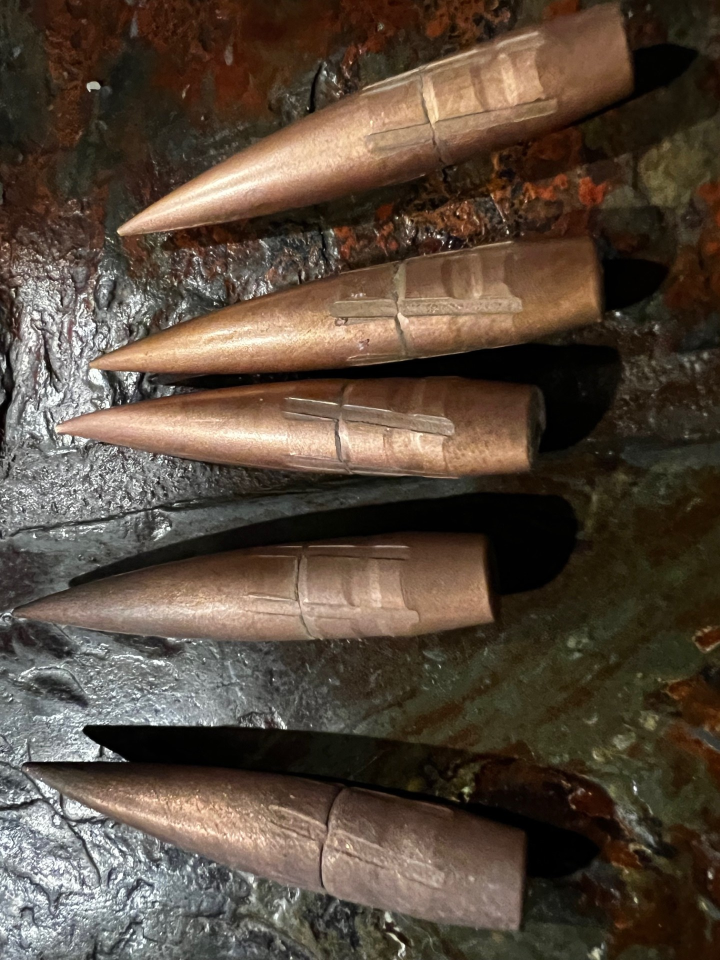

    We recovered some solids at the base of a 2300y plate last year. They were only mildly (a relative term) deformed by impact, which was at an extreme angle.

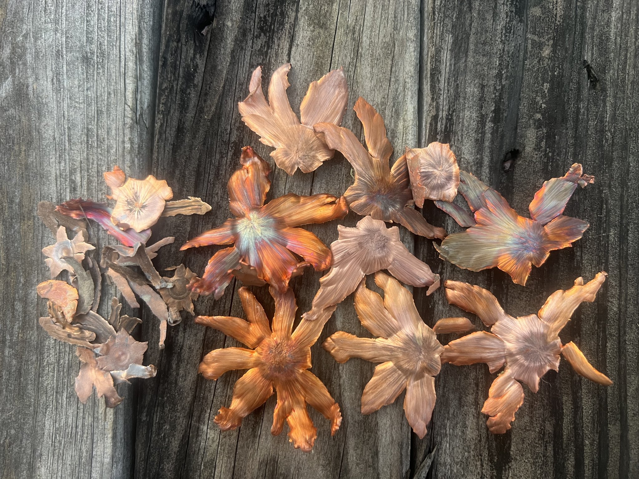

    These were recovered a couple of years ago from near a 2250-yard target:
    Interesting. Here are some .338 Badlands 285gr solids we recovered from a standard 338LM at 1626 yds. NOT 2250, of course, but it’s “only” a 338LM, Light-Class gun:
    And yes, the splash still sucked and they shot like crap compared to the 300gr Berger and Lapua Scenar.
