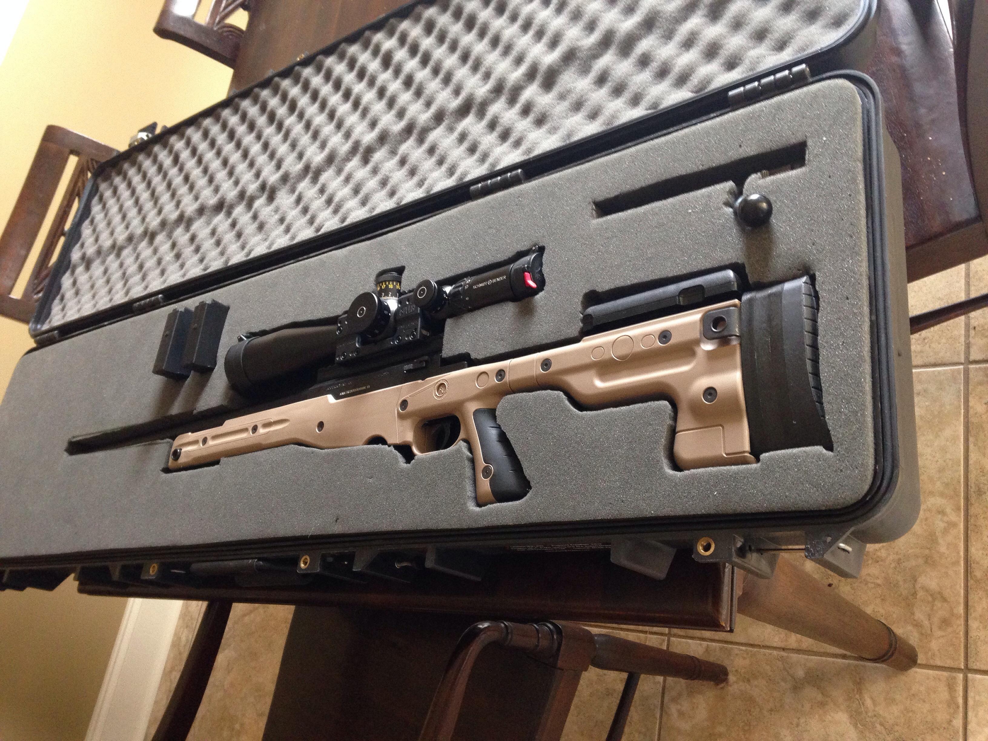

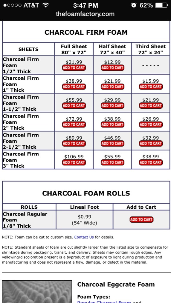

Also, you can get foam much cheaper from foam factory's online store. I buy the charcoal firm foam for most of my cases

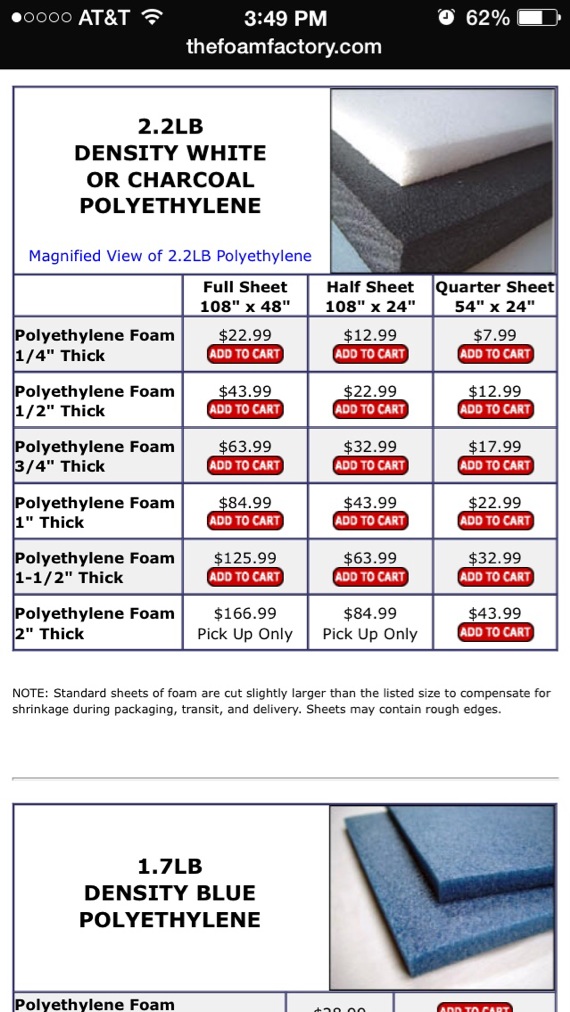

If you want a little nicer foam, the closed cell 2.2PE is about the best you can get. I use it for all of my pistol case and my expensive rifles.
