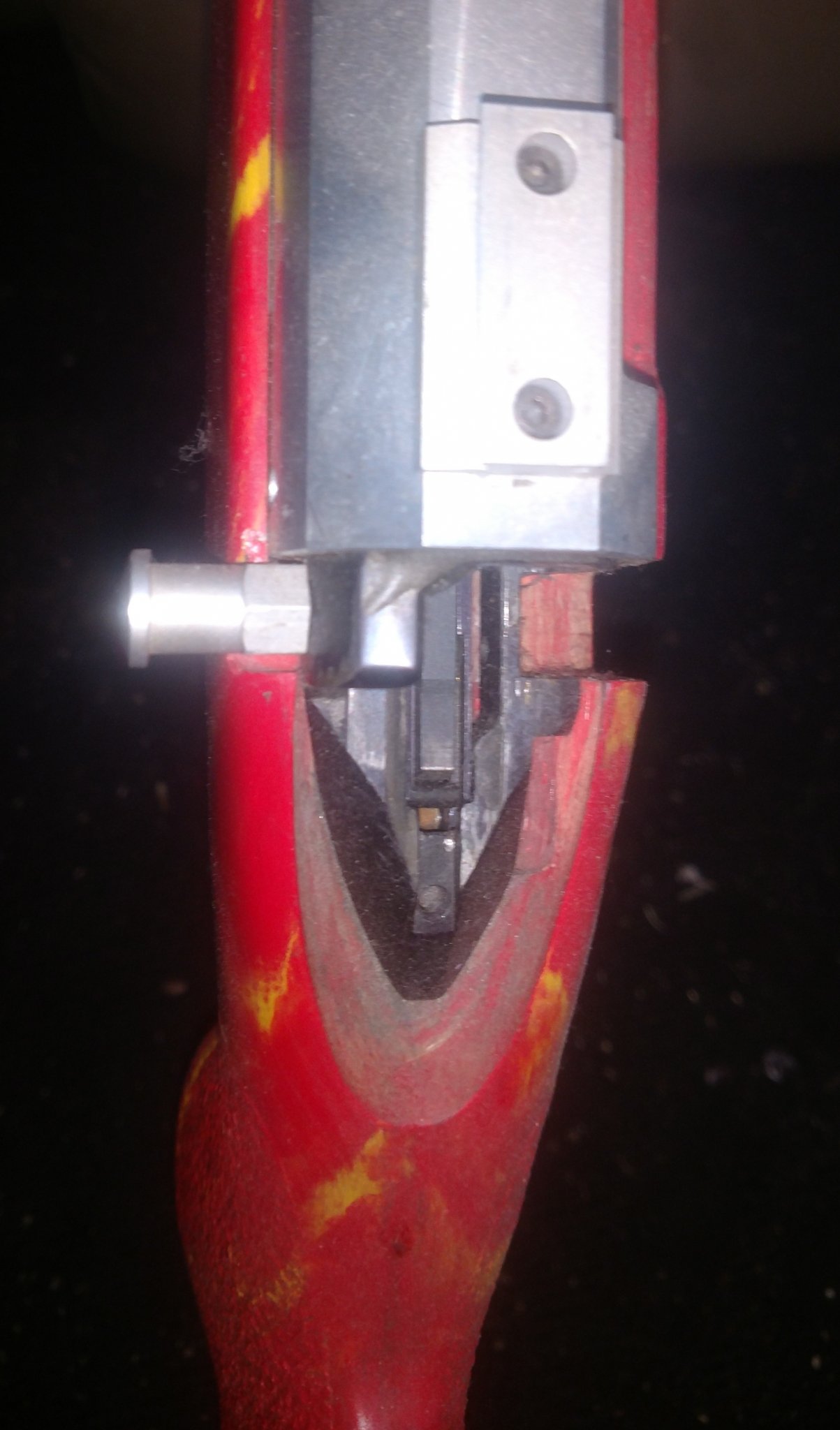

He can also put a side bolt release on the gun rather than the trigger. They make one that has a reasonably light spring and a bigger knob for easier use.
Here is a silver one I am using on my test gun.

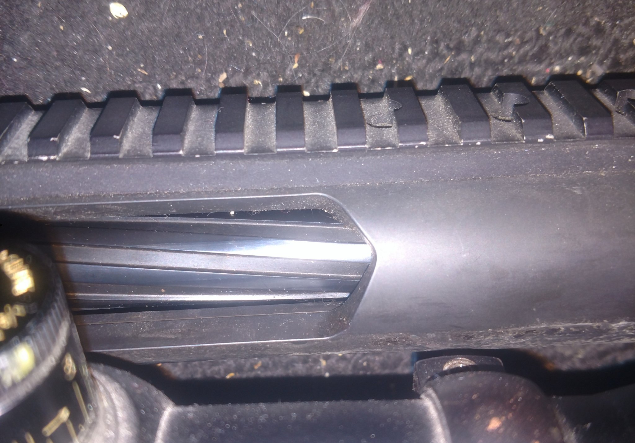

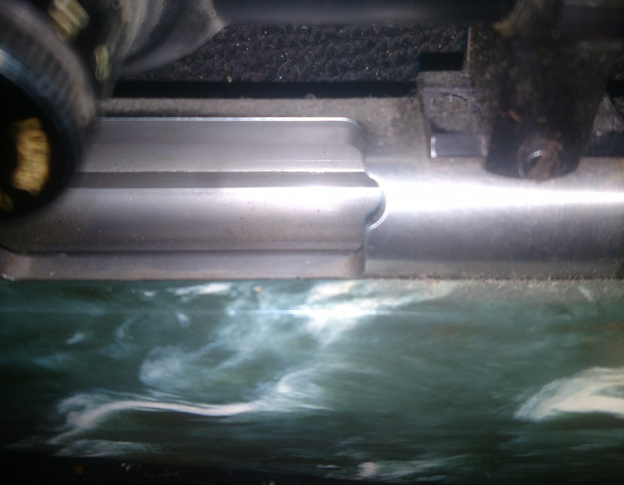

For those wondering what are these guys talking about here are a couple pictures.
The green gun is a Stiller Predator with a very small cutout so loaded rounds don't hit.
The black gun was built by poster Skkeeter and is aTac408 showing the much larger cutout.
