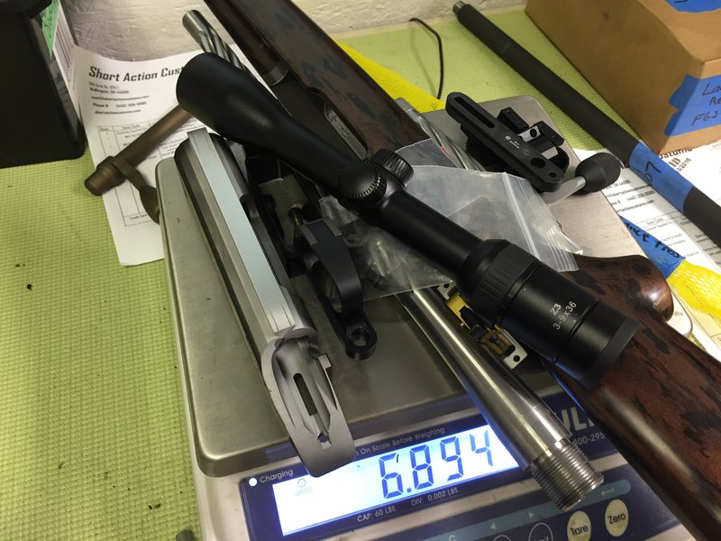

One of the scopes it wore over the years.
[IMG2=JSON]{"data-align":"none","data-size":"full","src":"http:\/\/i642.photobucket.com\/albums\/uu142\/lancetkenyon13\/Customer%20Paint%20Jobs\/20160515_094545_zpsio6uhfgu.jpg"}[/IMG2]

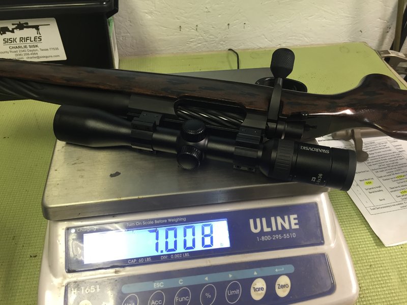

After swapping stock, scope and rings
[IMG2=JSON]{"data-align":"none","data-size":"full","src":"http:\/\/i642.photobucket.com\/albums\/uu142\/lancetkenyon13\/280AI%20Build\/20170612_164611_zpsmyja1qko.jpg"}[/IMG2]
