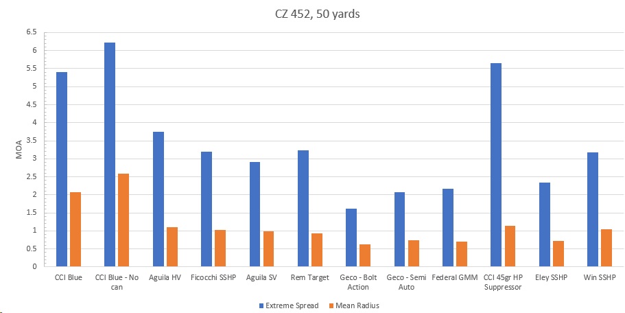

I tested 11 different types of ammo to try and find what the rifle would like. I fired 10 round groups at 50 yards and used Range Buddy to measure each group. For this initial testing I shot off of a front bag with no rear support.
CZ 452, 50 yards, front rest
GroupAmmoExtreme SpreadMean Radius
1CCI Blue5.42.07
2CCI Blue - No can6.222.59
3Aguila HV3.741.11
4Ficocchi SSHP3.21.03
5Aguila SV2.910.99
6Rem Target3.240.93
7Geco - Bolt Action1.620.63
8Geco - Semi Auto2.080.75
9Federal GMM2.170.7
10CCI 45gr HP Suppressor5.661.15
11Eley SSHP2.340.72
12Win SSHP3.181.05

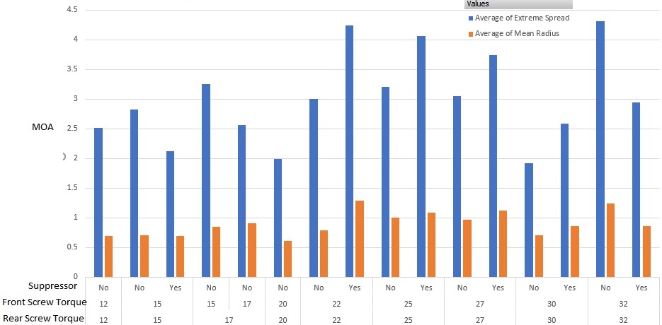

I was pretty surprised, and disappointed, at how poorly the rifle grouped with typical decent ammo. Still, I decided to buy more Geco "Bolt Action" ammo and experiment with action screw torque and also test if the suppressor had any effect. All groups here were shot with a bipod and rear bag.

At this point I'm still pretty disappointed. The best performance seems to be at 20 in-lbs followed by 15 and 30. Overall there was no change from my previous test in the best tightest group. The suppressor typically increases the group size, but not always, and I would probably need to fire multiple groups to confirm that.
So what does this all mean? Do I have a turd of a rifle? Should I re-bed the action in the stock? Should I ditch the stock and put it in something more rigid like a Boyds varmint? I'm cautious about dumping too much money into this thing when I could just go out and buy a T1x or 457 and (probably) have better luck. At least with a new 457 if it has a turd barrel I could replace it easily.
Is there anything else I should be experimenting with? Any other potential causes of bad accuracy? Or am I expecting too much from this thing?

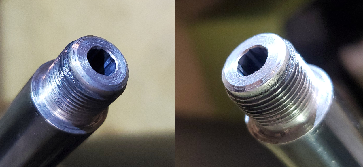

Added edit. Checked the crown?
Understood on the ammo. I'm not expecting match-grade results from sub-par ammo, but I am expecting better than 3MOA.
I'm definitely no expert on crowns but I don't see any obvious problems here. Please tell me if you disagree.

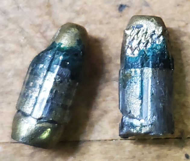

Yes, choke- the diameter of the bore decreases toward the muzzle end. You can google slugging your barrel, which will expose bellmouthing and the tightest spot in the bore. You can also buy pin gauges to insert into the muzzle end, but I would just slug it.
Reactions: Codiekfx400
Thanks, I Googled and learned.
I slugged the bore in both directions.
From the muzzle: tight getting it started and then it almost immediately opened up and was easy to push through. I encountered a slight increase in resistance just before the chamber.
From the chamber: similar experience, but overall easier to get started. I could push it easily until ~ 1 inch before the bore and then it tightened up.
Both slugs pulled out a lot of green/blue wax. I'm assuming this is from the CCI clean ammo I've been shooting. I wonder if that had a negative effect...
Both slugs measured 0.2205 inches
Using a fresh non-plated slug, map the the bore from chamber to muzzle. You don’t want a tight spot near the chamber. You also don’t want the bore loose within three inches of the muzzle. Specifically check if the bore gets loose under that threading at the muzzle. If it is tight right in front of the chamber you might have to lap it a (very) little. The idea is to keep the projectile deformity to a minimum early in the launch and the tightest (more deformity) shortly before the projectile exists the muzzle. You want the projectile stabilized, not ricocheting down the tube. And yes, don’t shoot anymore blue crap coated bullets.

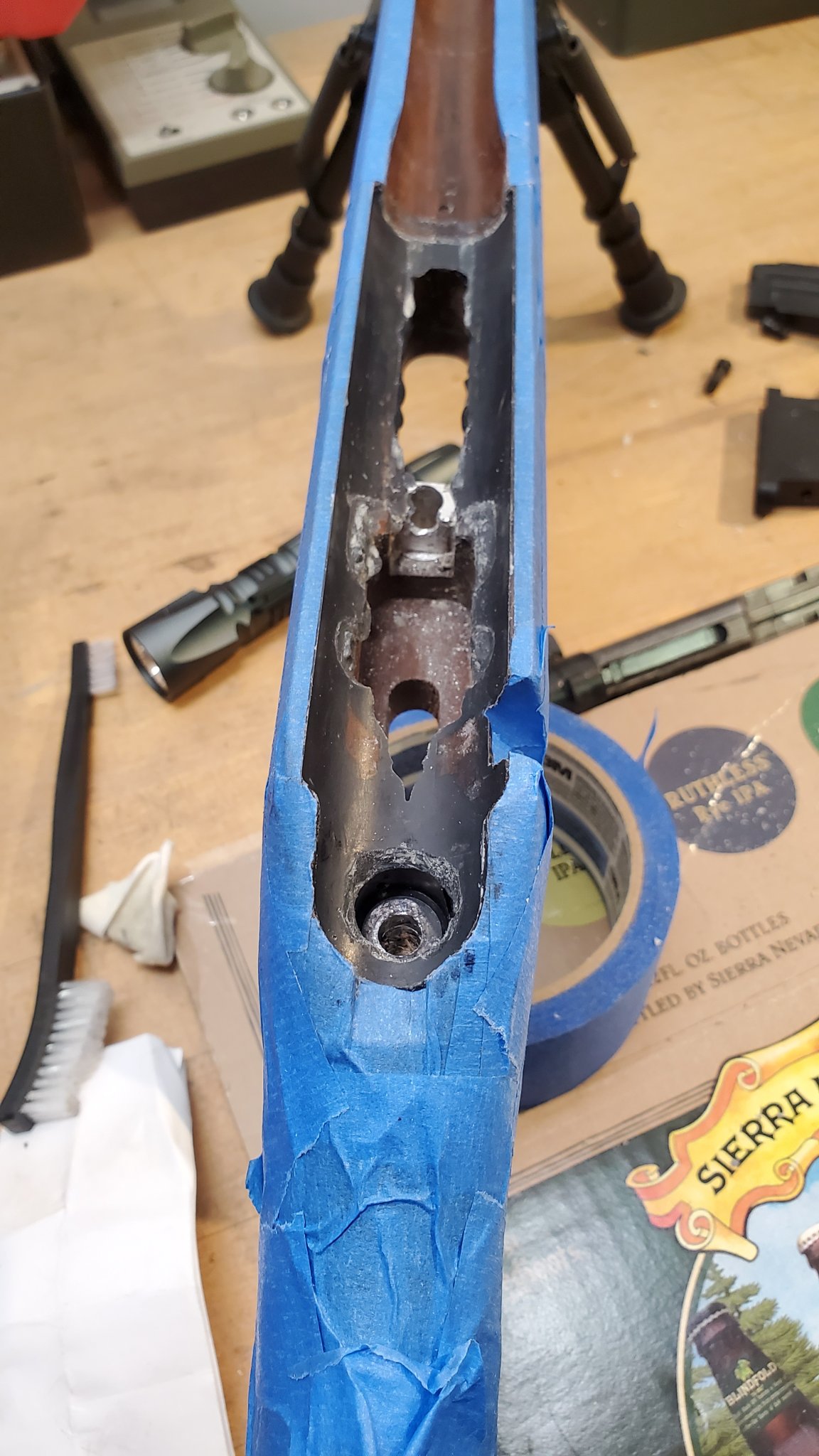

I decided to redo the bedding on the stock. I dremeled out the old stuff and did a much better job this time. Glued the recoil lug in place and bedded that first. Once I had that secured I did the rest of the action/stock:
I was able to retest using the same Geco bolt ammo and I'm now getting 1.75 MOA on the high end and just under 1MOA on the low end. This is indoors at 20 yards. CCI std is pretty meh at 2-2.5 MOA.
Eley SSHP is pretty consistent around 1 MOA. I need to order more as I only have half a box left. I'll also order some other Eley varieties to see how they do.
I think I'll keep the rifle and leave it alone other than getting a scope with adjustable paralax. Its been hard has hell shooting half decent groups with fixed 100yd paralax. Its plenty accurate to plink with and pop squirrels.
