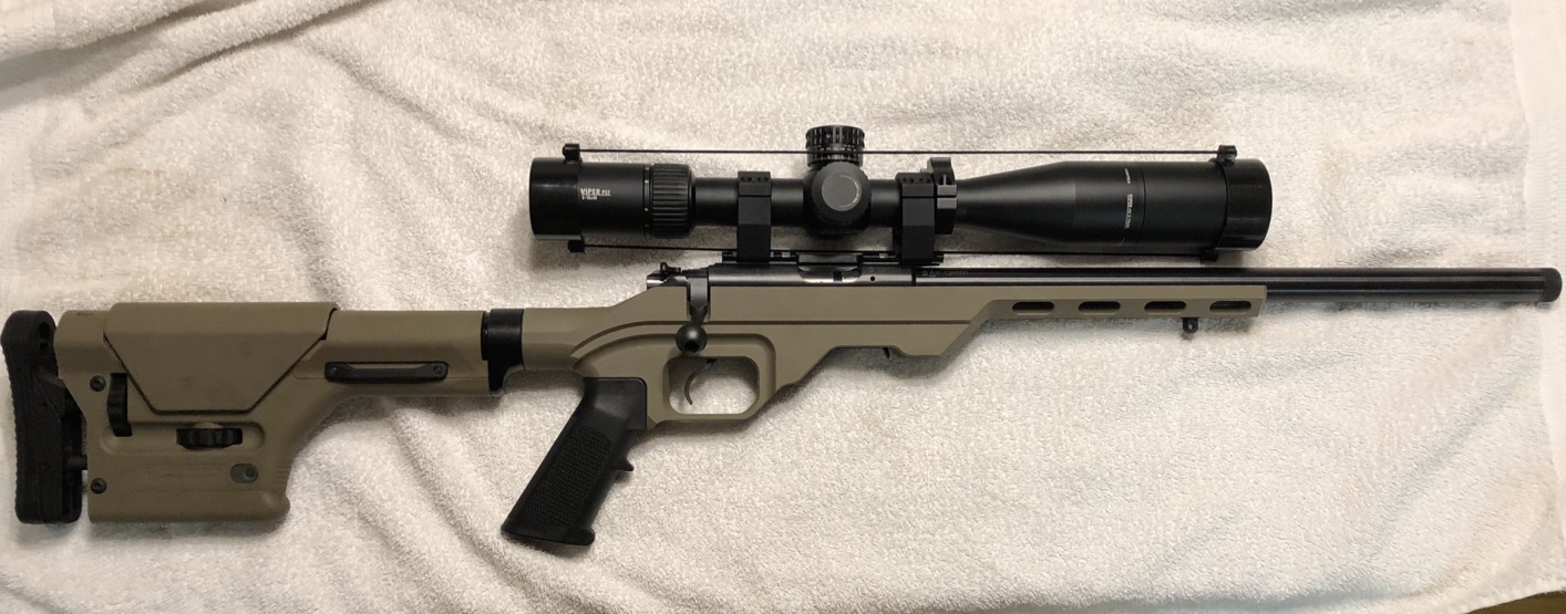

MDT still offers their LSS Gen2 chassis for the 455. Its everyday price is $430... but you still have to put a buttstock on it, which adds to the price. I had my 455 in an earlier version of the LSS chassis and used a Magpul PRS stock I had (photo).

I have my 455 sitting in an Oryx chassis. The only gripe I have is having to take off the cheek rest to clean it. I know I could buy another cleaning rod to alleviate that problem but am tired of having to do that all the time so I just take the rest off.
