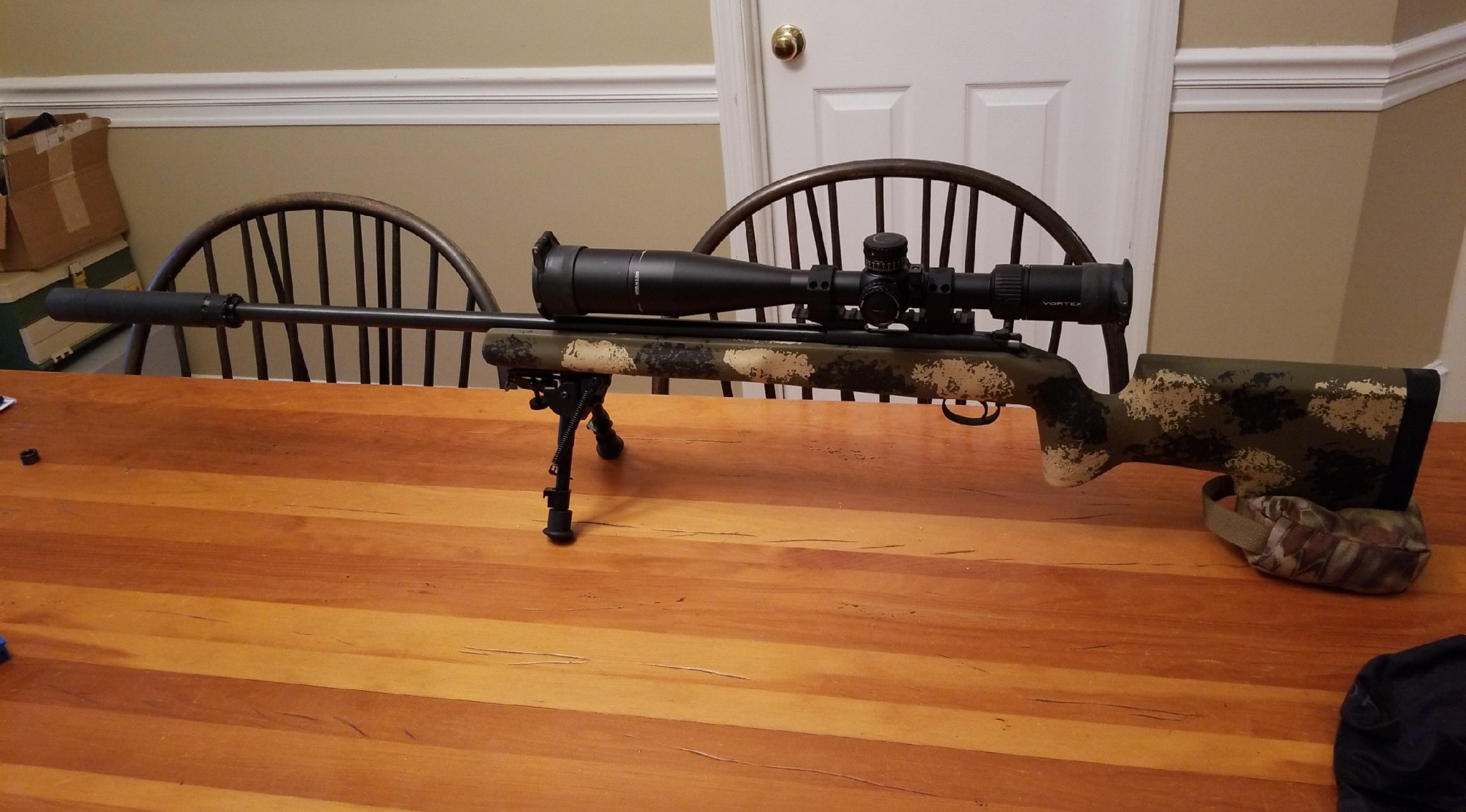

Newbie to posting on the forum so please excuse any breeches in decorum. I have been looking for a way to introduce my grandkids to competitive shooting but also scratch my PRS/NRL itch via NRL22. I am a short gun guy for the most part so competition with a long gun is relatively new for me. Anyway, I bought a CZ455 with the intent of getting DJ to build out a tack driver for me. After the purchase I saw that he had gone into retirement and the idea died on the vine. A while later I saw he was back and contacted him only to find out he has back into retirement. Fully understand and wish him well. That left me with a CZ455 PT and a lack of satisfaction with how it shoots. I am used to being the weak link in competition …. not my kit. After research on the internet, a few books, product research and much thought, I see no reason that a reasonably handy person could not get 80% of the accuracy that Don provides. I leave that last 20% as the exclusive domain of his magic pixie dust. Those percentages are somewhat arbitrary but the point being I can do quite a few things towards making this more accurate. Granted this may be total ignorance on my part, but here we go.
My intent is to build out my CZ455 PT and document it within this thread, hoping that Don and others may offer advice and constructive criticism along the way.
Build Spec:
CZ455 action
Manners T4 Stock
Lilja drop in 16" threaded barrel (.900 no taper)
Trigger Spring Kit
Pillar Bed
Glass Bed
Firing pin shaping
Area 419 30 moa scope rail
Vortex Viper PST Gen 2
Bipod
Updated swivel cups
Joe Ducos stock cheek piece upgrade
Anarchy Outdoors swept bolt and upgraded knob
Anarchy Outdoors bottom metal
Extended mag latch
Rugged Obsidian can w/custom 22 caliber end cap
and I am sure other things along the way ....
The picture below is my starting point after purchase and about 100 rounds through the original barrel.
7067004

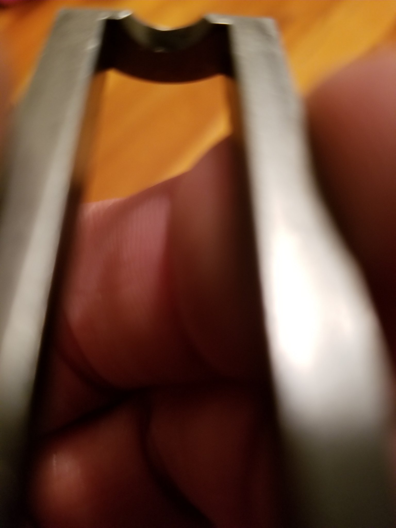

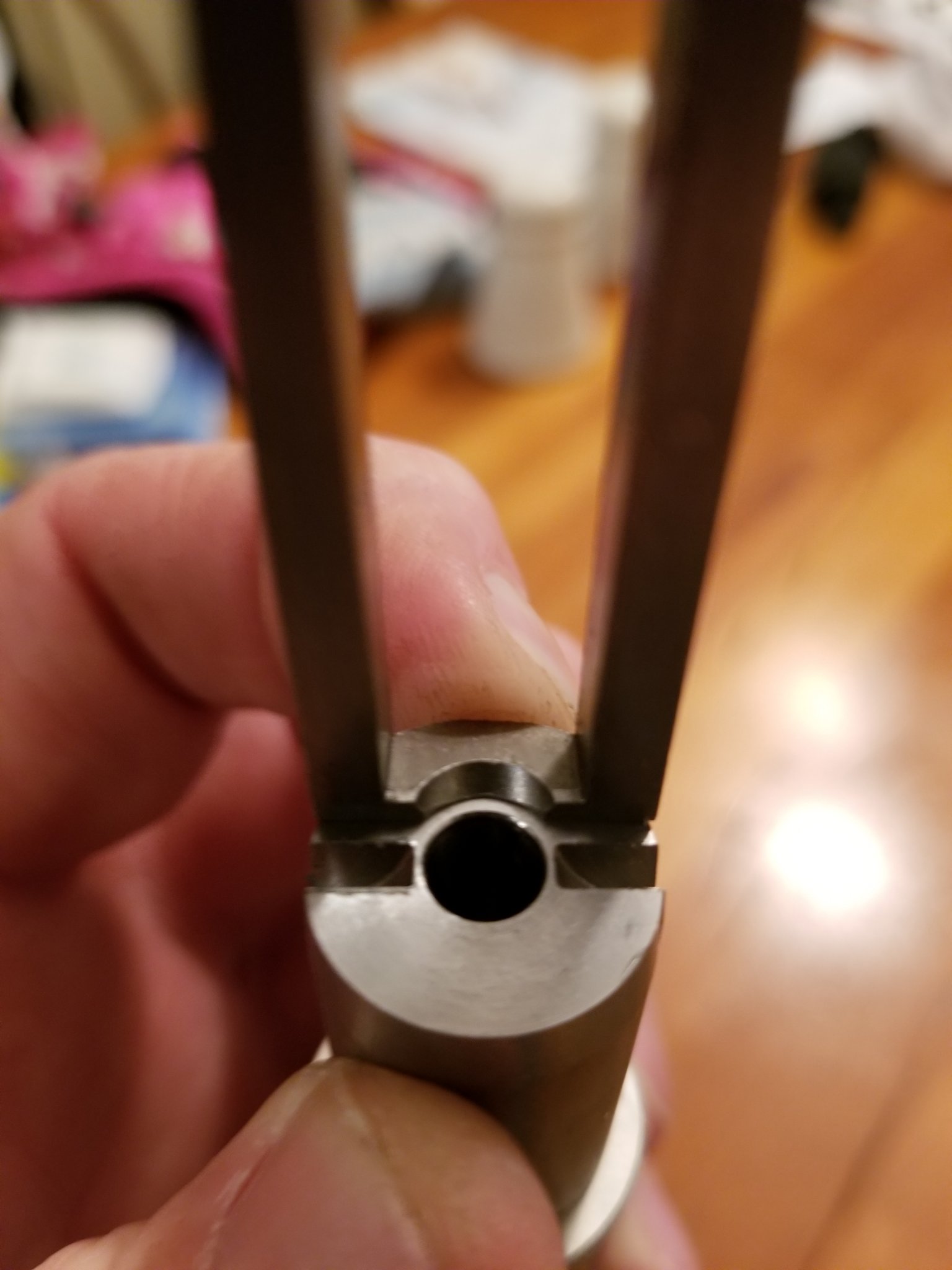

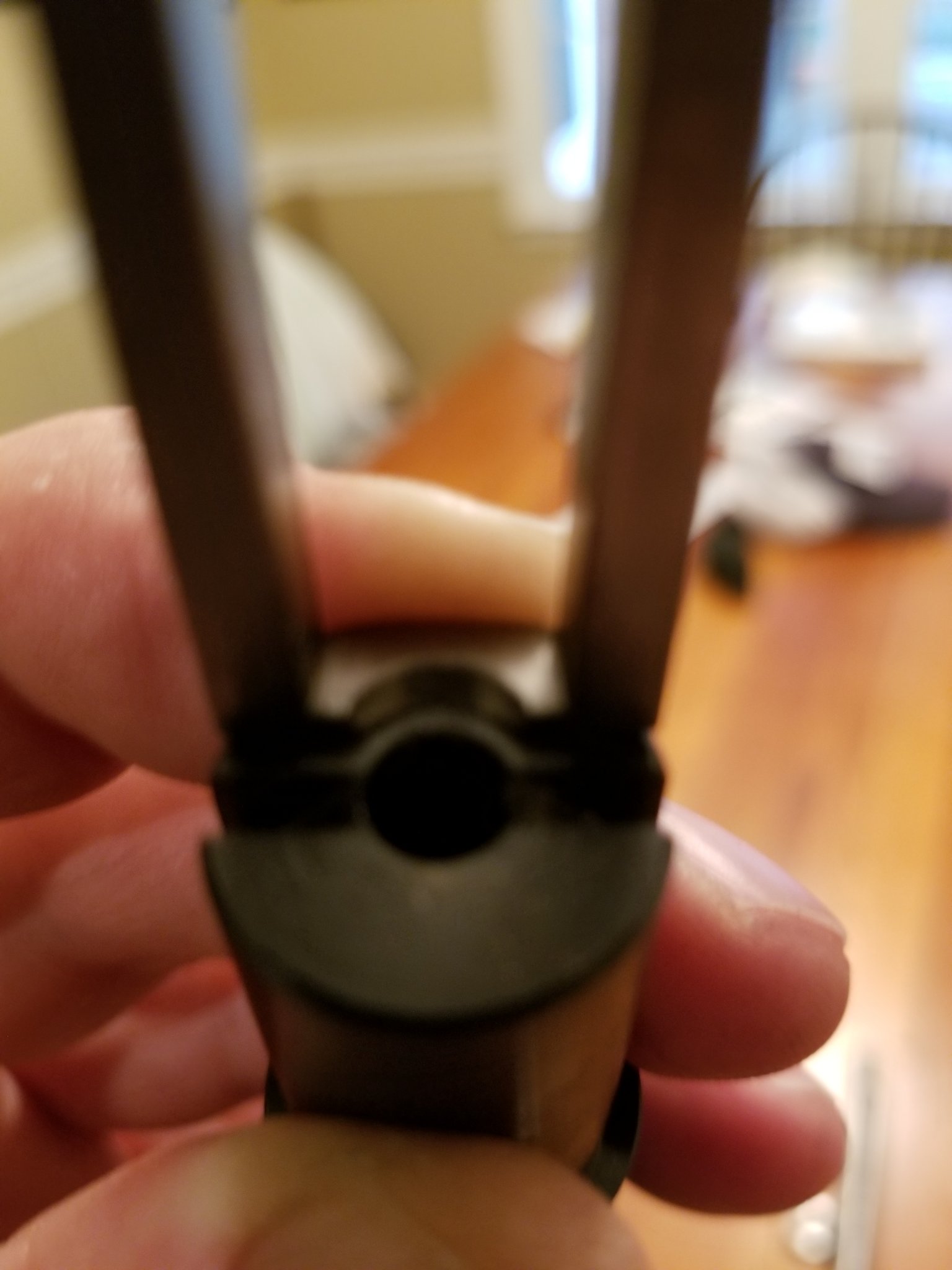

I then started looking at how the two barrels, old and new, compared. Setting the bolt guide in place against the barrel, it looks like there is quite a-bit of "wall" between the ramp and chamber. So much that it makes me believe that may not be a functional feed ramp or be something else. It was more pronounced on the Lilja, but pretty close to the same on the stock barrel. Am I misinterpreting the purpose of the inleted area?
7067588
7067590
Proper chamber job has a chamfer cut into the chamber mouth to assist in feeding from a mag
