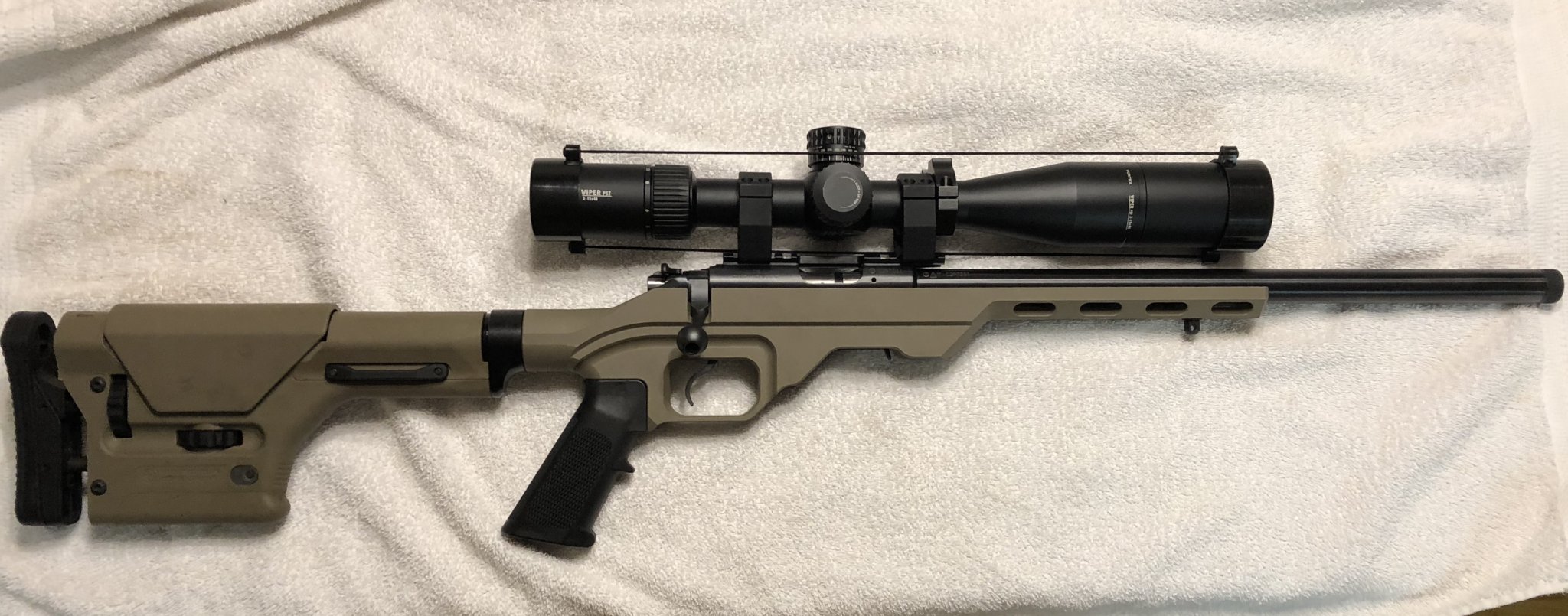

I'm surprised you haven't received a response to this... welcome to SH. I don't know how high the Area 419 rail is, but I can tell you that my 455 outfitted with a DIP 20MOA rail needs the 1.26" Vortex PMR rings on my Viper PST 3-15x44 (30mm tube) in order for the bolt to clear the scope. The DIP rail is very thin (but it works, and it hasn't shifted in the year and couple of thousand rounds fired). Perhaps shorter rings would work, but I'm skeptical.
