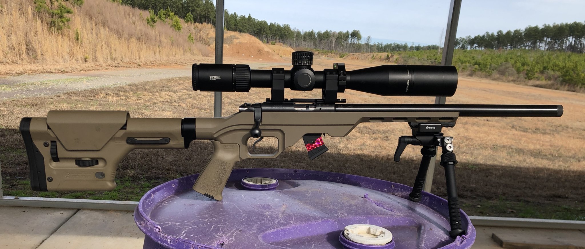

I had a 455 in an MDT LSS-22 chassis with a Magpul PRS buttstock attached. It functioned fine. other than bolt pulling out if I put the wrong Yo-Dave shim/spring set in the trigger and made the pull too light. With the 457 being such a huge improvement over the 455, I'd have a hard time spending much money on a 455.

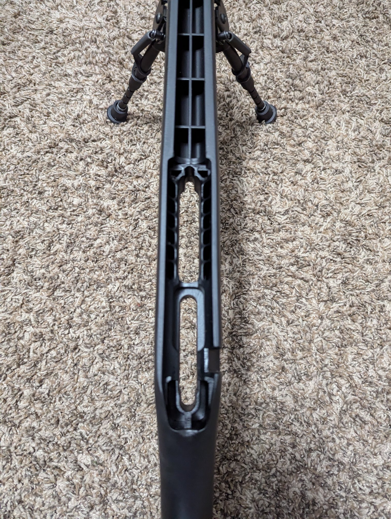

Any suggestions for how to free float the barrel? I'm considering a kit from Pete's Pillars and glass bedding the stock. It seems no one else has documented the task with the factory synthetic stock. Perhaps I'm the first person foolish enough to try.
You're prob. gonna have to reinforce the forend to keep it from flexing when you load up on a bipod. We used to bed in an aluminum rod in the forend cavity. Honestly, it's more work than that plastic stock deserves.

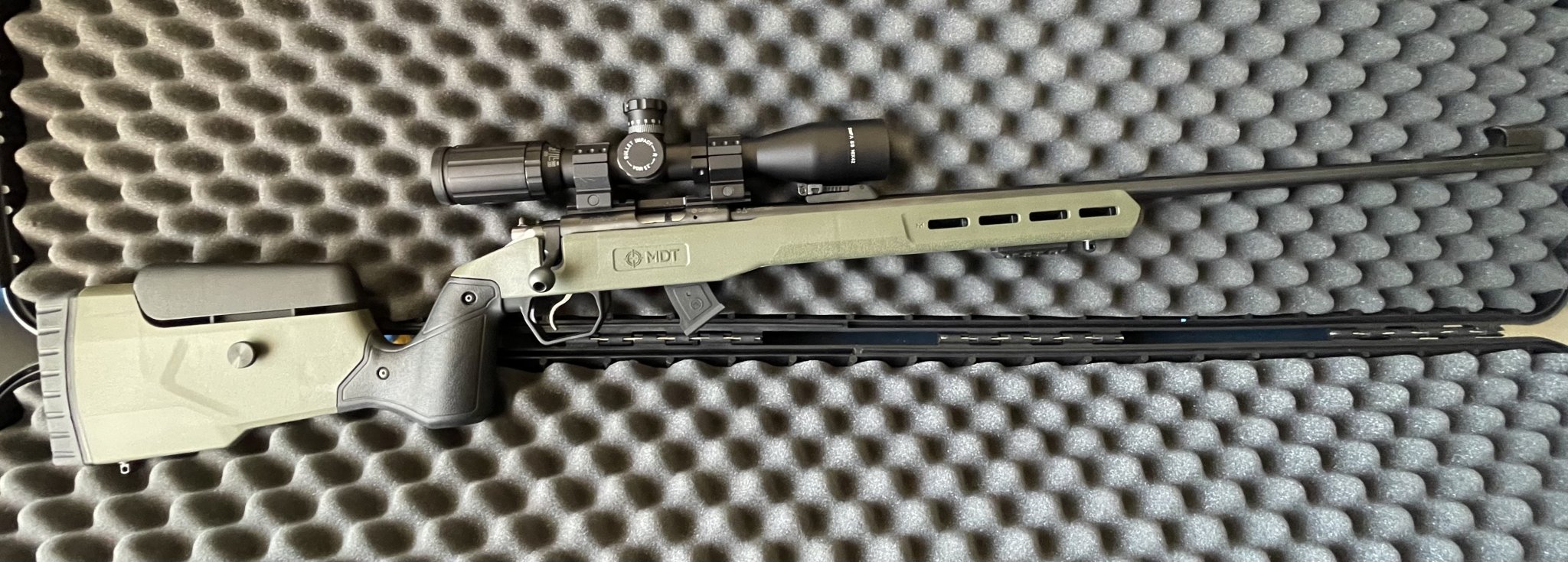

Updating this old thread. Long story short, I ordered MDT's Field Stock for my son's 455 during the Black Friday sale. I just put the rifle into the stock and tried it out a couple of days ago.
I like it. A lot. Rifle (originally a 27" Ultra-Luxe) shoots very well with a variety of ammo SKUs. Not quite as well as my Bartlein-barreled Vudoo at 50 yards, but as well as my Shilen-barreled Rim-X. It didn't do that well in its original stock.IMG_4516.jpeg

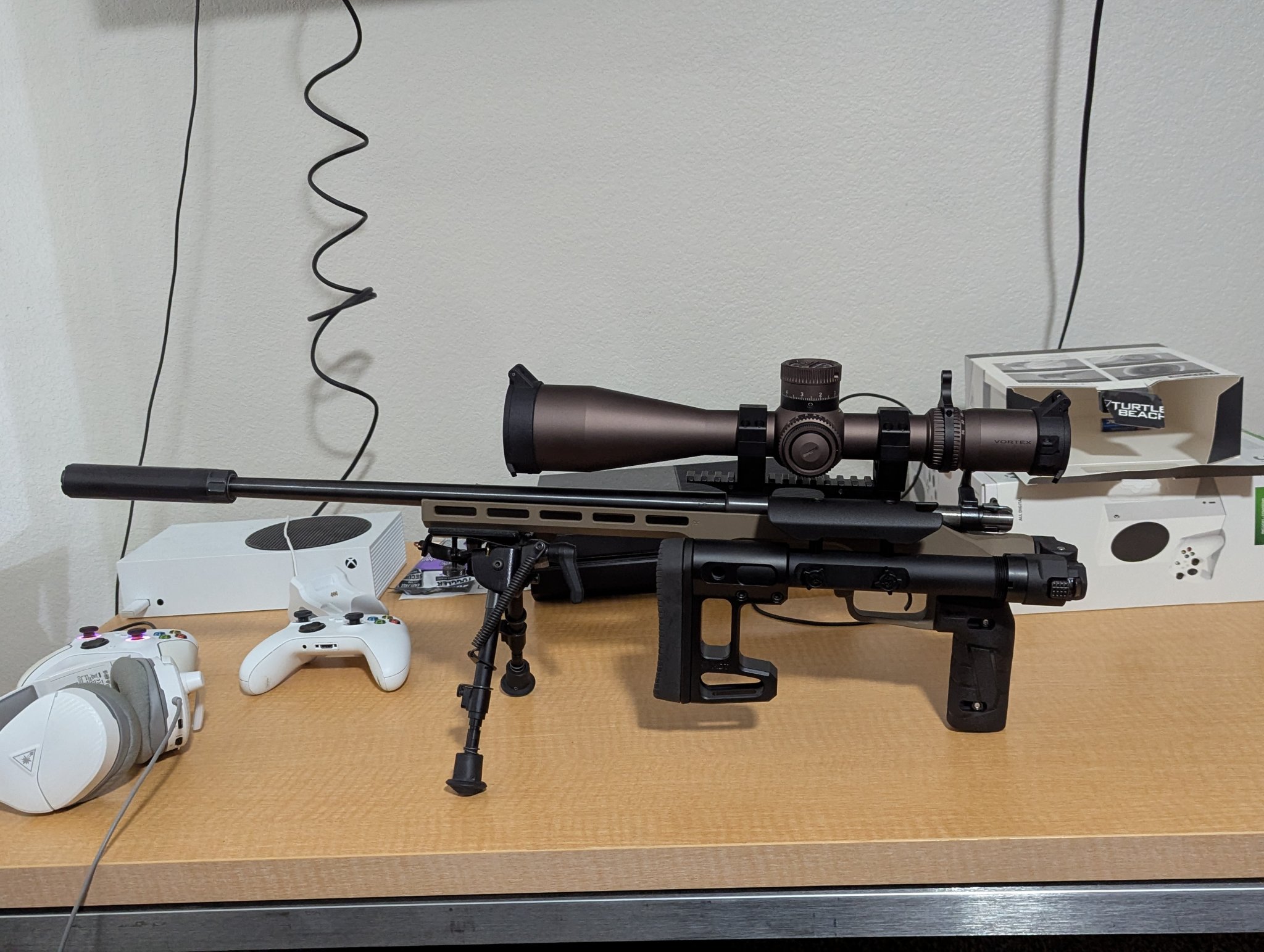

I also took advantage of the Black Friday deals. Here is my 455 in the LSS chassis and SCS lite buttstock with folding adapter.
