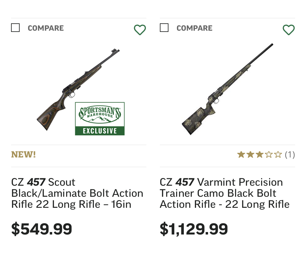

Could I have one sent to the Casper, Wy Sportmens Warehouse?
To respond somewhat more expansively, they may or may not be willing to handle private FFL transfers, you’d have to call them. I also don’t know if they’re willing to ship firearms internally if they have one in stock elsewhere, seems some chains will and some won’t (maybe I’m just thinking of ammo here).
Reactions: Jdaniel344
These are in stock in Casper. Might be able to get some of the other ones sent there. At least with the scout you good get a new barrel and chassis it up. The VPT version of the 455 I have is nice, but you’d better like the stock, that’s where the money is in it. Bud’s has some too.
Reactions: KnowNothing256
Thanks, I'd didnt see CZ there but I didnt ask either.
I’d call first. I have a sneaking suspicion that these are in there system somewhere and maybe not at a specific store, but at least you can get it with out paying for shipping and a transfer-fee/BGC. I think they said the same models were in stock here in CO…. Plus, I never trust online inventory numbers, Home Depot’s online inventory is a joke.
