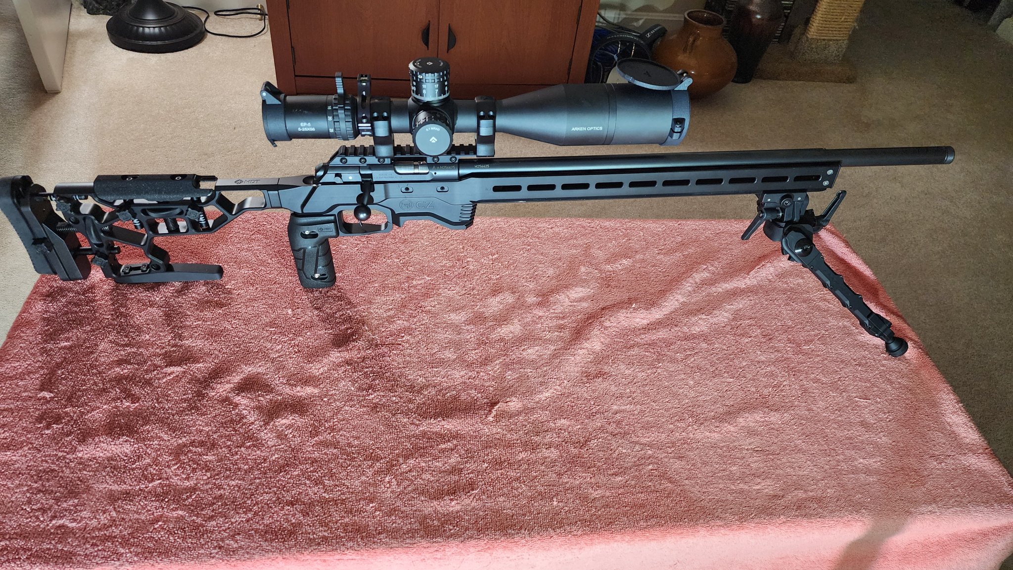

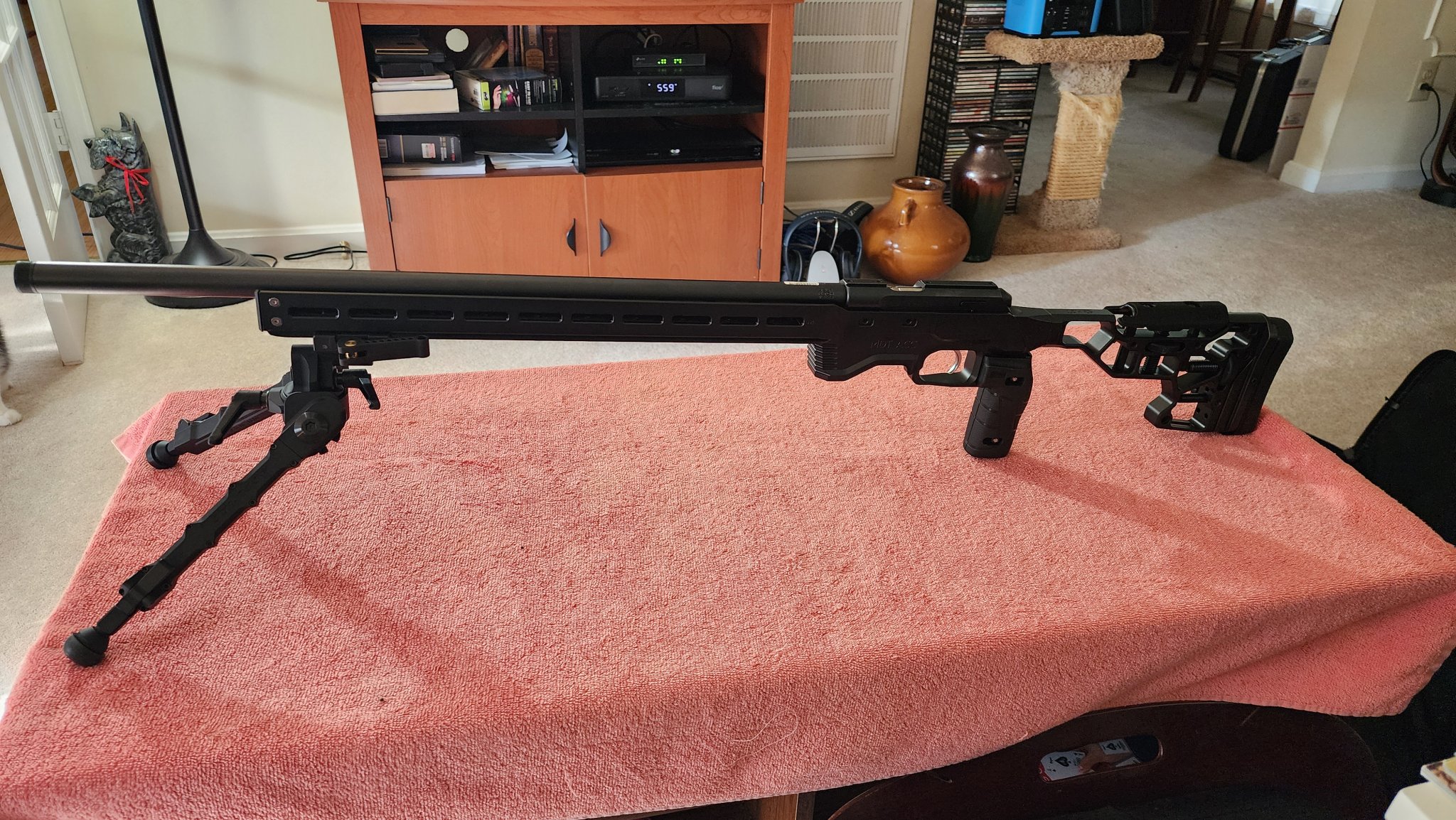

I just got a CZ 457 MDT Chassis and as mentioned earlier, it only came with one 5rd steel magazine.
Will top with Area 419 30 MOA rail (if it ever gets here) and an ARKEN EP-5 to start with and test my skills.

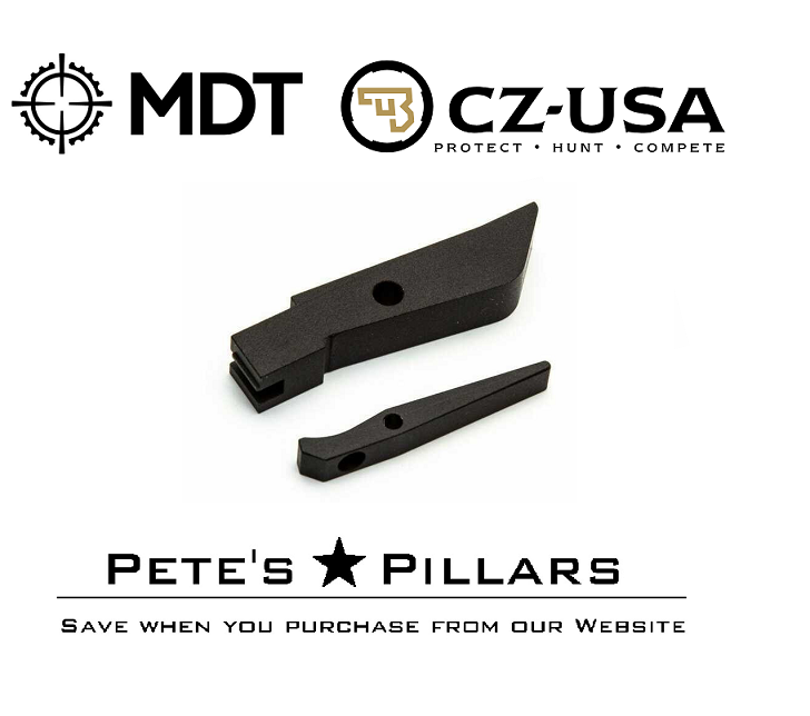

I'd like to purchase additional magazines and the L3I aluminum magazines look very good.
My question is: Will these work well with the MDT Chassis, and should I also buy an extended latch? (L3CZ-LTCH)
I have been shooting a Ruger Precision RF in .22LR and finally decided, after adding a Shaw 20 in barrel and a Timney 649 Trigger, that I should have probably spent more $$ up front and gone with a CZ, B14, Vudoo or RimX to begin with. (The Vudoo and RimX were and, most likely still are, a bit out of my price range, but .....) I want to see how I do with the CZ.
Really appreciate any and all suggestions as I get started with this new rifle.

Oh, for clarification, I was asking about the L3I 13 round magazine, part number L3CZ-13.

everything I've seen says you should be good to go with the l3i 13 round magazine. they seem like the best for us, plus they sponsor my local range. the mag release is personal preference and I don't have that stock so I don't know if it's easy to access as is.

Thanks Cody! Great to hear it's a company that supports your local range. The mag well seems roomy enough, but since I don't have the 10 rd mags and I haven't shot it (no rail yet) I don't know how well it will work. I think I'll order a couple and see!

The L3i work fine on the ACC, but the longer mags do make it harder to get to the mag release (extended release only helps so much). That's why a lot of people notch the magwell or increase the opening size to make it easier to get to. The Gen 2 ACC has this build in for the CZ, but the Gen 1 didn't.
Womfat shows it in his video comparing the two chassis.

I highly recommend an extended mag latch of some sort. I like the rounded paddle style from Anarchy, but my MDT one works great too. L3i is a great company - I wouldn’t hesitate to support them either.
