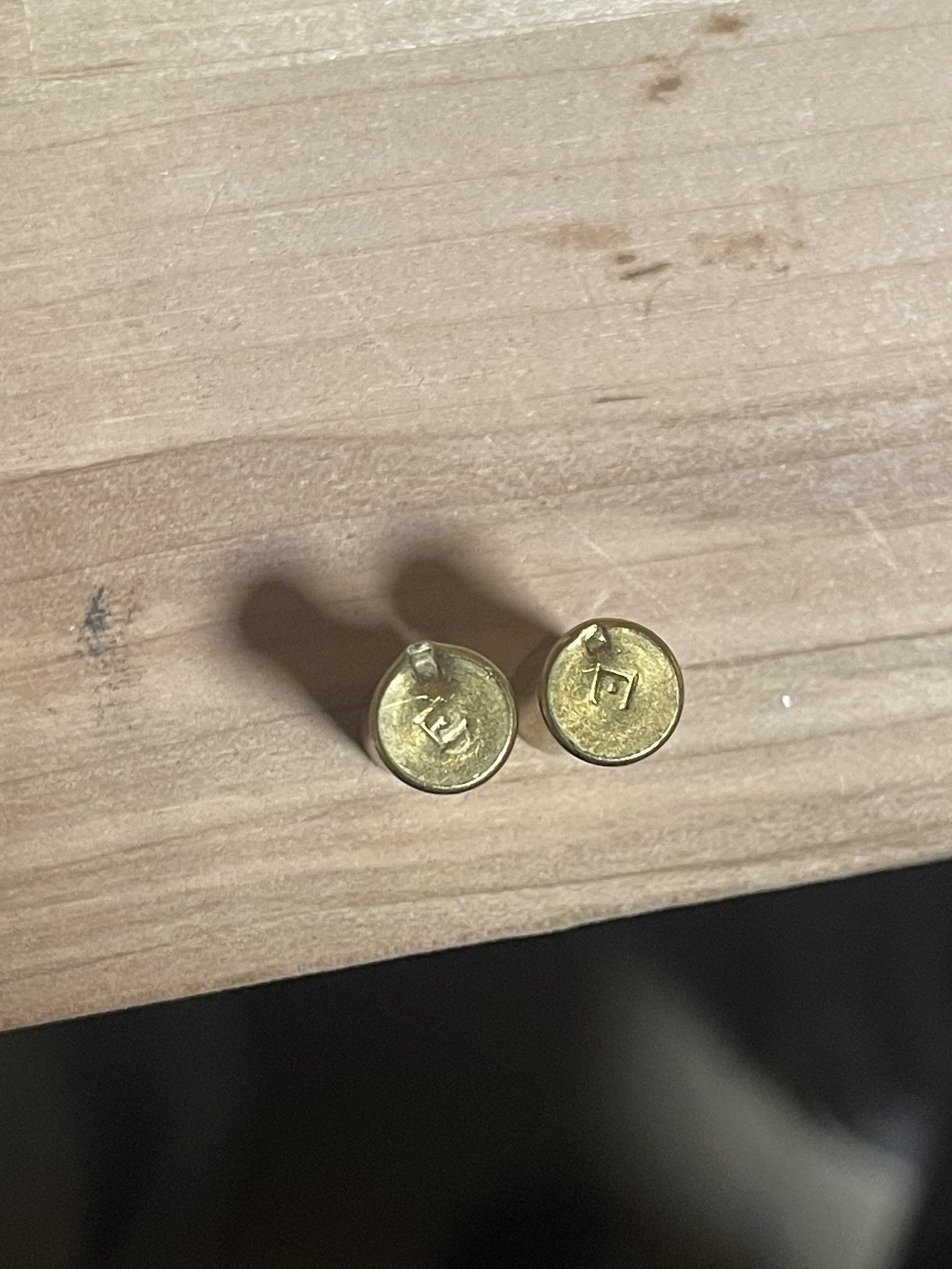

Well I fixed my problem. Just thought I’d throw out my solution for anyone who may ever have this happen. So the firing pin was smashing the rim and wedging it so tight the extractors wernt able to hold on the the rim for extraction.
I took a drimmel file and sized down the firing pin to the point where it was only leaving a small pin head indention on the round. Now I get perfect extraction.
In the photo you can see the shell with the stock firing pin and the one on the right is with the modified firing pin.
Wow damaged the firing pin. Follow the Lilja instructions and use the gauge instead of following the BS found on YT videos. The instruction also tell you to clean the chamber. Did the pin dent on barrle flange?

Too late I guess, but I wonder what a ‘lighter’ whack of the firing pin on the case rim would do to MV? Don’t some 22lr actions use two firing pins and big ones at that to ensure consistent ignition and repeatable firing?
This is an older thread but since I was looking at this issue on my new Lilja 1 inch barrel, thought I would read the thread. I too was having extraction issues and head space wasn't the issue. I forgot about it for a time as I decided to do the firing pin mod for more consistent ignition. Interesting to me was the more focused imprint on the rims after the mid and a small improvement in SD on the chrono. But I also had no failure to extract so maybe there is something to this. I only had trouble with Eley Tenex and Wolf Match. No issues with SK or Lapua.
