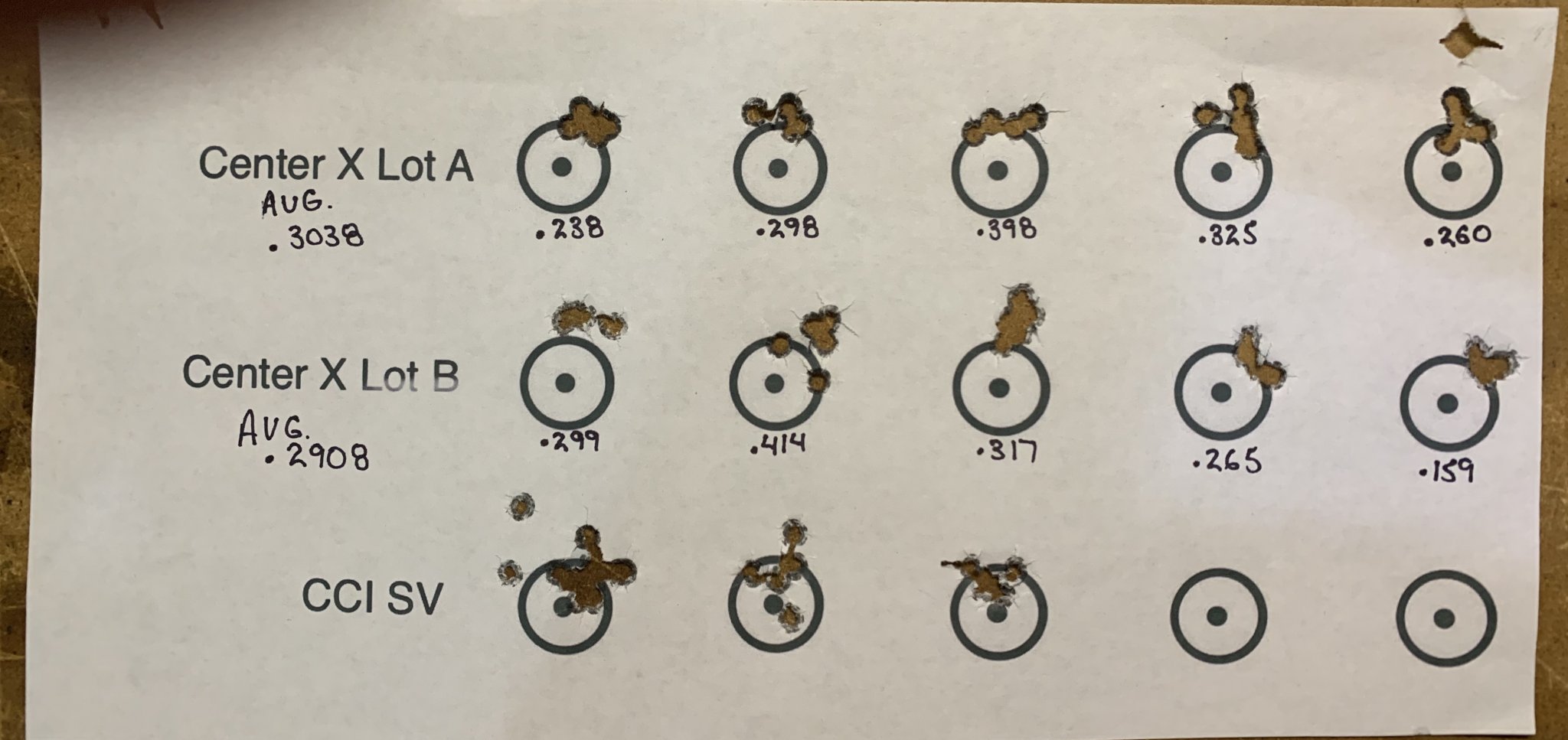

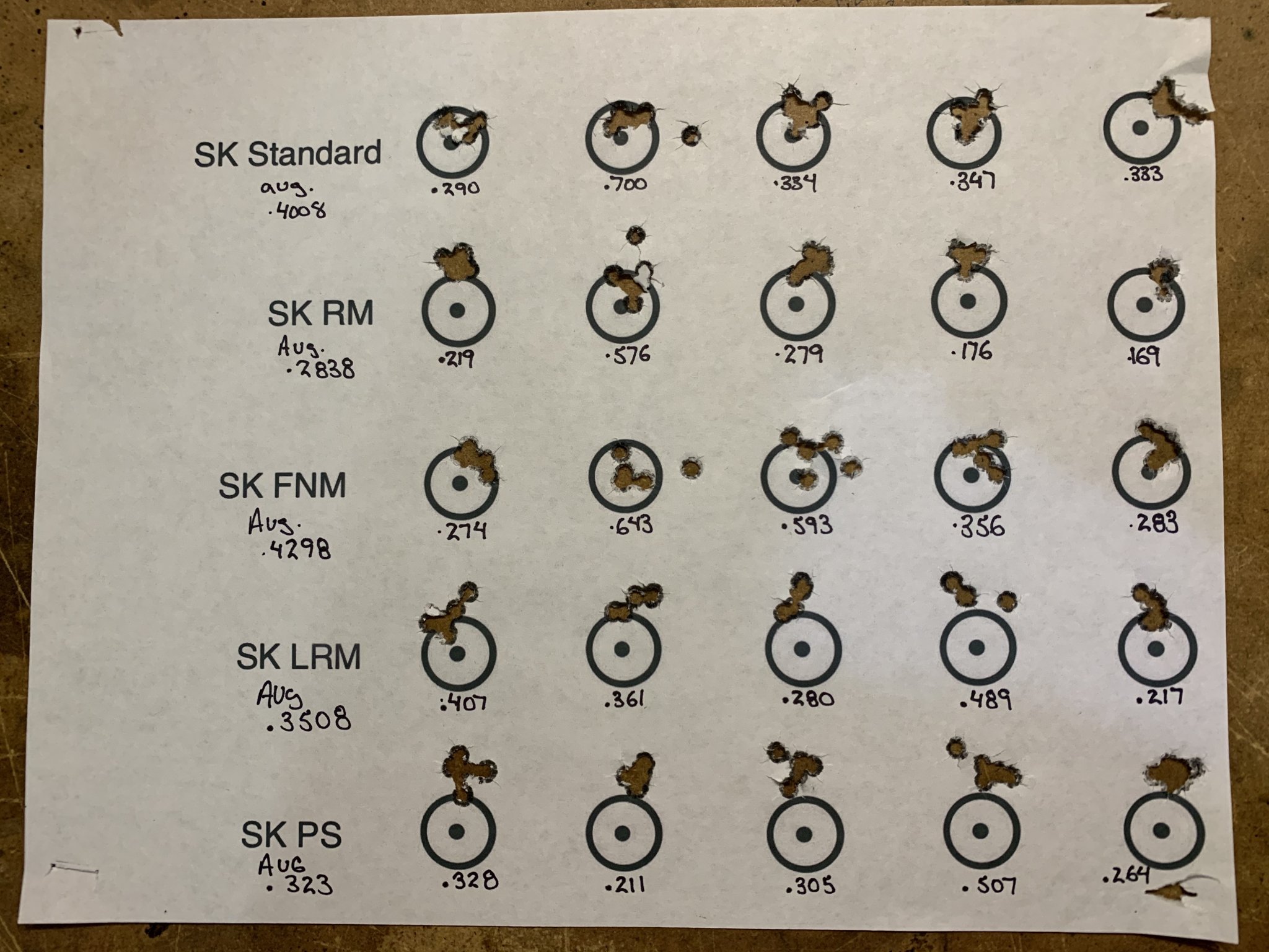

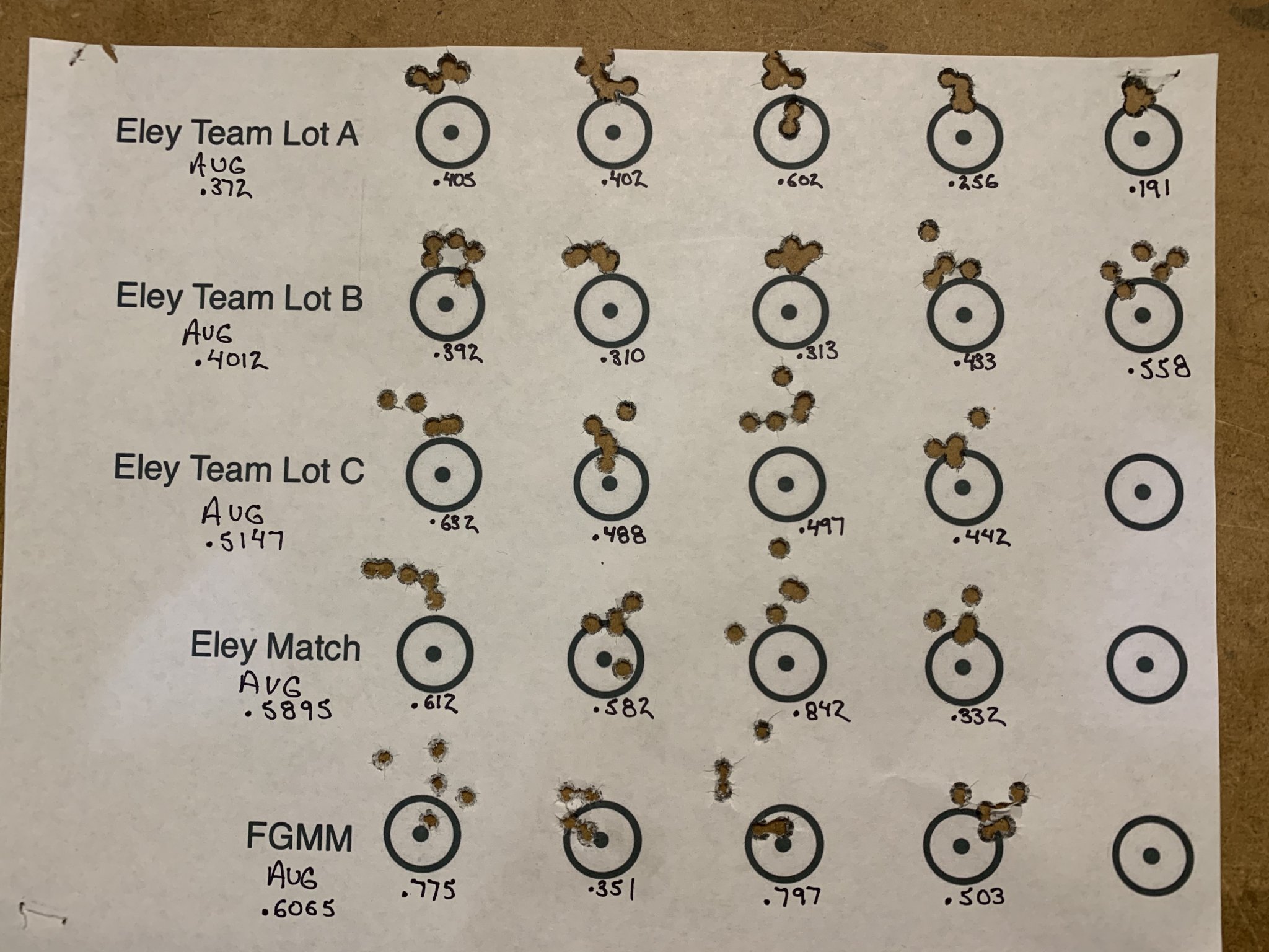

With the right ammo and headspace the Lilja barrel has the ability to shoot good groups. I’ve posted these results before but here you go.
these are 50 yards groups with bipod and rear bag.
