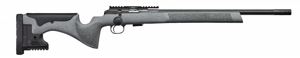

    Built for shooters who want to exploit the extraordinary accuracy potential of the CZ 457 to its fullest, the LRP is tuned to enable hits on target at extreme distances – assuming the shooter does their part!
    Equipped with a 20” fluted varmint barrel, the LRP borrows the MATCH chamber that was originally exclusive to the 457 MTR. This supremely-accurate barrel has a threaded muzzle (1/2x20 UNF) and is topped off with a muzzle brake.
    The LRP’s target-style stock bears a soft-touch finish and has a prominent pistol grip, extended forend, textured grip surfaces and a prominent rear hook designed to cradle the shooter’s support hand. For those desiring to add a rear monopod, a rail is also present at the toe.
    Adjustability abounds, with length of pull able to be tuned with the three included spacers (351-382 mm), while the height of the comb and the buttpad are also user-configurable.
    Also included in the LRP package is a 25 MOA Weaver-style rail (with built-in inclination that enables sighting in at longer distances), an oversized bolt knob, 5-round magazine and a premium 4M rifle case.

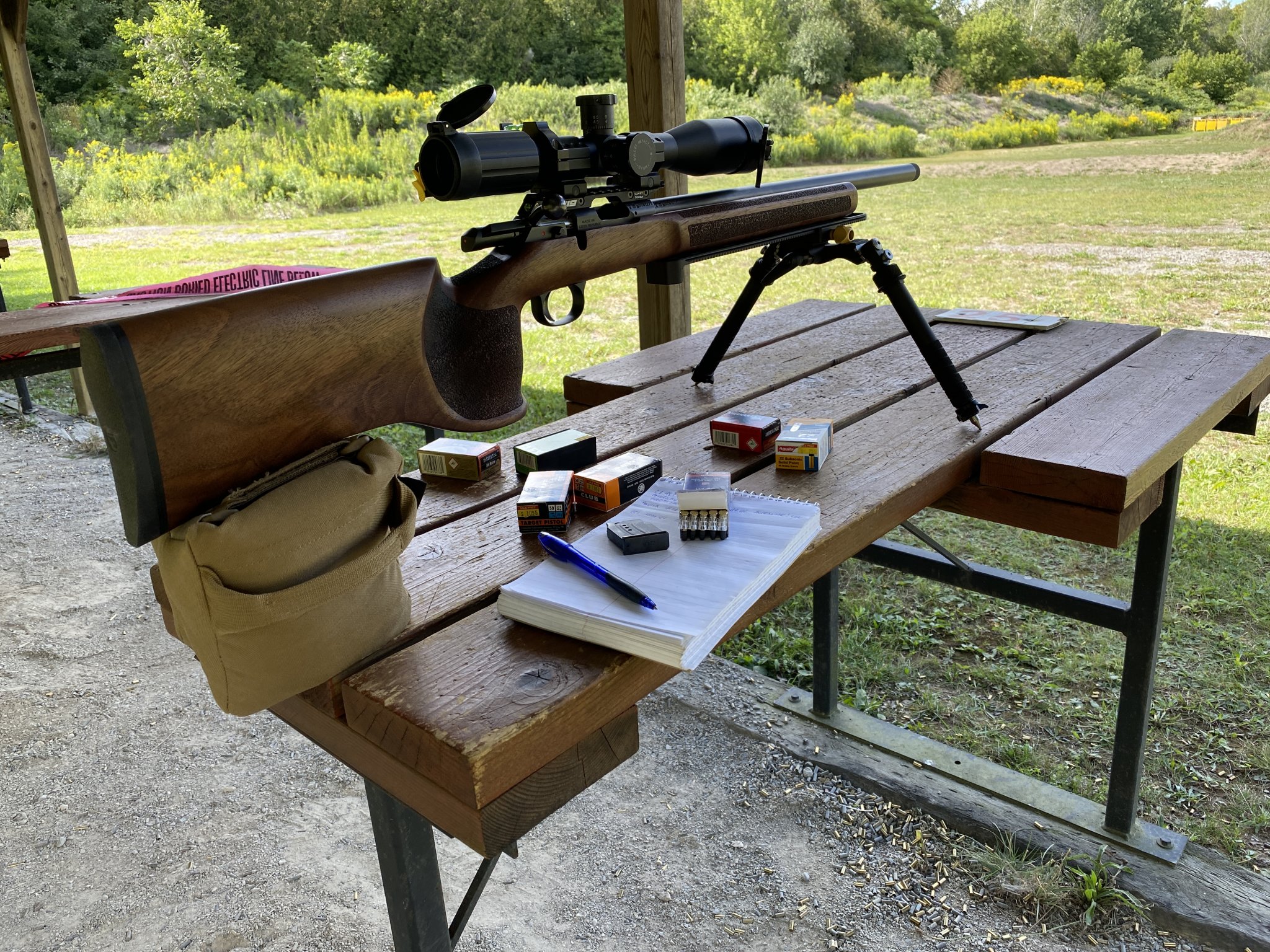

    I bought an MTR in June as my first precision rifle. I've been to the range nearly every weekend since, and I am loving both the rifle and the experience. Great fun!
    Indeed! Area419 30 MOA base will be here tomorrow and I'll hit the range this weekend. I've got a variety of ammo to try out and some other samples on order. What ammo is your MTR favoring?

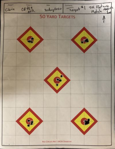

    As I said earlier, I am new to this precision shooting thing, so I consider most of my experience up to this point to be learning. I’m finally starting to get a bit more confident with my abilities, so beginning this past weekend, I’m starting to test ammo in as an objective method as possible.
    I created 50-yard targets with five bullseyes on a sheet of 8½” x 11” paper. The intent is to shoot five shots per bullseye, all with the same ammo. I photograph each target and use the Ballistic-X app to measure the group size. Finally, I calculate the average group size and standard deviation for the five 5-shot groups.

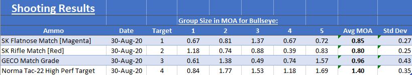

    I’ve been working on this past weekend’s results tonight:

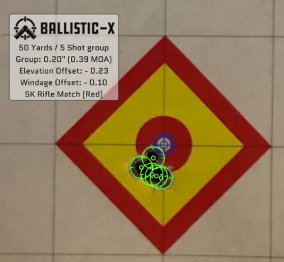

    Here is an example of a target and also of the Ballistic-X app group-size measurement.
    So anyway, in answer to your question, I’ve gotten good results from most of the mid-to-higher-end target ammo I’ve shot. (I’ve yet to break into the Lapua stuff and the Eley Tenex.) The only target ammo I’ve been disappointed in is Federal Premium Gold Medal Target. Conversely, I’d gotten very good results from Federal Premium Gold Medal Match, which isn’t (or wasn’t at the time) terribly expensive. I apparently bought the FPGM Target thinking I was getting the same thing. But no. And not only does it not group well, but my 457 won’t eject it! I had no such problems with the FPGM Match. Go figure.

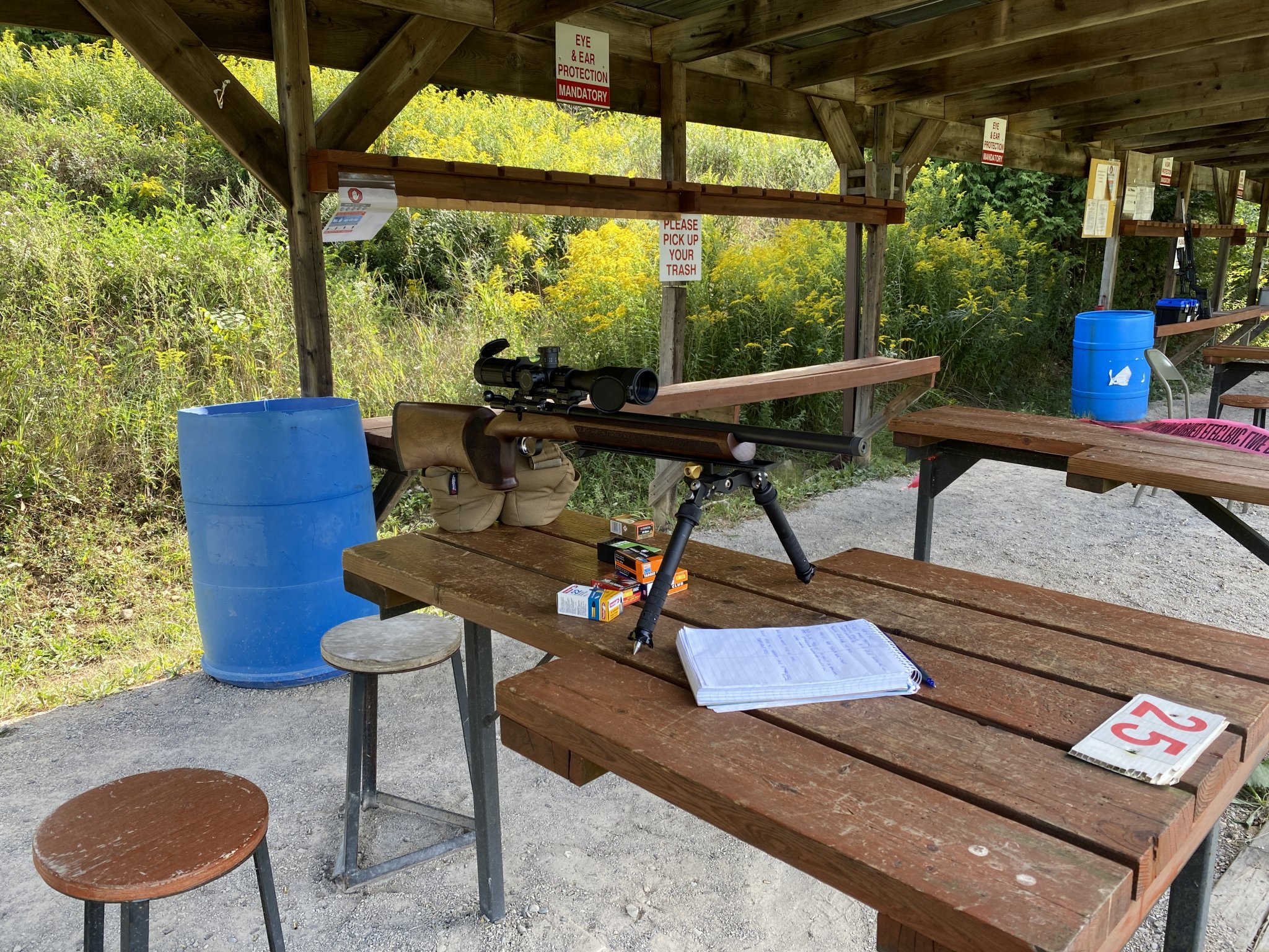

    I’m headed back out today to try some more. Seemingly, the gun didn’t like the Aguila SV.
    I have RWS Club and RWS Pistol Match to try too. Those two are the most expensive of what I bought. I did not opt for the $35.99cad/50 Federal Gold Medal Ultra Match because I just didn’t want to know that’s what it likes best.
