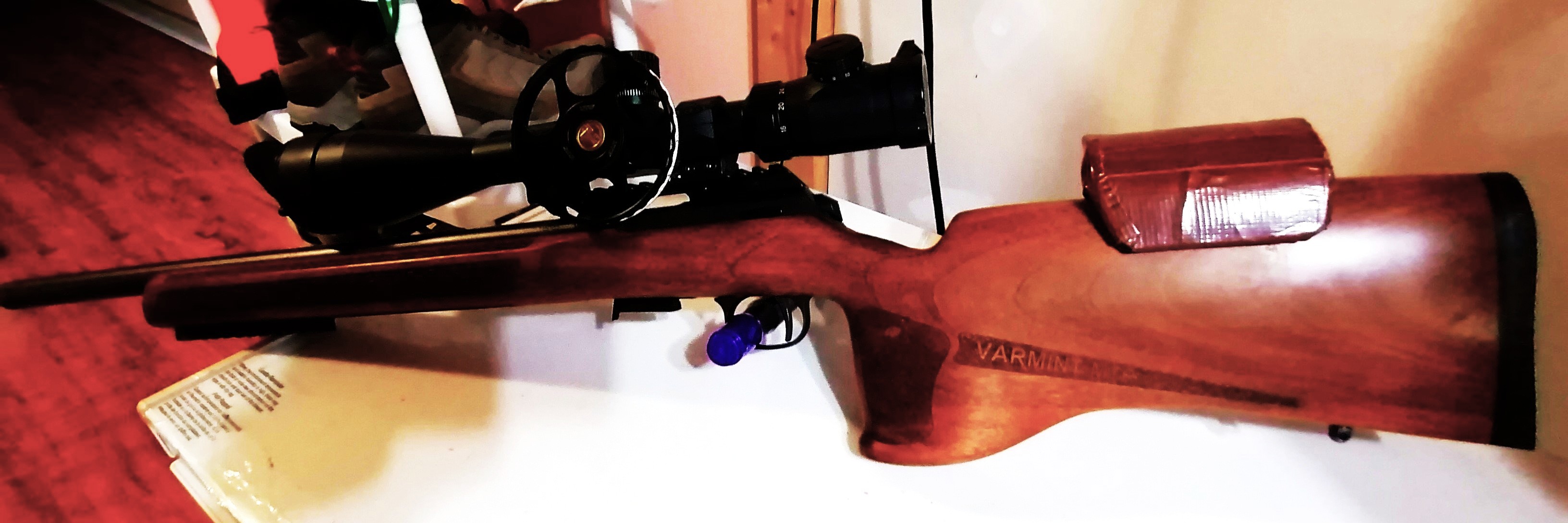

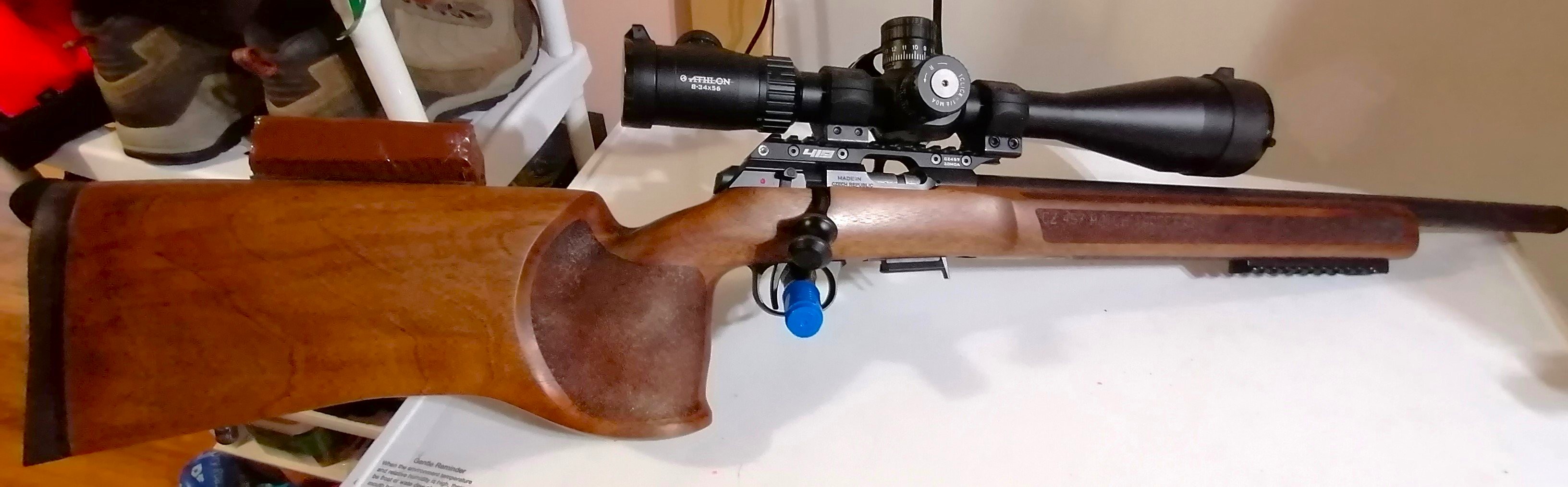

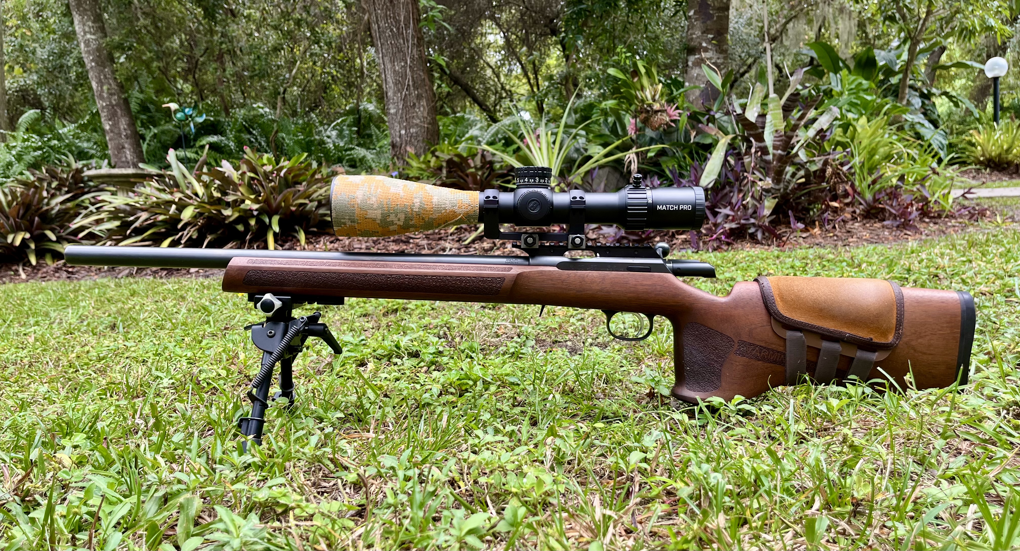

I have the VMTR in wood stock with the 30moa 419-rail and the scope (Athlon Argos 8-34x 56 FFP) I have only had 44-MOA Total adj, so I was unable to zero at 50. I had to get Burris XTR rings to 'take-off' 10 MOA to get that 'close' zero. Cheaper than changing scopes but it left me pretty high for a chin-weld. The alternative is removing the rail and using regular rings - maybe someday? I've made a cheek-rest with a foam mouse-pad and brown duck tape, held on with Alien Tape ! Looks 'almost real' but lets the wood show well.
