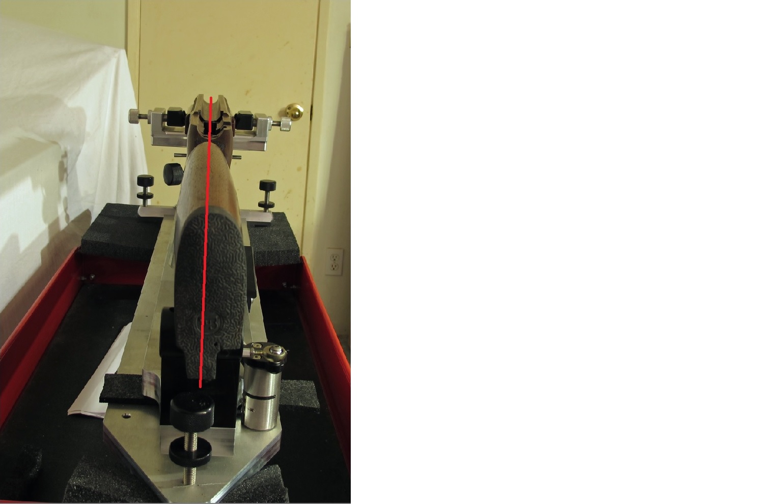

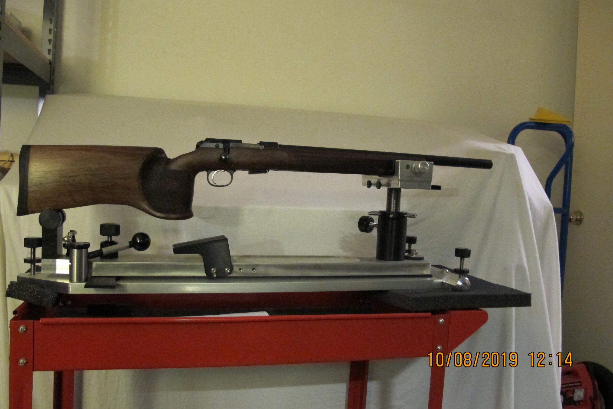

Before and after pics of my CZ 457 MTR stock. The new forearm is 3" wide and extended 2". The rear has been "straightened out", dead parallel to the forearm and barrel channel, and channeled down to 5/8" wide by 1/2" deep to run in my PQP joy-stick rest. Really happy that I got this work done.

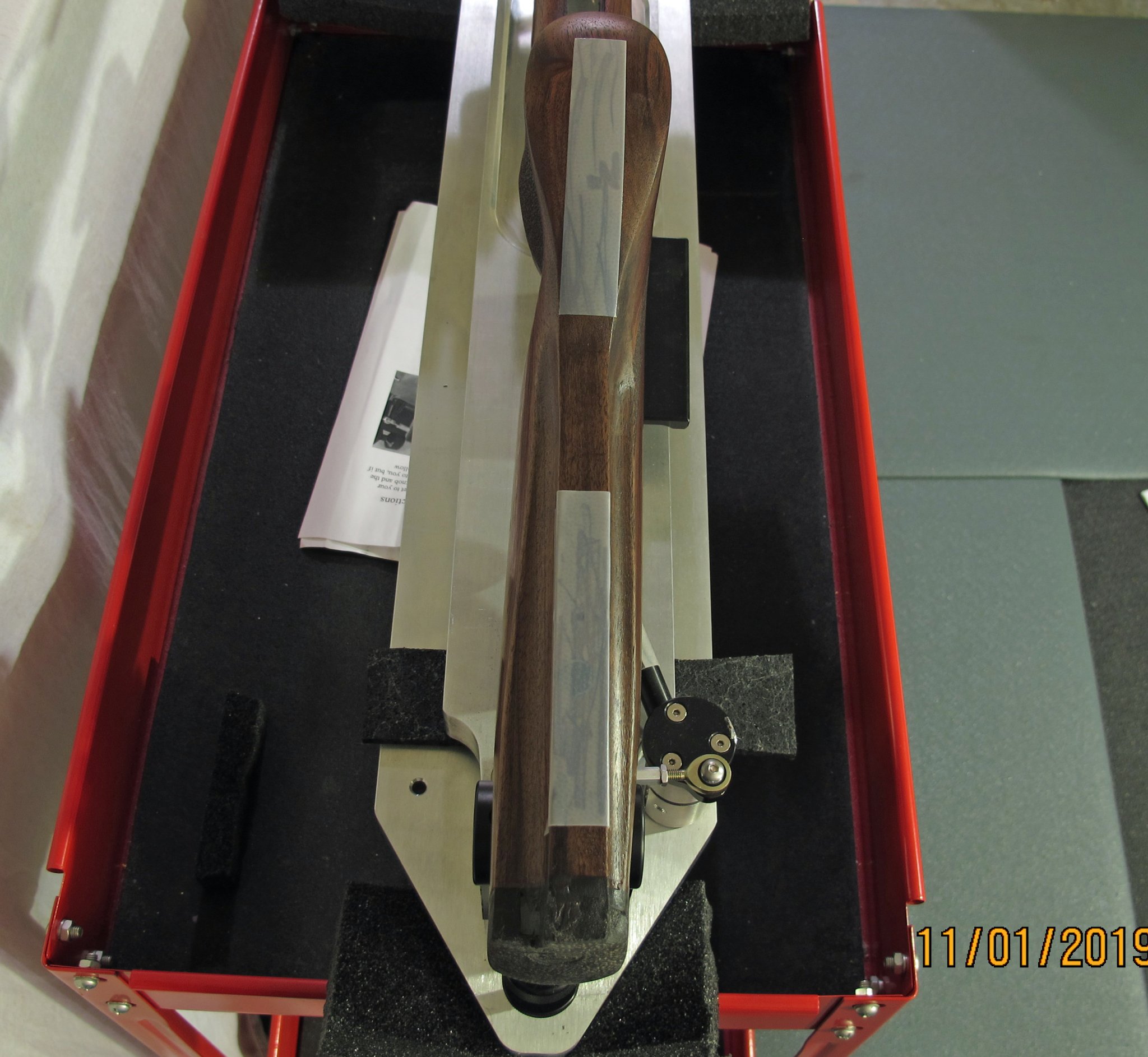

3rd pic - compare pic 1 and 3 - note that the front rest top is now down at the lowest vertical height (where #1 was at almost the top)
4th and 5th pics - note that to maintain alignment with the barrel channel the buttstock "rail" was machined well offset to the side.
