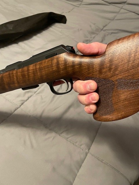

Got a new CZ 457 MTR a couple weeks ago and wanted to see what you guy that own one think of the stock? At first I thought that it was a little goofy feeling but after putting some time behind the trigger I think I am starting to like it.

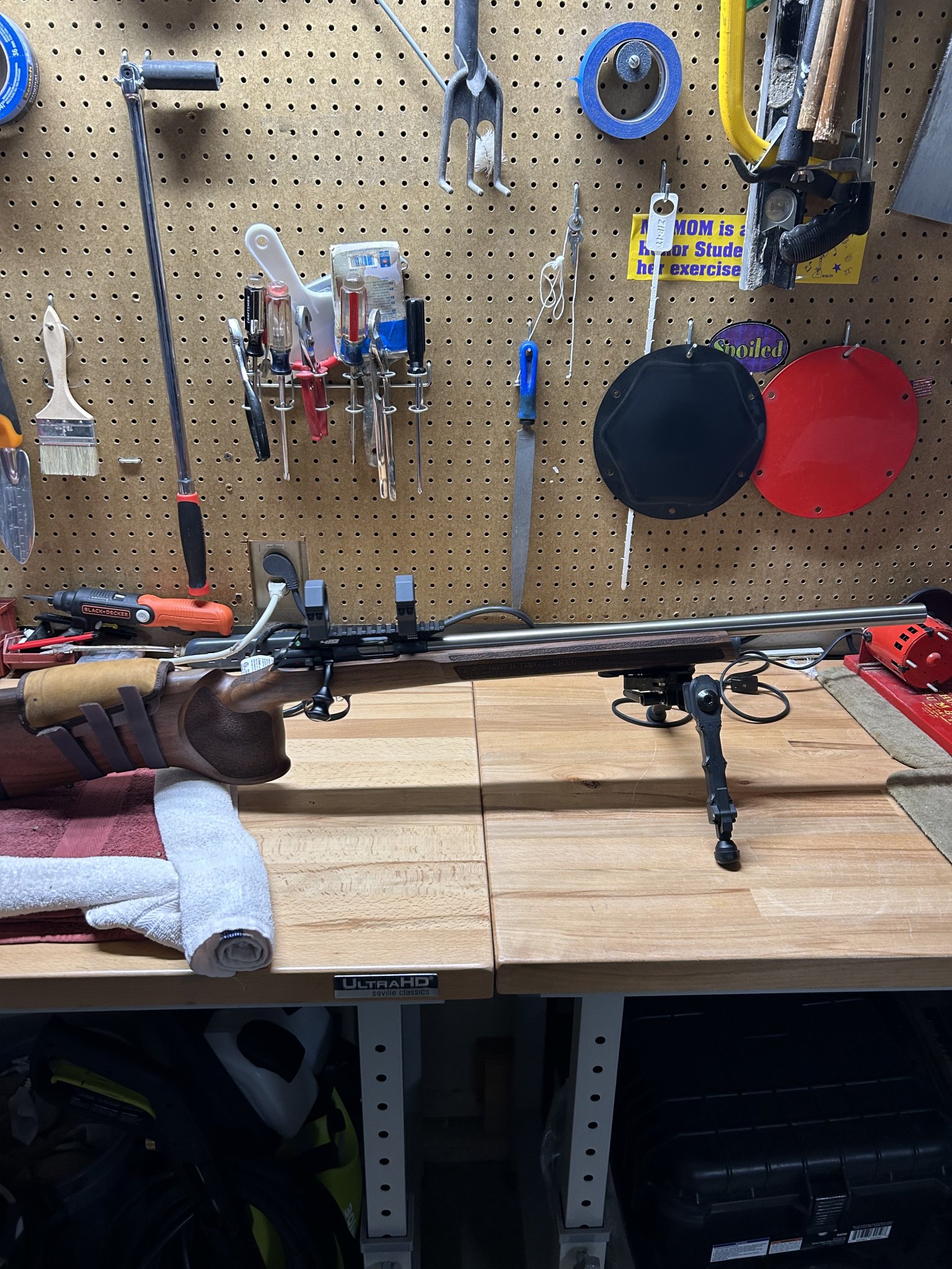

I love mine. But i also own Anschutz stocks that are similar because i like them. My MTR has turned in some nice groups with R50 and Center-X. But falls down with grades like rifle match have a flyer that opens up the group. I have spent the last few weeks pillar bedding the stock. Just finished last night. But it is cold here in NC so i won’t be testing any improvement for a while. So i am going to refinish the stock. Not a fan of oil finishes.
My opinion is that this is a lot of rifle for the cost. It may give my 40x and Anschutz 54 a run for their money

I really hated the stock when I first saw it. I thought it looked really funny. We picked one up anyways because of the rave reviews and I've come to really like it. The vertical grip feels really solid once we got used to it and positional shooting feels pretty natural with it. I still don't love the look of it from the side, but overall we're happy with it and plan on keeping it in the stock for a while. Eventually it'll get thrown in a Chassis or Manners (if we can find one), but for now I think it suits our needs and functions well.

I have pillar bedding on my list of things to do with this stock. I did notice that when torqueing to spec that the action screws seemed a little "mushy" while tightening. I don't really care for those plastic pillars that come stock. Any tips or tricks you would like to share?? lol
Initially i thought i was going to leave the plastic pillars but then i saw that the pillars were getting an image of the action. This meant they were not rigid enough and would give varying torque by relaxing. I went with pete’s pillars. Watch out on the rear pillar. I found that my inlet and pillar wasn’t really touching the action so it wasn’t doing any good. Bedding also fixes the rattling recoil lug but be sure to shim it a little on the rear side. I needed a .025 piece of brass and it was tight
