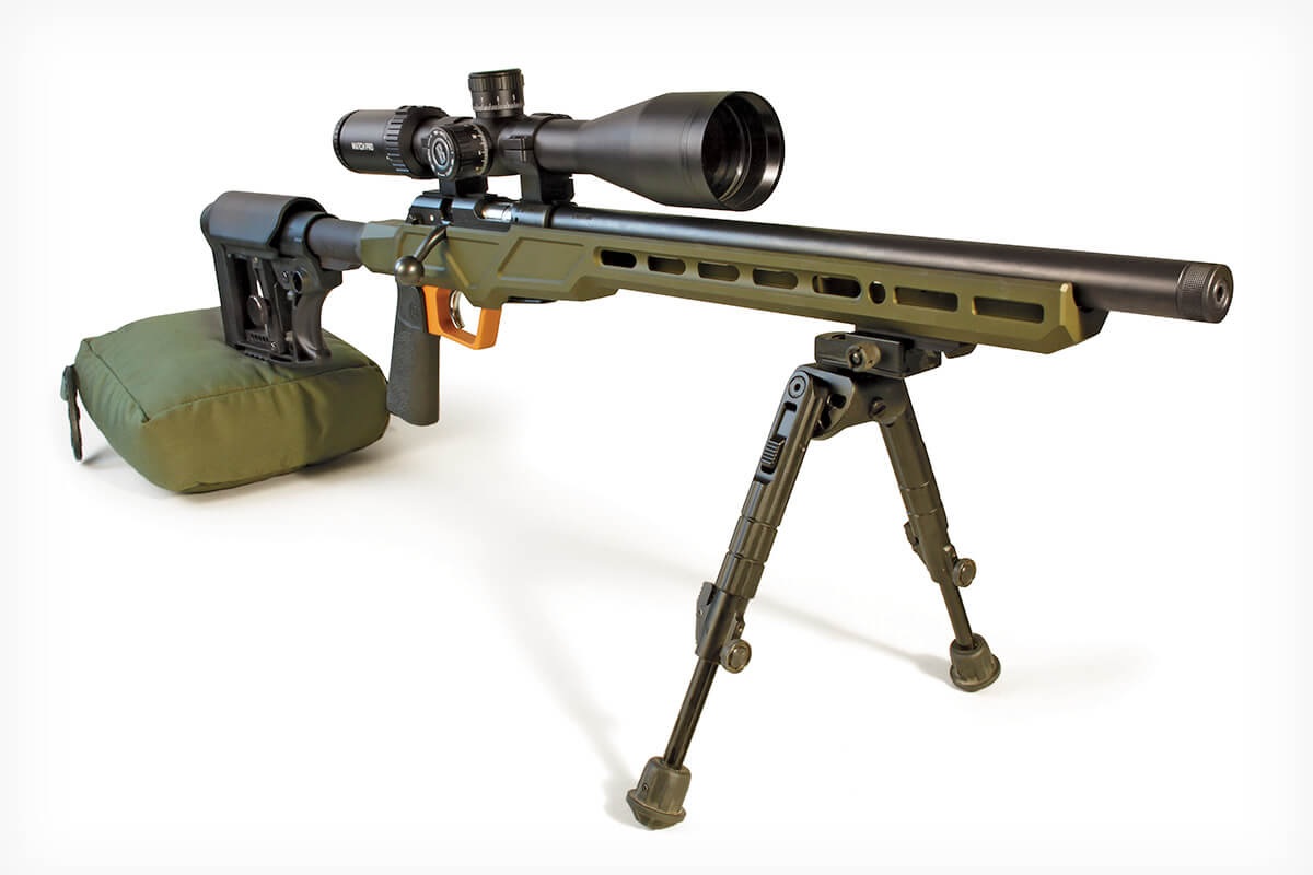

Two different models, Varmint Precision Chassis and Varmint Precision Chassis MTR. Only the latter model has the MTR chamber.
Green chassis with orange trigger housing.
Reactions: lash
Varmint Precision Chassis with factory tapered 24” threaded barrel. Chamber does not engrave the slug. Gun shoots to the limits of ammo consistency.

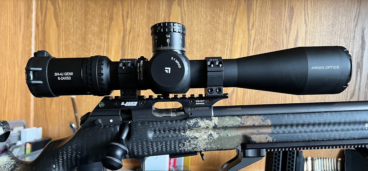

My brother's CZ with an Arken SH-4J (34mm main tube) with Vortex Pro Medium Rings (1.1 inch)

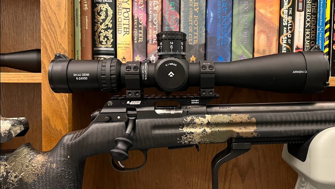

Same rifle and scope but with Vortex Pro Low Rings (0.95)
As you can see, the main clearance issue is the zoom ring. The Objective has more than enough room for a 56mm objective.
One other small consideration might be the turret housing. Some scopes like the Arken have a large protrusion (for the spring retainer IIRC). It just clears the mounting base with the 0.95 inch low rings, but if you don't have that protrusion you could go a tad lower.

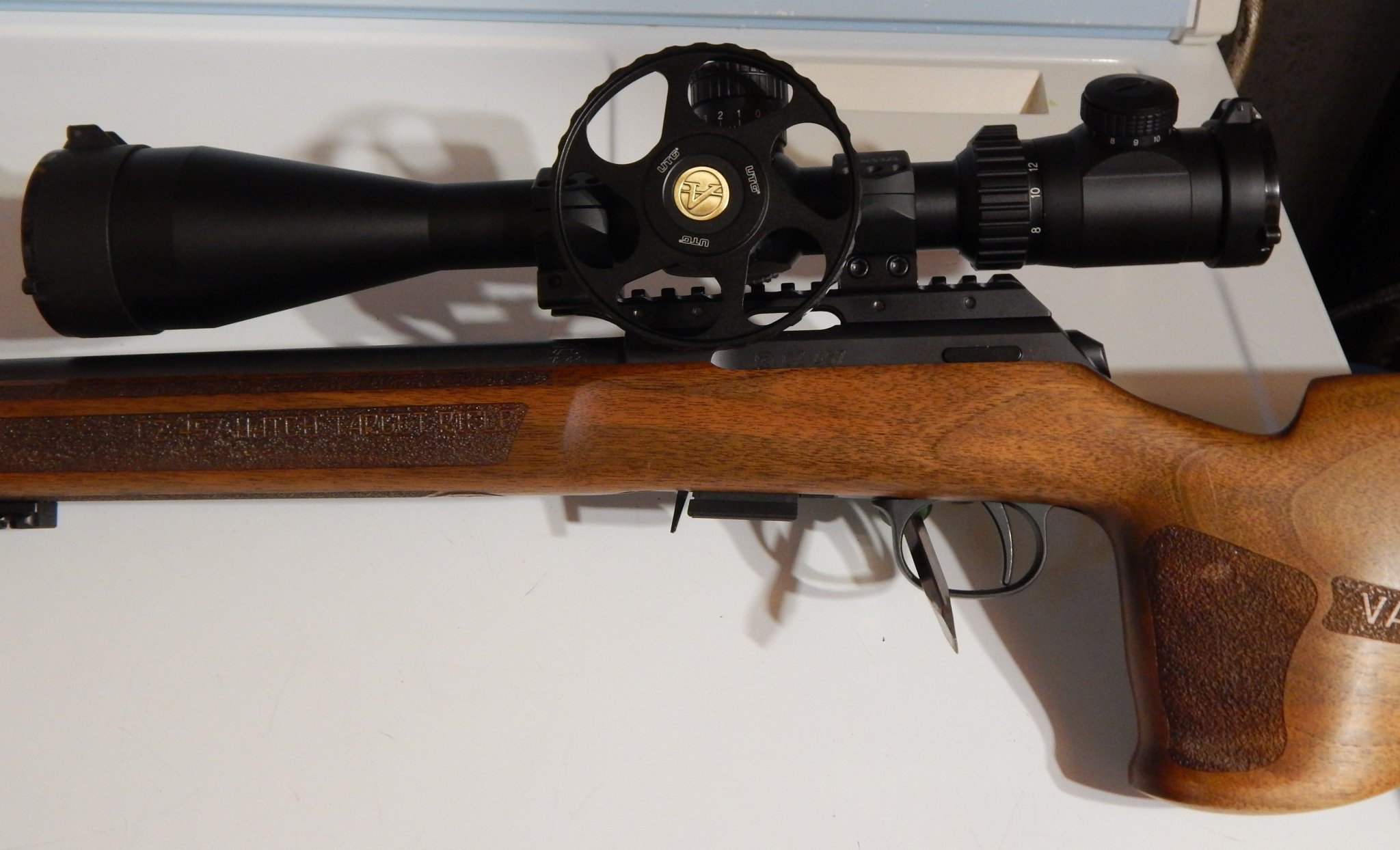

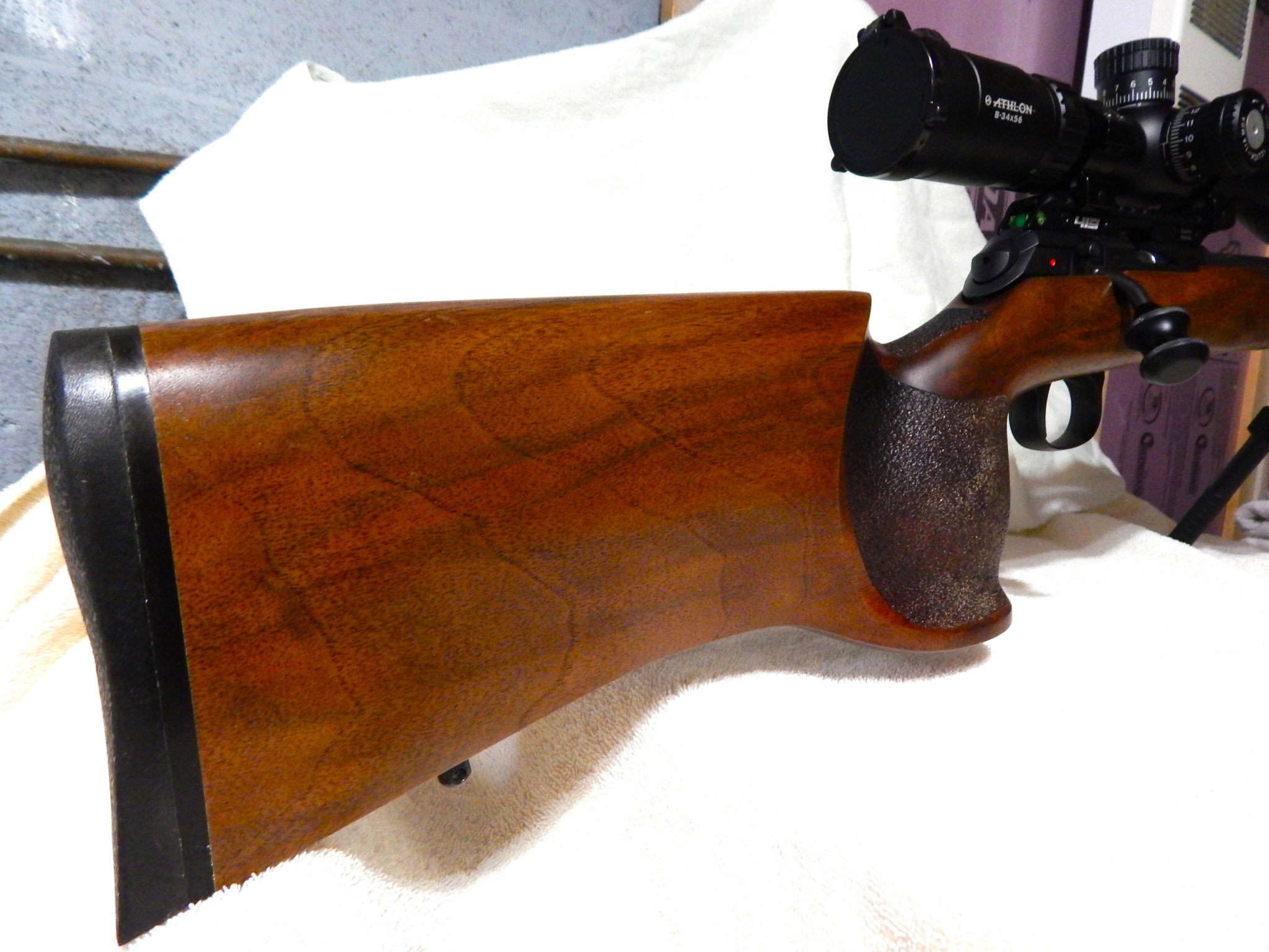

Big IG - Here's a pic of my 457-VMTR with the 419 30MOA rail, using the Burris Signature XTR Insert ring-set. I have a +10 Front ring to reduce MOA to 20, since I'm only shooting to 175-yds so far. The scope is an Athlon Argos 8-34x56 FFP. Even with the scope cover there's about 1/4"+ clearance. But I'll swear by using the bubble to remove 'cant', I've noted difference in POI even at 50 yds.
Also pic of my buttt - :rolleyes:
