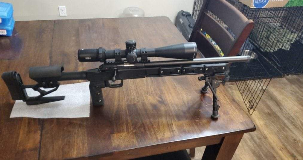

I recently bought a XLR Element stock for my CZ 457. On their website, it said the torque spec of the chassis for cz 457 is: Action Screws 65inch/ lbs. (https://cdn.shopify.com/s/files/1/0995/2330/files/XLR_Torque_Specs.pdf?4773220458823953227)

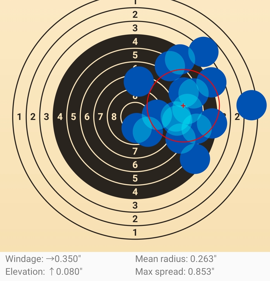

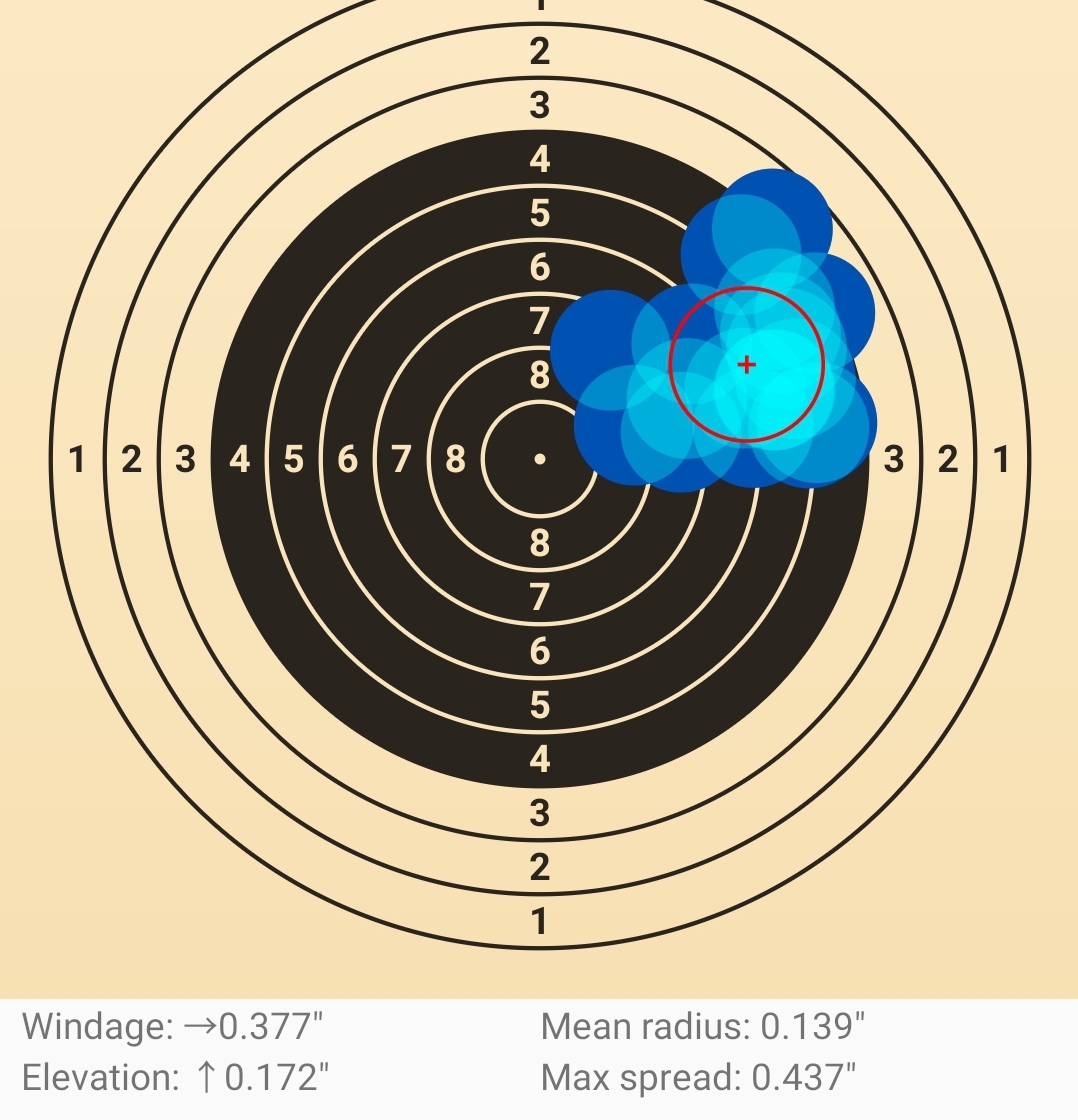

So here is my result, I have since pillar bedded the gun but this was my eye opener:
18 collated shots, 55yds, Lapua Biathlon.
I'd say the one on the right could be me but the results still speak for themselves.
Torqued with hand, maybe 2Nm:
Loosened torque with hand to 1.2Nm (measured later)
