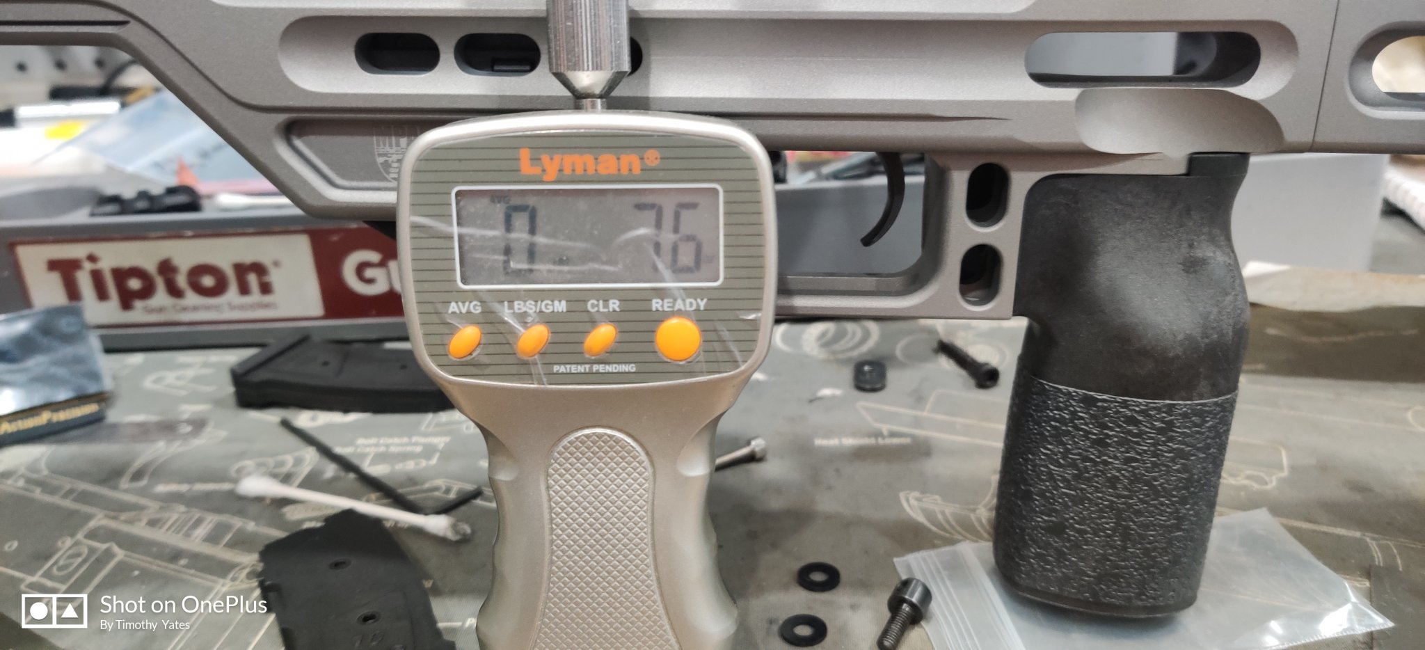

Me too. Worth every penny. Here's my results and this was a long time ago. IIRC that was an average of 5 pulls.

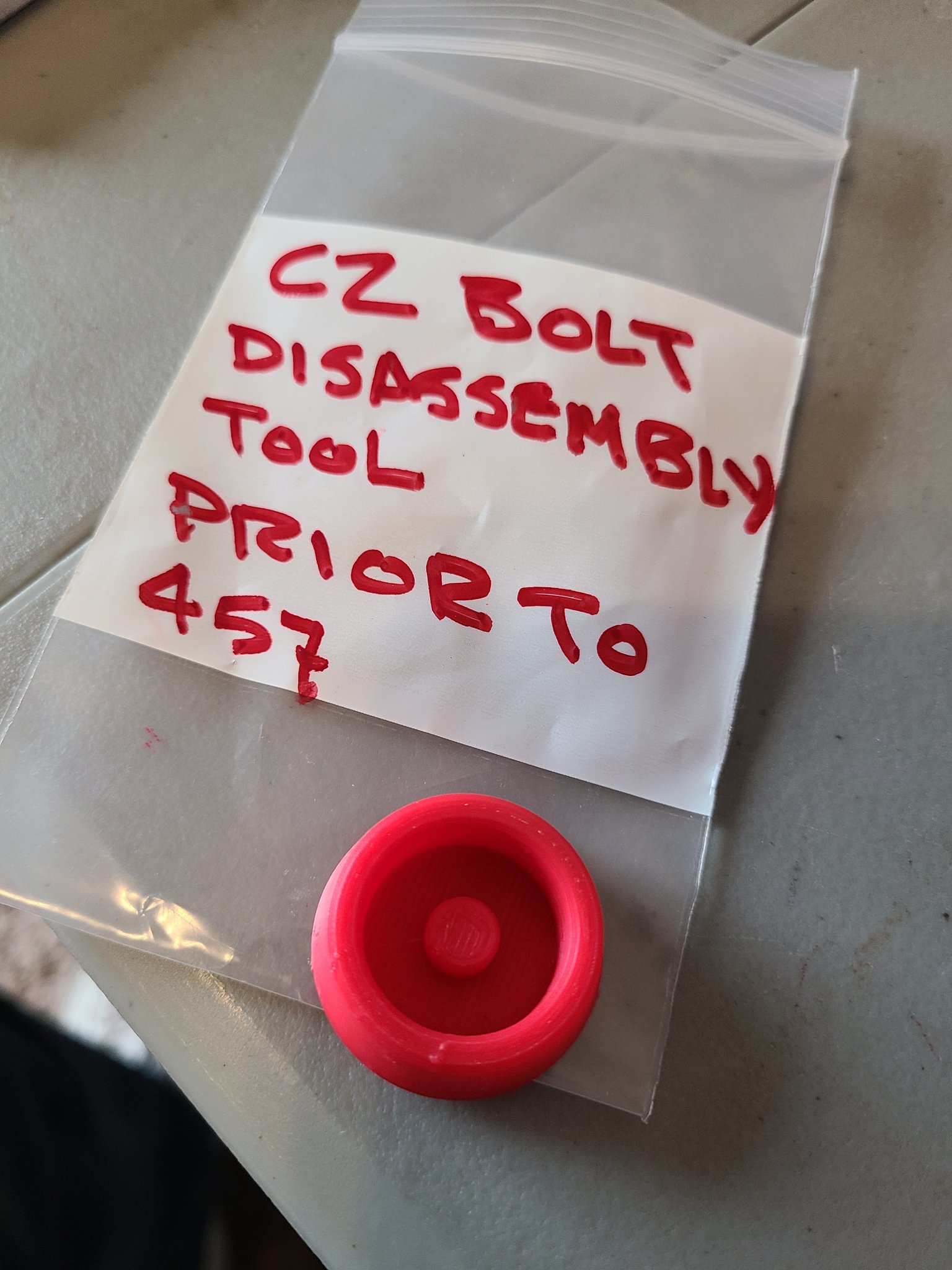

Mine had a couple springs, lapping film, some grease, dope cards, and a bolt dissembly tool.

Installed the YoDave’s trigger Spring.
Before installing it, I had tested the trigger weight when I first got it. From the Factory the pull weight was 2 lbs. 3 oz. It felt a little heavy but not to bad without hardly any creep. Installing the spring took less than ten minutes (pull weight now 1 lbs. 3oz just by installing it). It feels 100% better, smoother and light.
