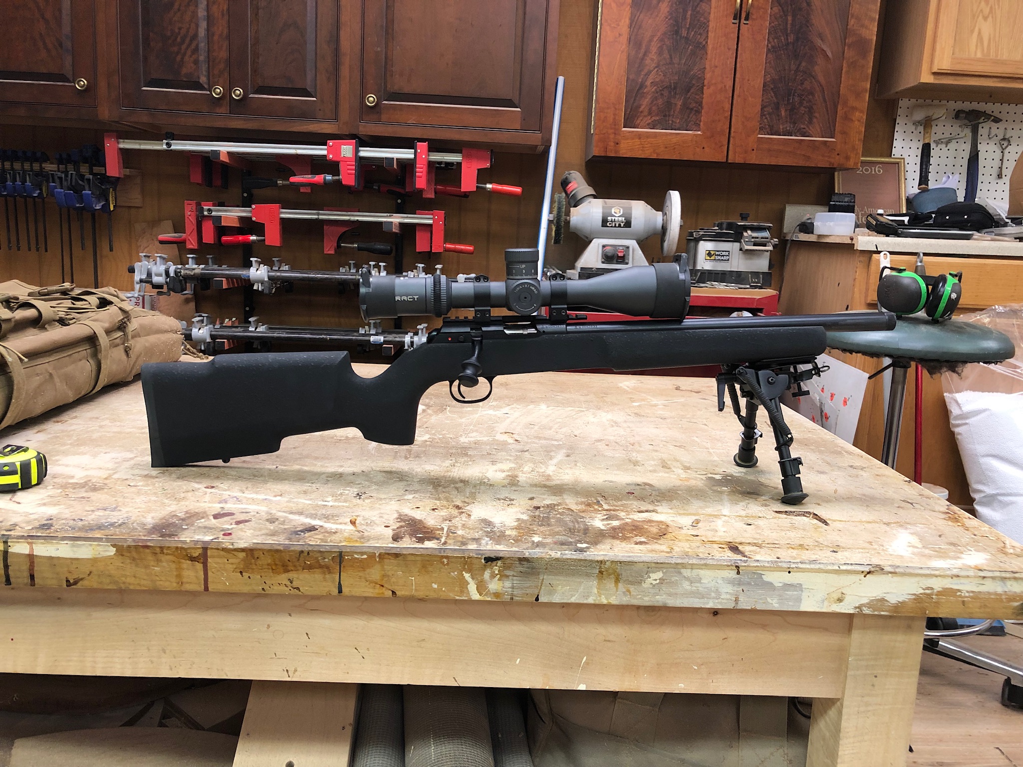

I have the DIP rail on my rifle. This is a 30mm scope with a 50mm objective. These rings have .375 under the tube. It gives me about 1/8” clearance between the scope bell and barrel. I like my scope as low as possible as well.
