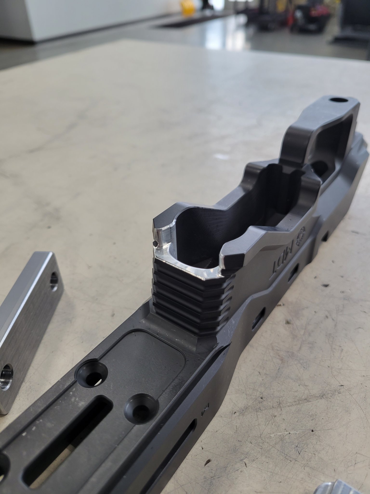

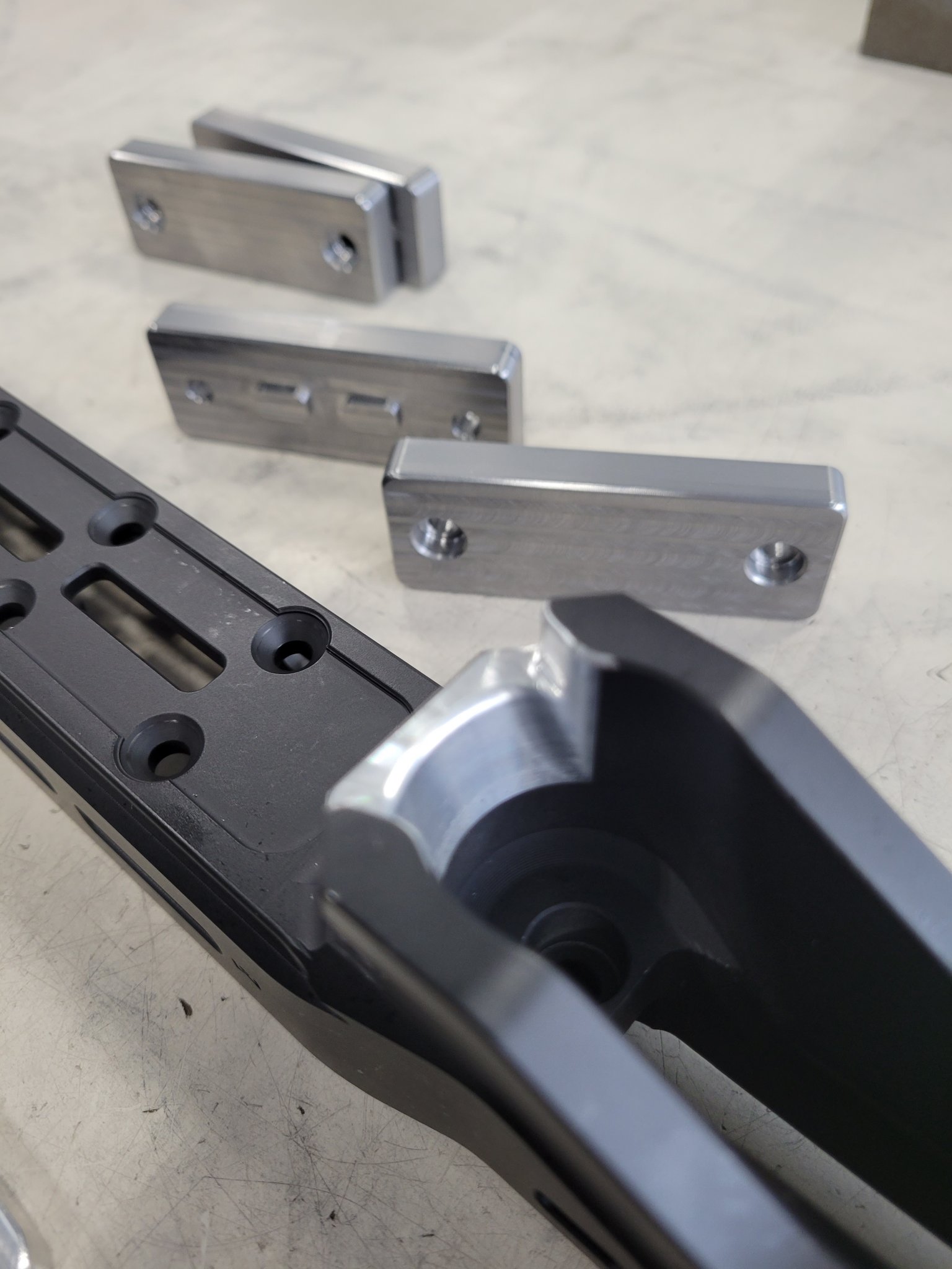

I just put mine in the CNC mill. Not everyone has one at their disposal.
