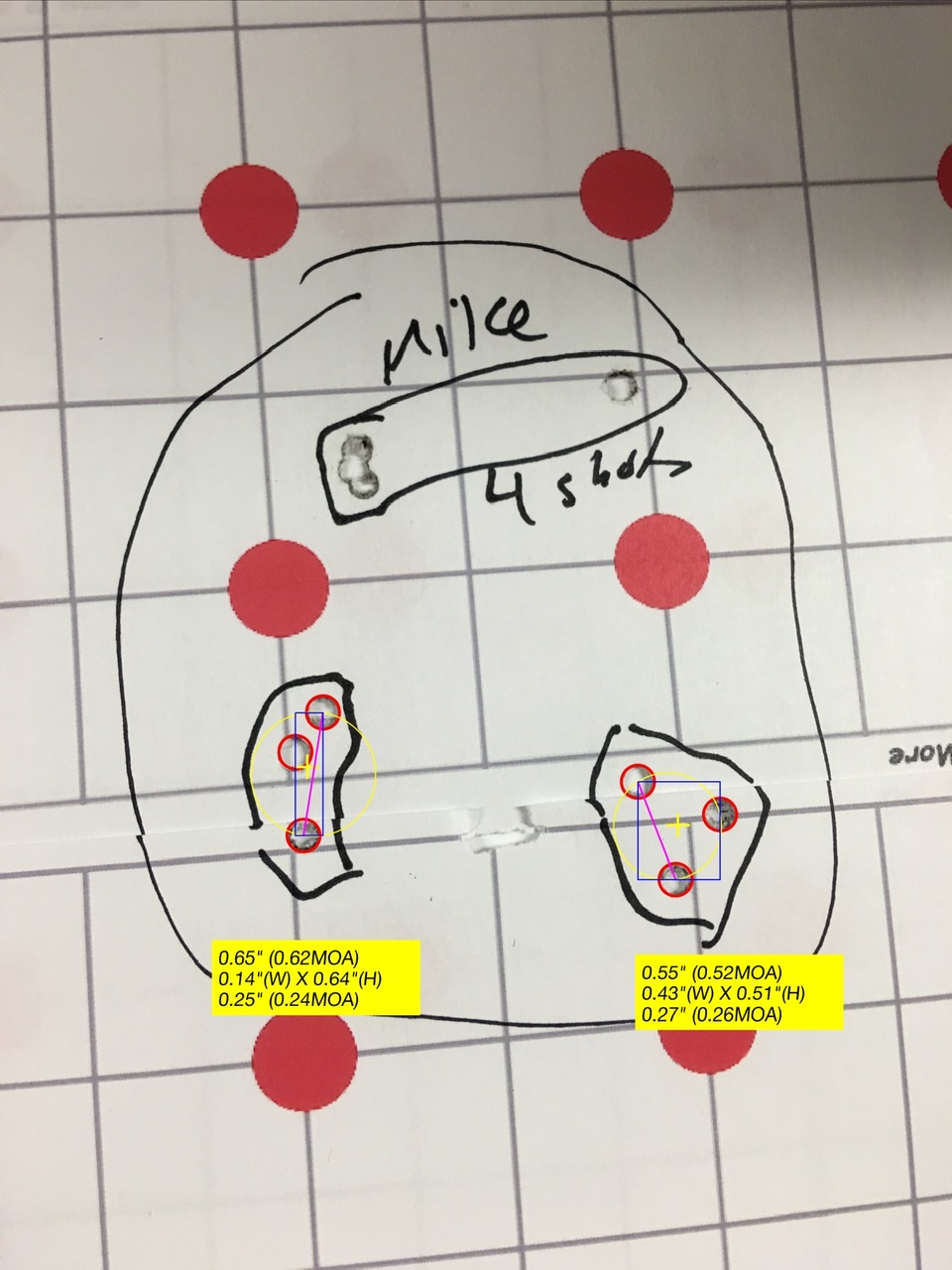

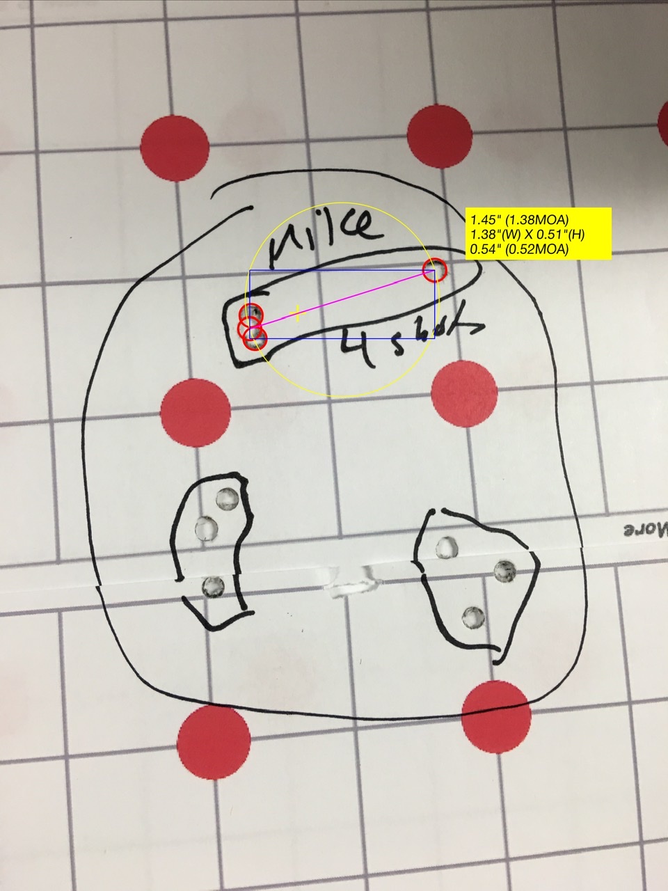

So, checking back in on my thread. Attached are pictures from after the gunsmith supported the barrel near where it exits the stock. The shooting was on April 24, 2019.
A fellow at the range, who shoots much better than I, recorded recorded a 100yd three shot group measuring .17 MOA. He messed up the fourth shot, resulting in a four shot group of 1.38 MOA.
My two groups of three shots each averaged out to .57 MOA.
The ammo used for this second session was 20 grain Hornaday factory ammo.
There really aren’t enough data here for me to conclude that what the gunsmith did has permanently improved the gun. But, it’s a promising start. I definitely think that this gun needs to be bedded. If anything, if I keep it the way it is, the barrel needs more support, because when I handle the rifle I can hear the barrel rubbing around a bit on the pad the gunsmith installed.
During my subsequent prairie dog hunt, I found I used either my .204 or .22, and barely touched the .17.
This summer, I was messing around with a .223 Remington 700 5R, and didn’t pay any attention to the 17 hornet.
Even though I live in frigid Minnesota, I might try some more shooting with the 17 hornet, but to be honest, I’m more interested in 22 rimfire right now.
I should note that I did indeed clean most of the black gunk out, which if I remember correctly, is the bluing that CZ does…They must dunk in the whole barrel into the bluing solution.
I should note that my initial groups in my original post were shot using both the 25 and 20 grain Hornaday factory ammo. I can see why they discontinued the 25 grain, as it shot noticeably worse.
I’ll try to remember to check back and update you all with more groups and any improvements I have made with the rifle. I sure appreciate all the advice.
