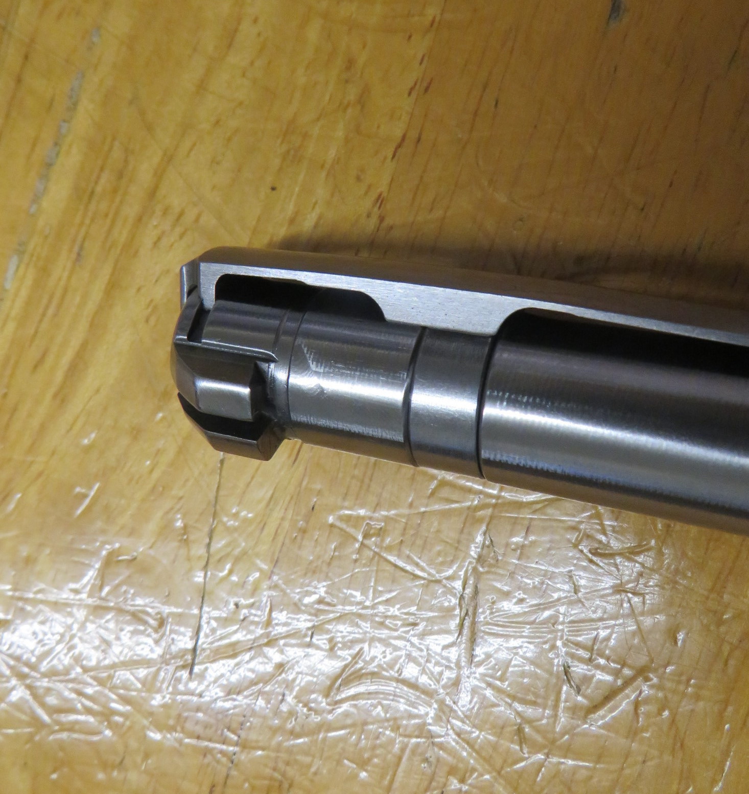

I just got a brand new CZ 527 varmint mtr in 223 and while cleaning it for the first time I have found that the bolt has what I would describe as "parts of metal missing" (picture attached). Poor machining? They ran out of metal making all these guns during the crazy demand :) ? My other 527s don't have anything like that, their bolts are perfectly cylindrical there. I'm no gunsmith, but this seems to be more of a cosmetic issue than anything else since this is going to be behind the locking lugs. And I suppose there shouldn't be any related accuracy issues. But I figured I'd ask the experts here first before shooting it (or contacting CZ). It's annoying to see on a brand new rifle, though.

Surely someone else with a .223 CZ 527 will chime in for comparison, but it looks like tooling marks to me (IE either intentional clearance or a machining fuckup)
Is there anything in your action near that location to indicate whether or not it might be a clearance cut?
I would hit up CZ for clarification and shoot it as is until you hear back from them. I wouldn’t be worried about a structural failure of the bolt though.

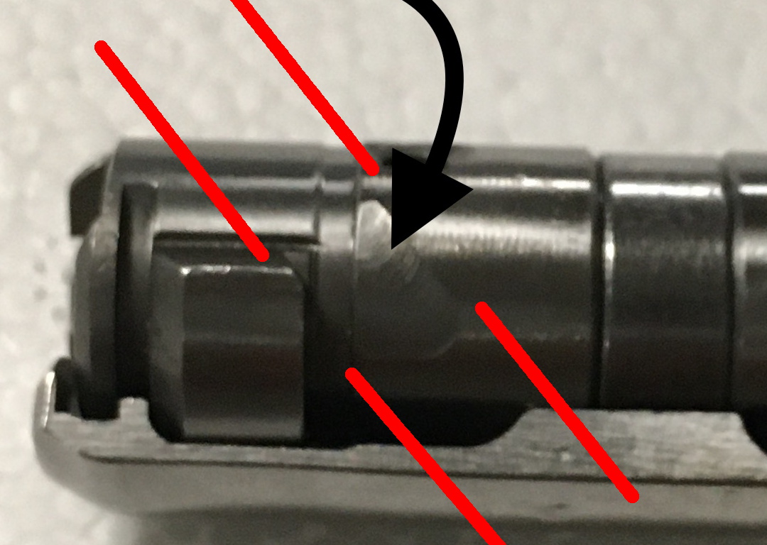

I'm no "expert," but it looks like it's just a machine mark from chamfering the corner of the lucking lug:
The tool depth was just a little deeper than it should have been (tool path highlighted in red). It's what you get for Eastern European manufacturing. Should not affect function.
You can send it back to CZ, I'd be interested in hearing what they think about it, being that it's cosmetic more than anything.
^^^^ That’s exactly what I was thinking.
If you do want it made right, they might try and talk their way out of a replacement because it’s an internal mechanism, but really what’s the difference between that, a gouged stock, scratched bluing, or a cracked Buttpad?

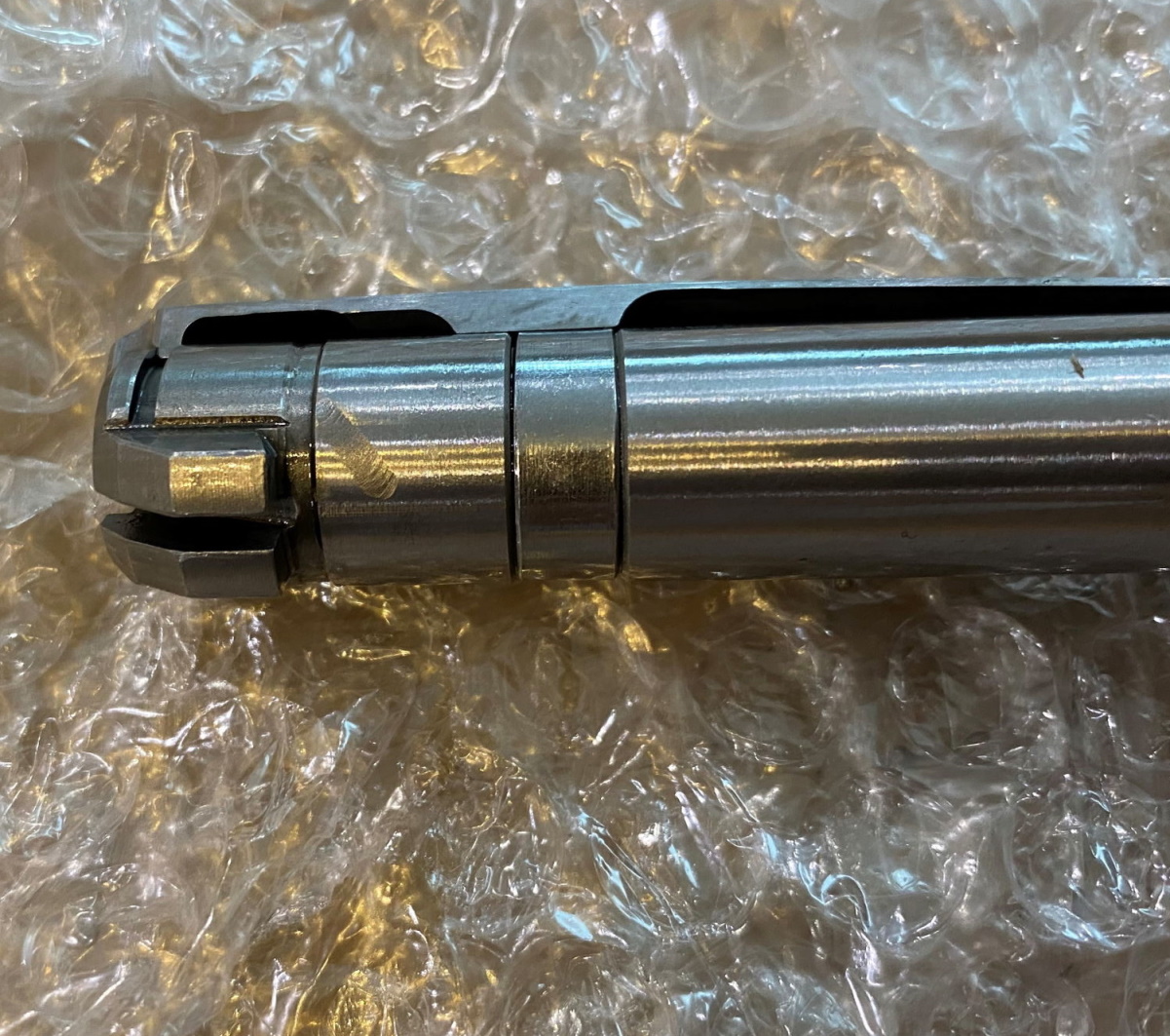

I've noticed this also, most CZ527's with serial numbers starting with D26.... and just picked up what might be the last F prefix serial number here in the UK in .17 Hornet and that still has the issue, however its very slight and most people who were unaware of this would probably never notice.
I got a message from the factory last year, they openly admitted that a new CNC machine wasn’t setup quite right, but were clear that its a cosmetic issue and nothing more.
See pics, bolt from an D prefix serial number rifle (on the bubble wrap), and F prefix on the wooden table:
