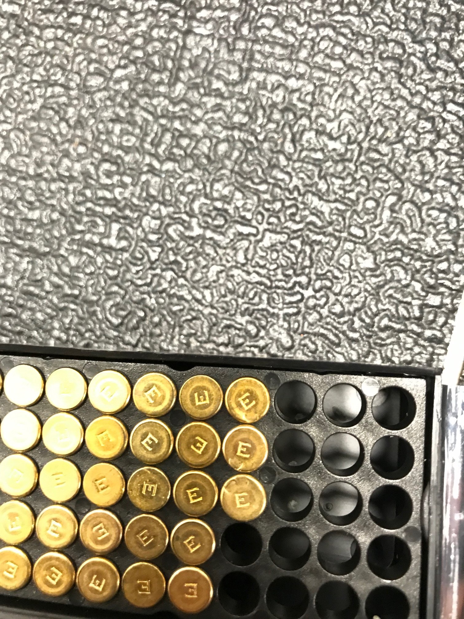

Shot Eley for the first time the other week and of the 20 I loaded in the mags 4 failed to fire. All had firing pin marks. At first I thought it was my son just not closing the bolt fully because I put the first one back in the mag and it fired. Then several more mis fires. So we just continued to fire SK std + which I have never had an issue with. I shoot a Bergara. The first 3 rds in the pics are the misfires.
