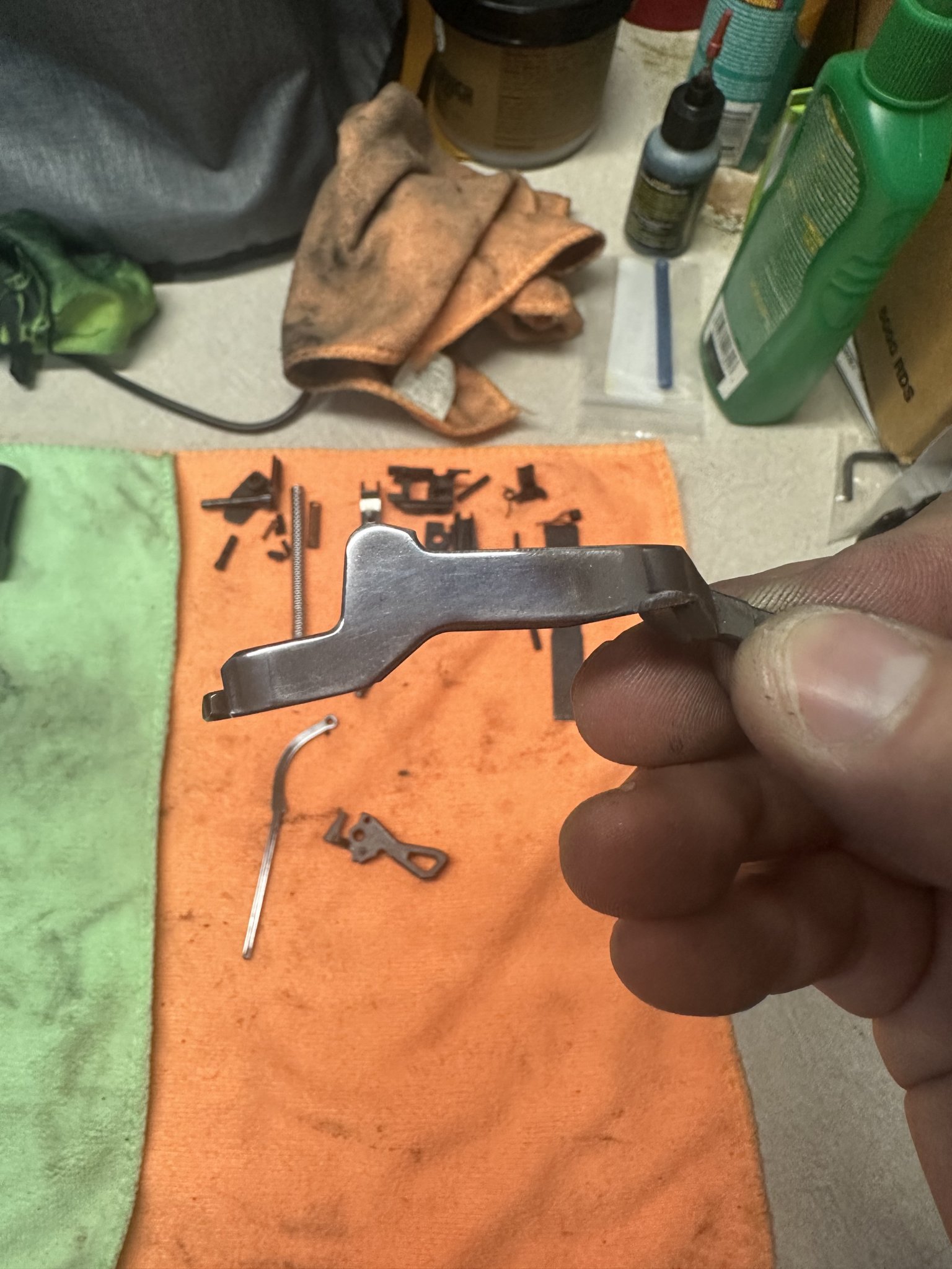

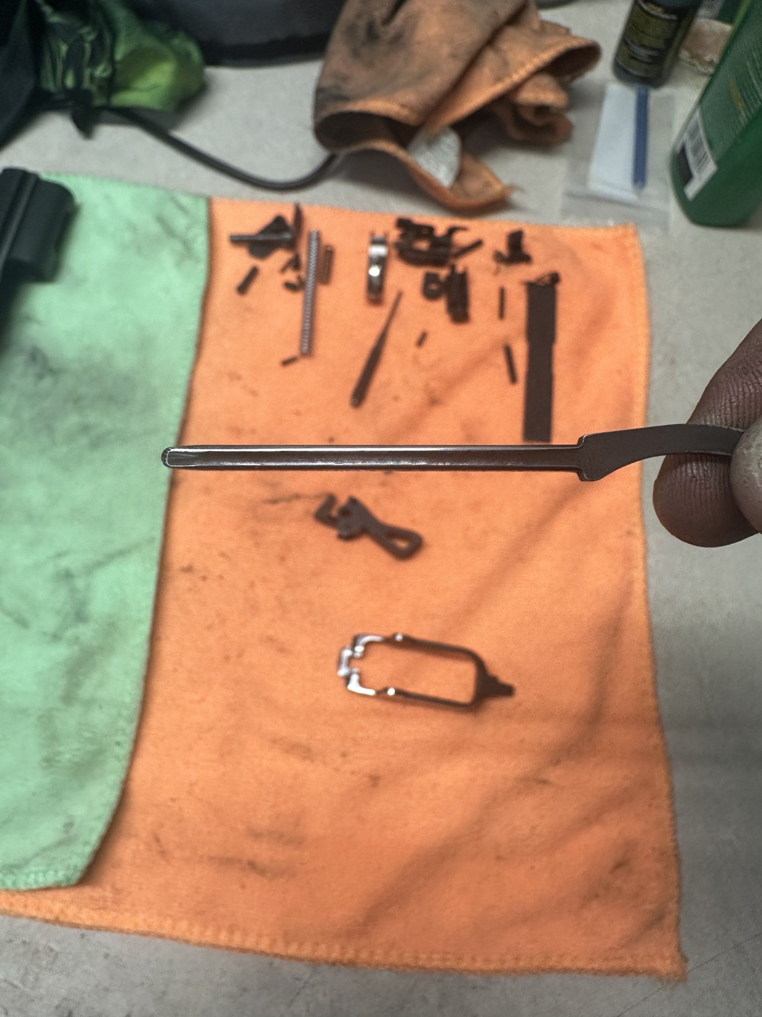

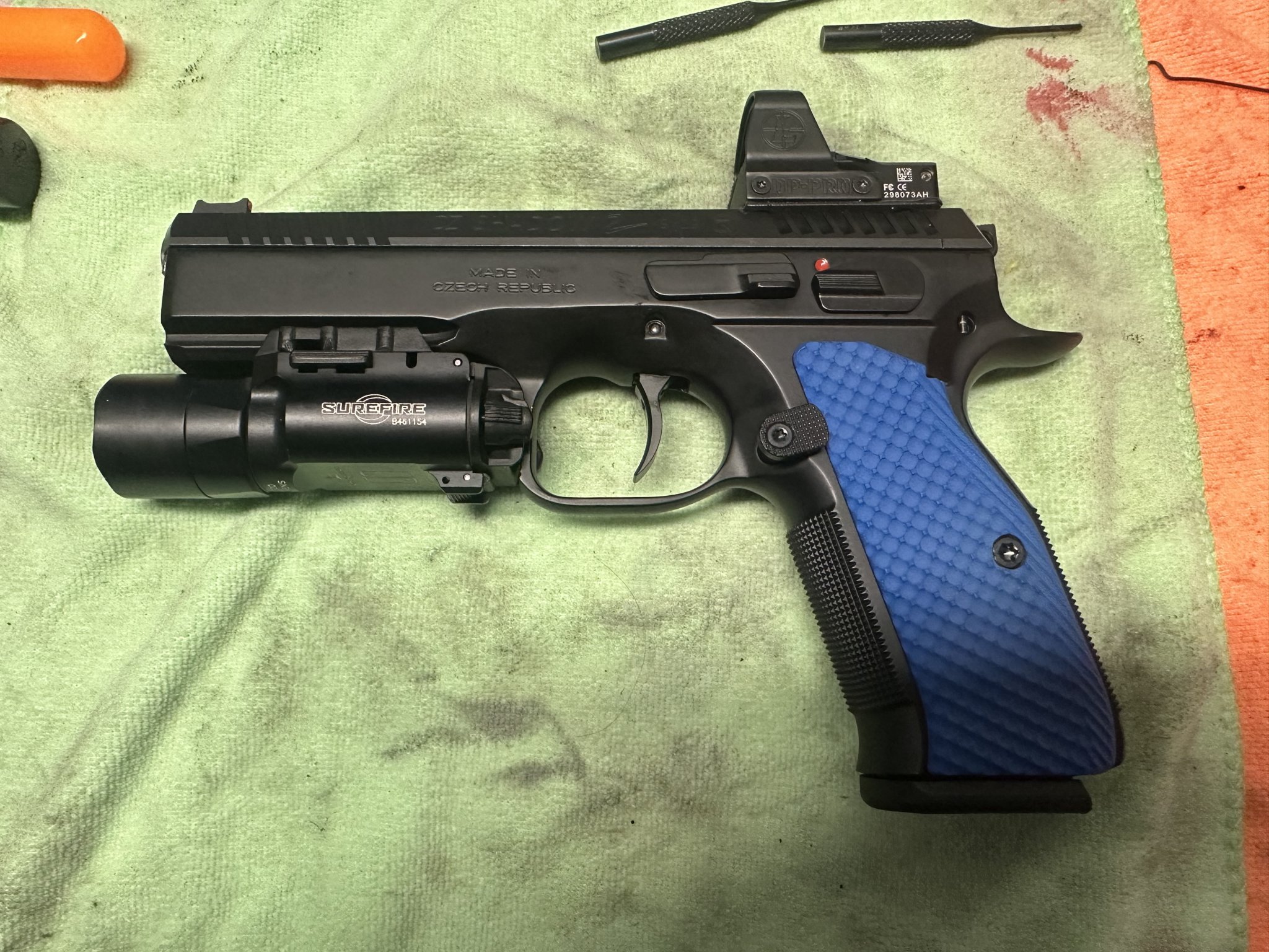

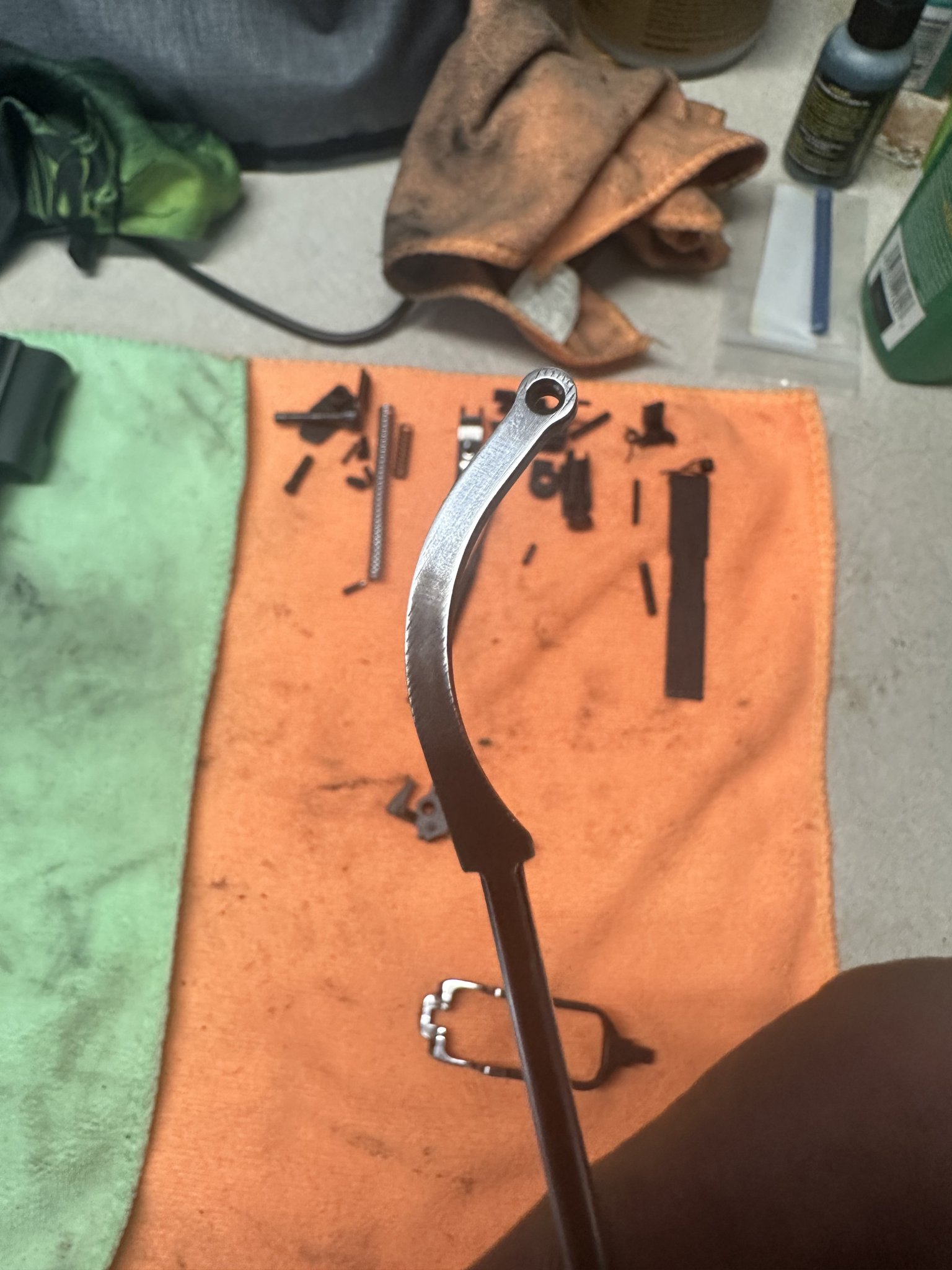

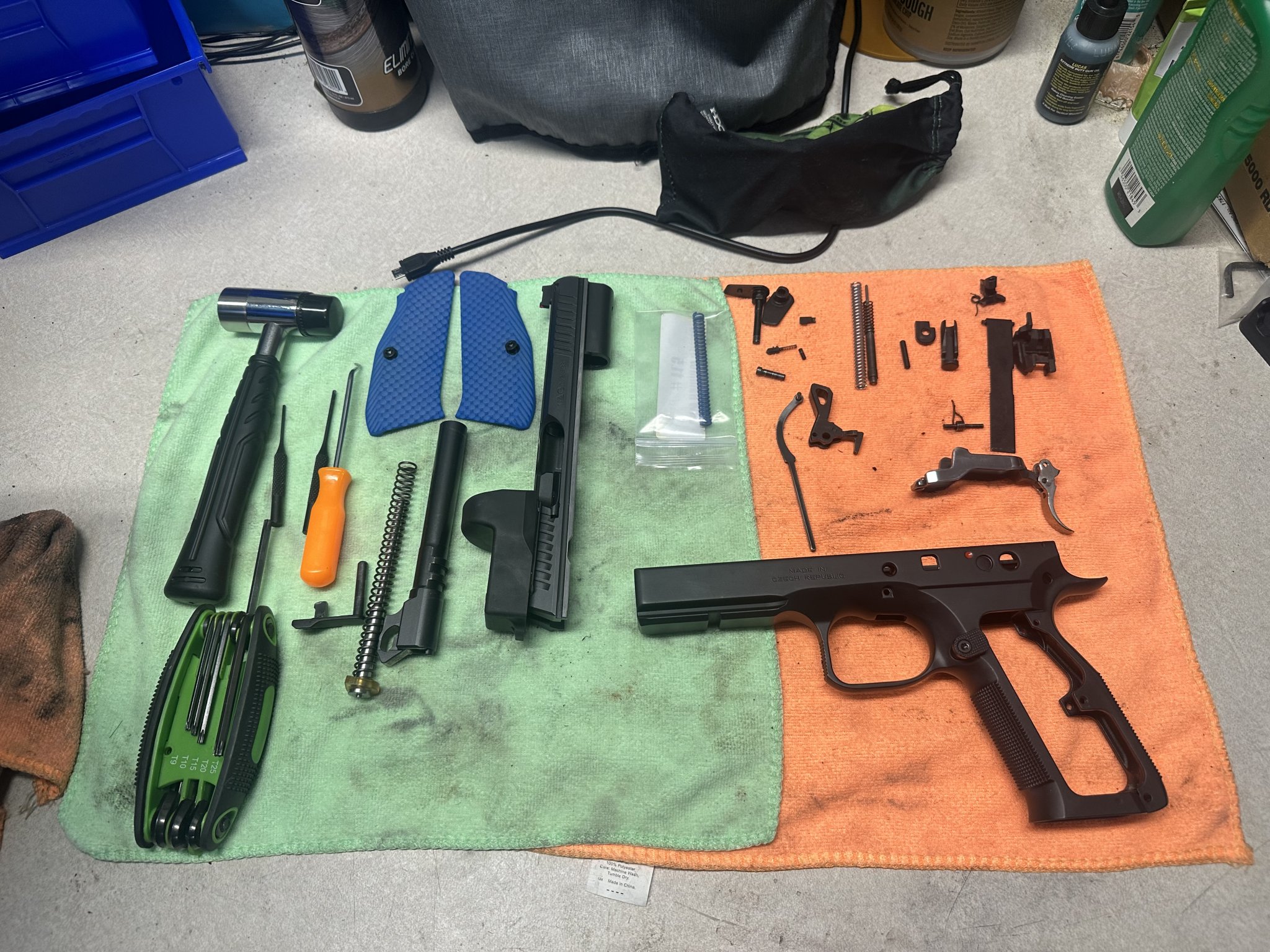

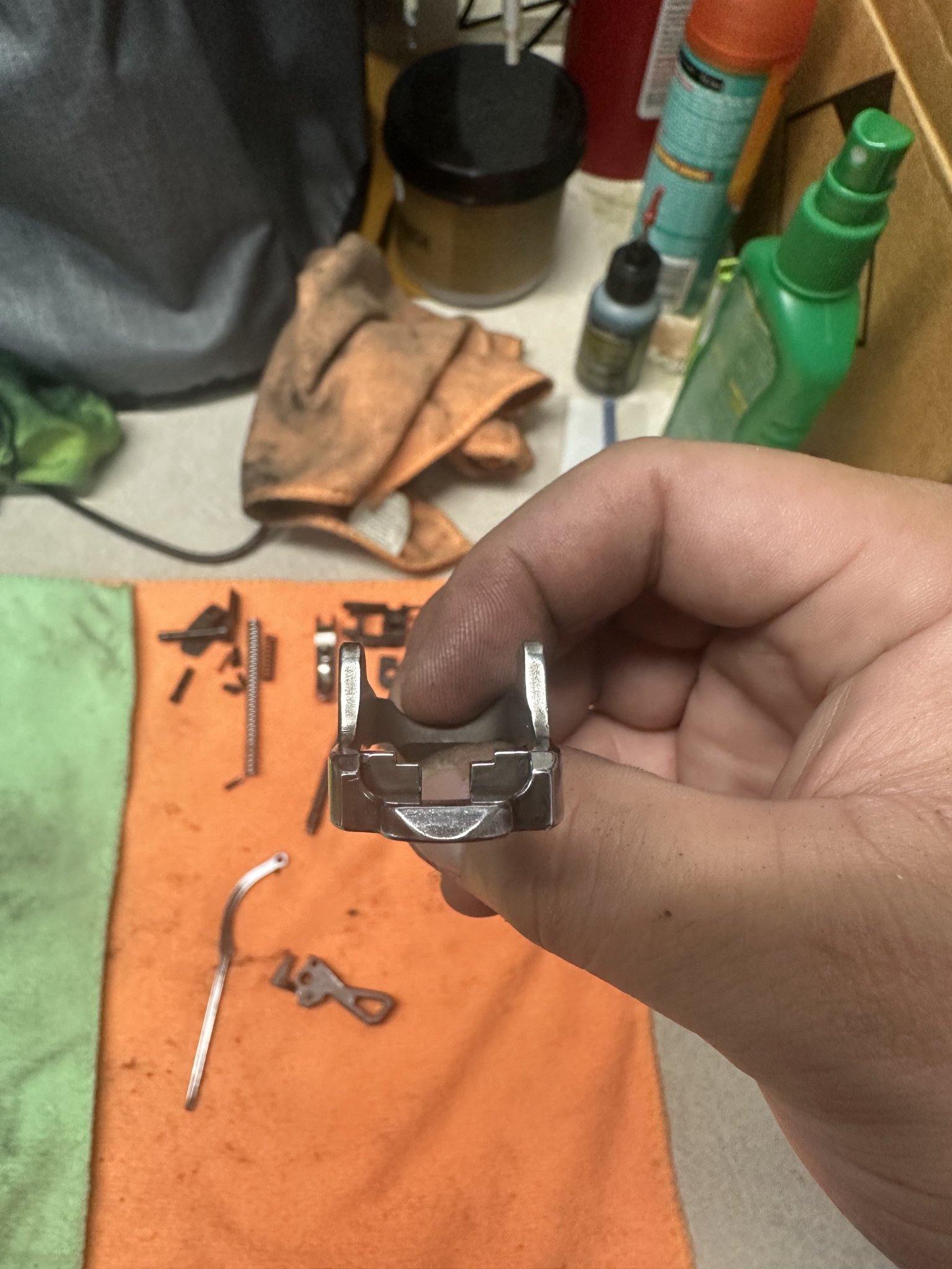

    I got bored and decided to do a trigger job on my shadow 2. Called up Cajun and they quoted a 14 week turnaround time. I got on the waiting list, but decided to do some research on how difficult it is to work on. Didn’t seem too hard, so I gave it a go. Tore the gun down following the instructions in this CZ 75 tear down, and Polishing using this thread. Now I’m just waiting on the Pro package from Cajun.
    Kind hard to tell from the pictures, but the parts are pretty much a mirror finish. I used 500, 1000, and some scotchbrite. Then I used a dremel and mothers wheel polish. Gotta be super careful not to remove material as that will change the timing of the action. You just need to smooth out the surfaces. I’ll update once I get the parts from Cajun.

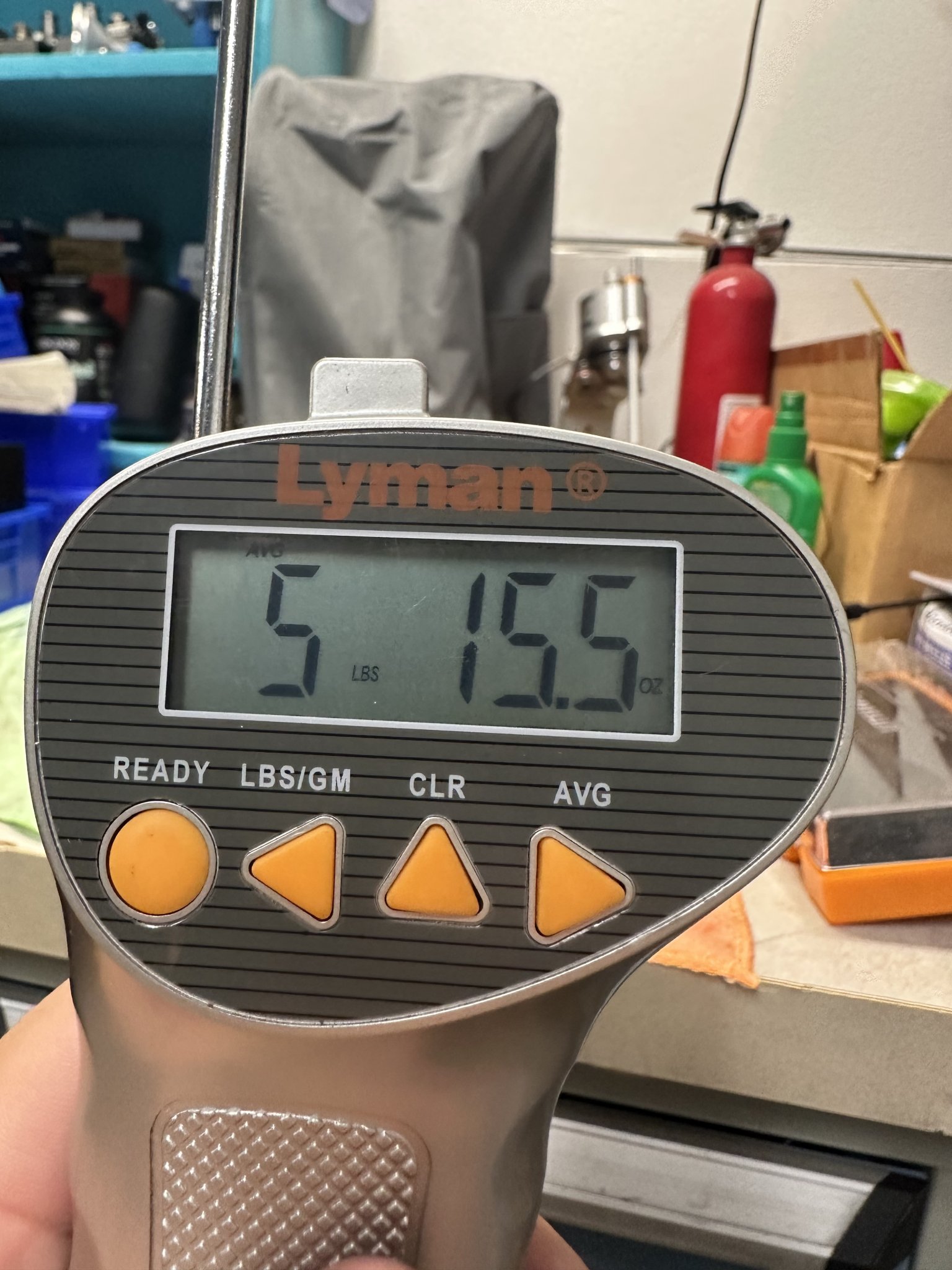

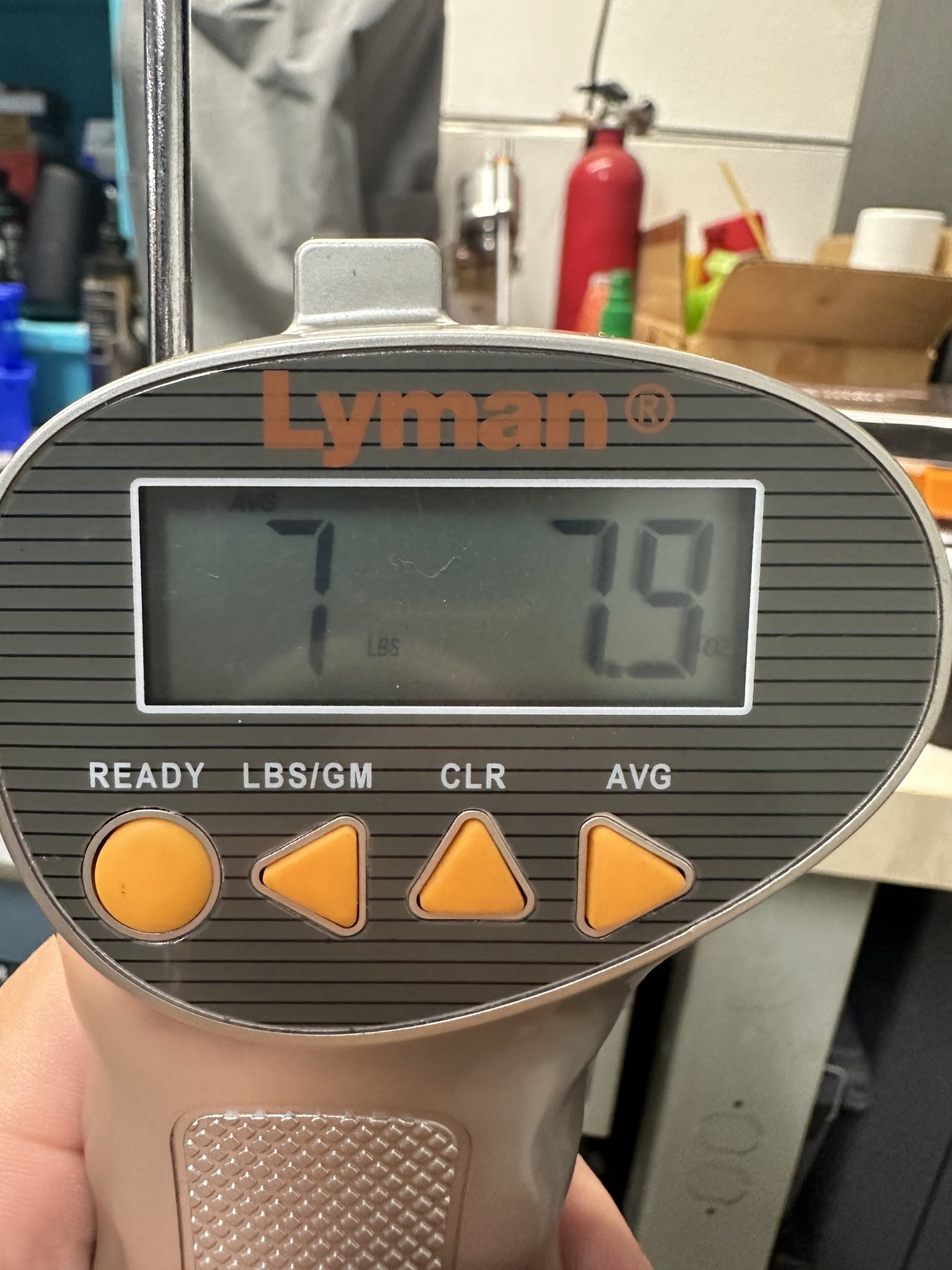

    I put the gun back together with the stock parts to see how the polishing feels. So much smoother. I forgot to get the trigger pull weights before. Here’s the DA/SA weights with the factory hammer spring. Weights are based off of a 10 pull average.

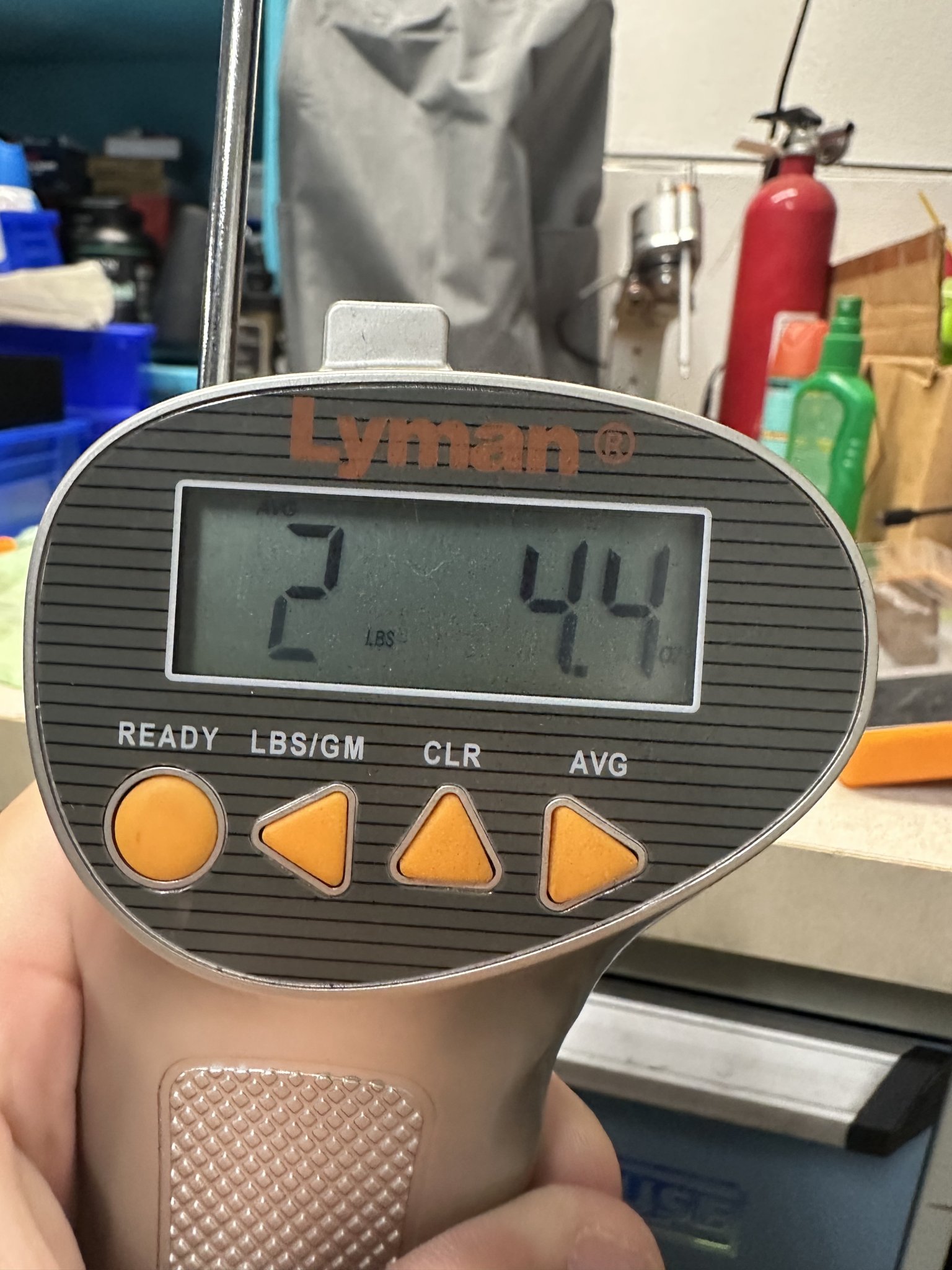

    And here are the weights with a 13lbs hammer spring. DA significantly reduced SA stayed the same.

    Got the pro package in today and installed. Insane how short the SA pull is and the reset is super short too. I’m running an 11 lbs main spring with the CGW DA/SA flat trigger. DA is coming in at 5 lbs 5 ounces and SA at 1 lbs 15 ounces. All in all it’s been a fun project to work on. Got lucky and didn’t have to fit the disconnector, so that saved a lot time.
    DA TRIGGER
    SA TRIGGER

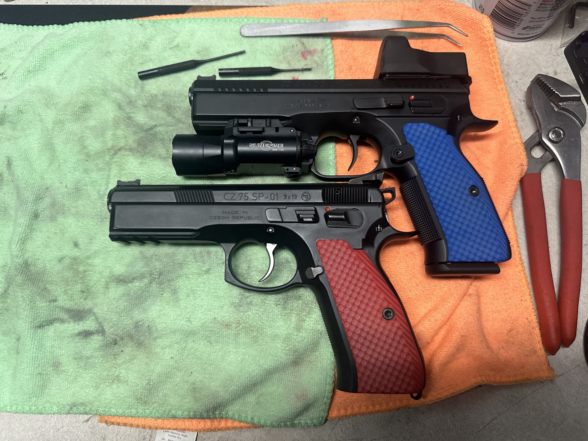

    FLAT VS COMBAT 85 trigger
