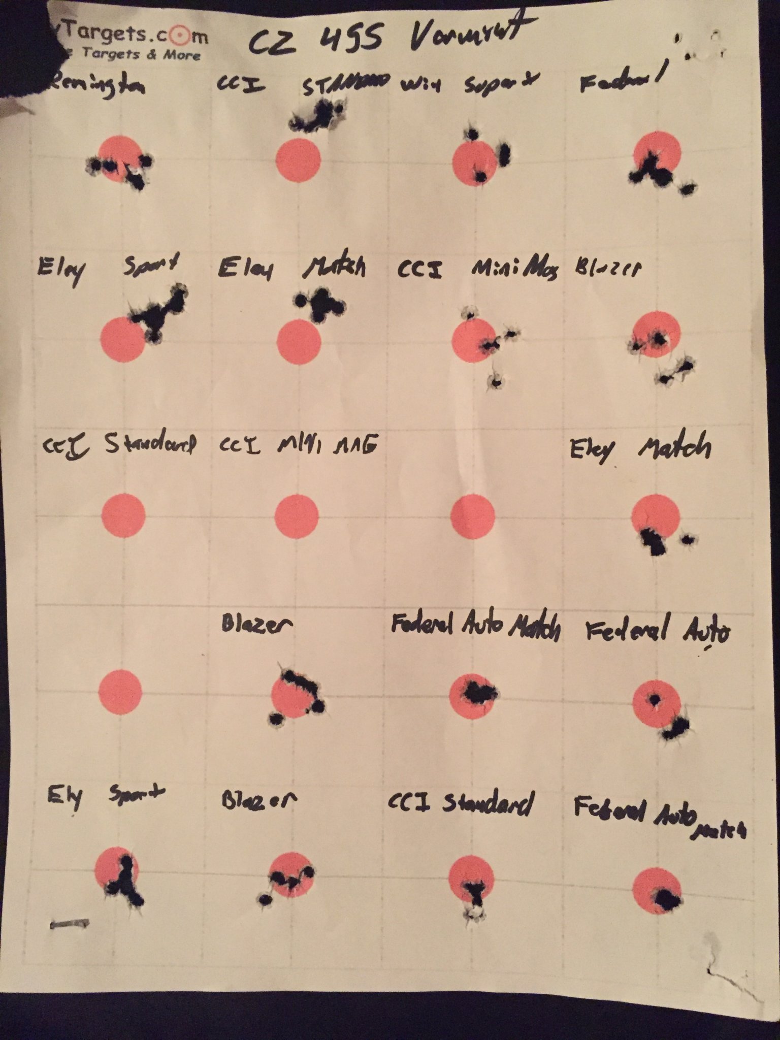

Fed AutoMatch? The cartridges packed loose in the box? Bulk 22lr?
Jumping carp crap! I'm thinking you've used up y'er ammo luck for this year.
Chances of getting a good batch of Federal made 22lr is slim.
Federal contracts out it's match ammo to RWS in Germany.
The rest of the line made in the US usually won't do well except at close range, 25 yards or less.
Lucky-lucky-lucky!
Reactions: Appalachained
Yes. The 325 round box. This is the first shots out of it at 30 yards. I didn’t know back then about leading a barrel or at least running a patch through between different Ammo. It’s the only target I could find a pic of. You’re looking at the first 80 rounds through the rifle. I later, after getting better at shooting, put up four, five shot groups with Federal AM that measured .35 -.40 @ 50 yards and can do it pretty much on demand or at least I could. To be fair I have a 32 power scope.
