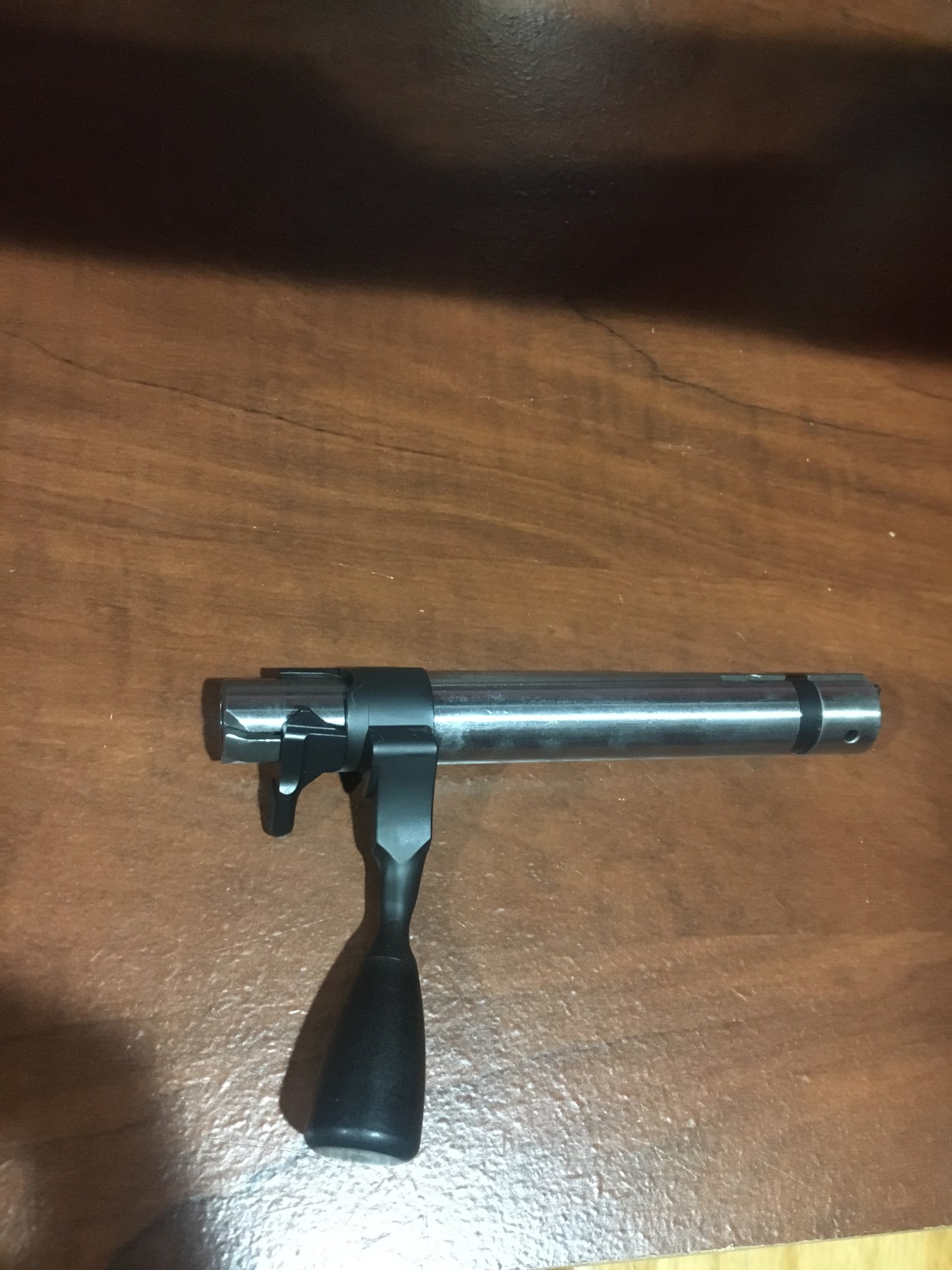

Just in case anyone is still following this post... I ended up sending my bolt to (fastford) one of the members on he recommended him. So I contacted him and went from there. After talking with him on what I was looking for he sent me some pics of different size bolt knobs that he has and this is what I ended up with.
FEFC671D-E0F4-49A1-BA01-13C3599417FE.jpegBC3620B4-9219-4F2E-B825-53A76B6D5B73.jpegC395E42C-335E-434E-A6CC-A992766A704F.jpeg
If you don’t like the bolt knob I chose he does have about 6 different ones to choose from. He did great work and great communication.
