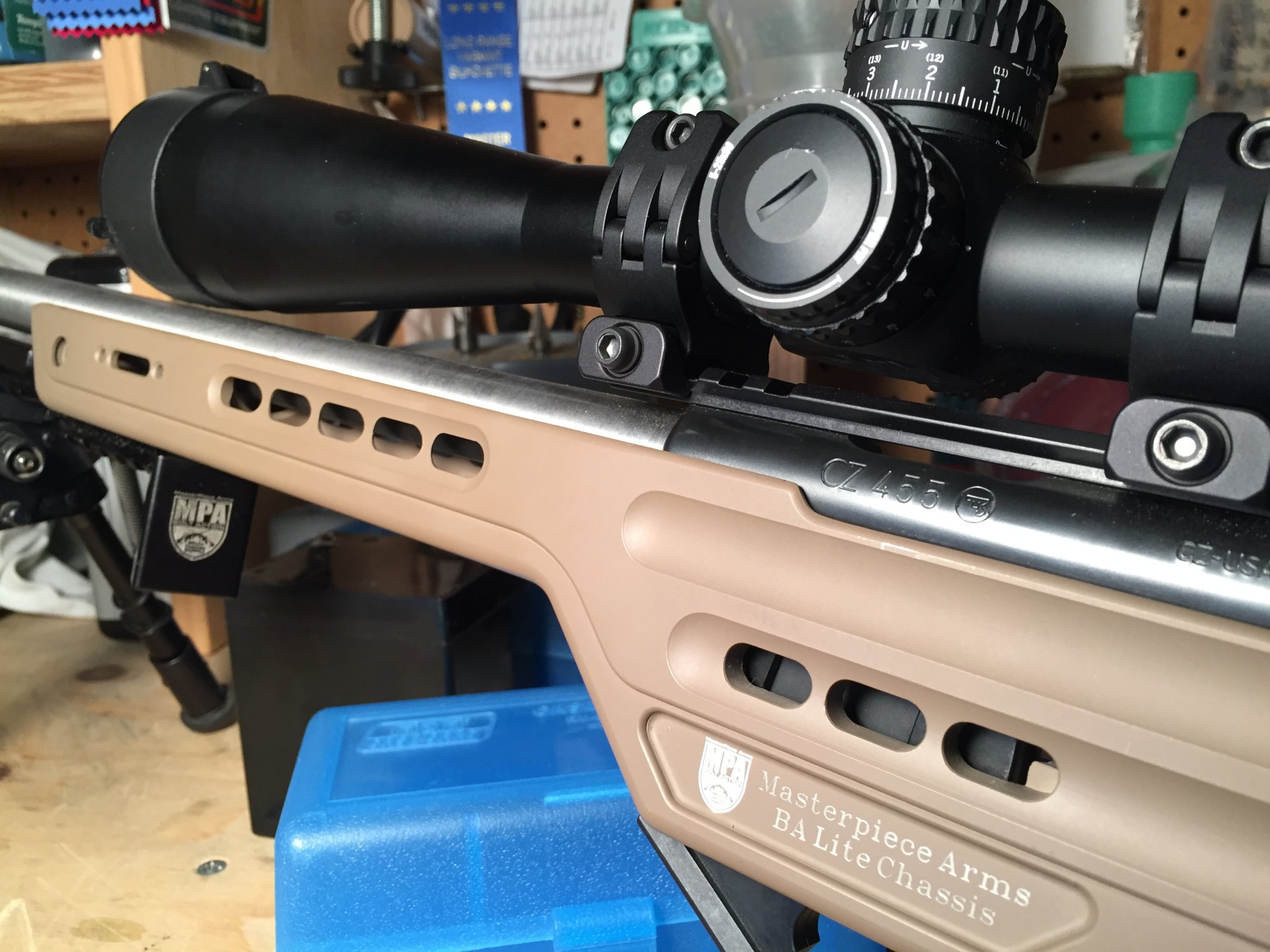

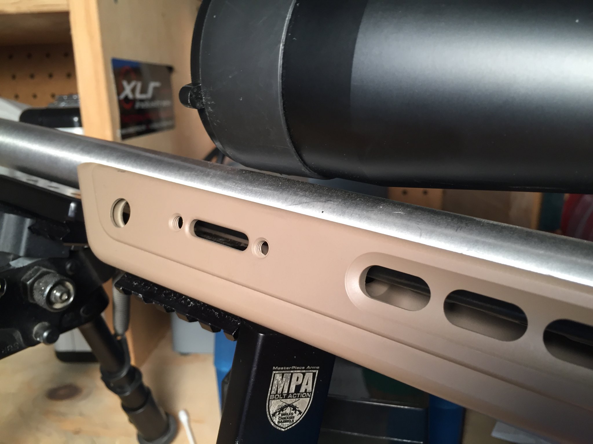

I don’t have a 30mm to help, just a couple 1” and a 34mm I haven’t mounted yet. That being said. The guy I purchased my CZ in an MPA stock from had Seekins low and a 30moa rail with a PST GEN2 3-18 and the bolt knob could not clear well.

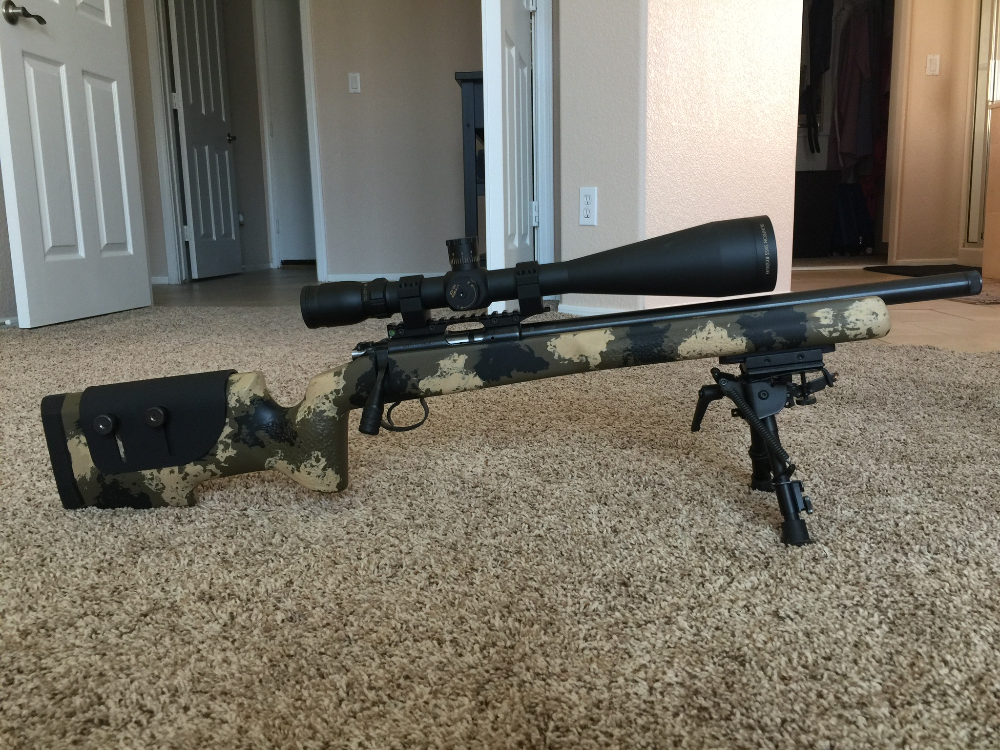

I have a Sightron SIII with 60mm Objective and Area 419 Rail and Vortex Med. Precision rings and have clearance so I would think med ring with a 40mm objective would be ok.
