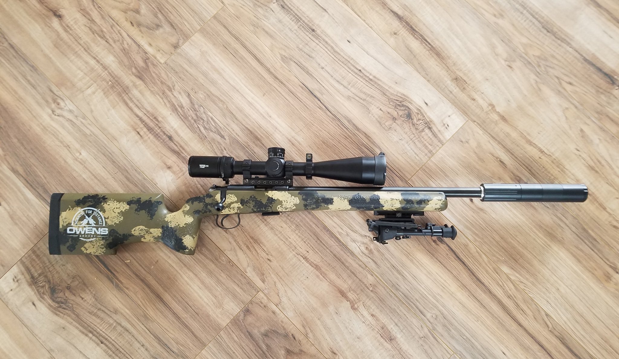

hi guys newby here. waiting on my new cz455 msr and ill be putting a bushnell elite 6-24X50 ffpg2 on it. curious what rings or mounts u guys would recommend that are available to get in Australia? cheers for your time fellas.
Hmmmm...this is a tough one. Good question. Here is a pic of my cz455 w/ 20moa egw base, medium vortex pmr rings, and a 30mm tube, 50mm objective. Clears bolt just fine. High off the barrel tho

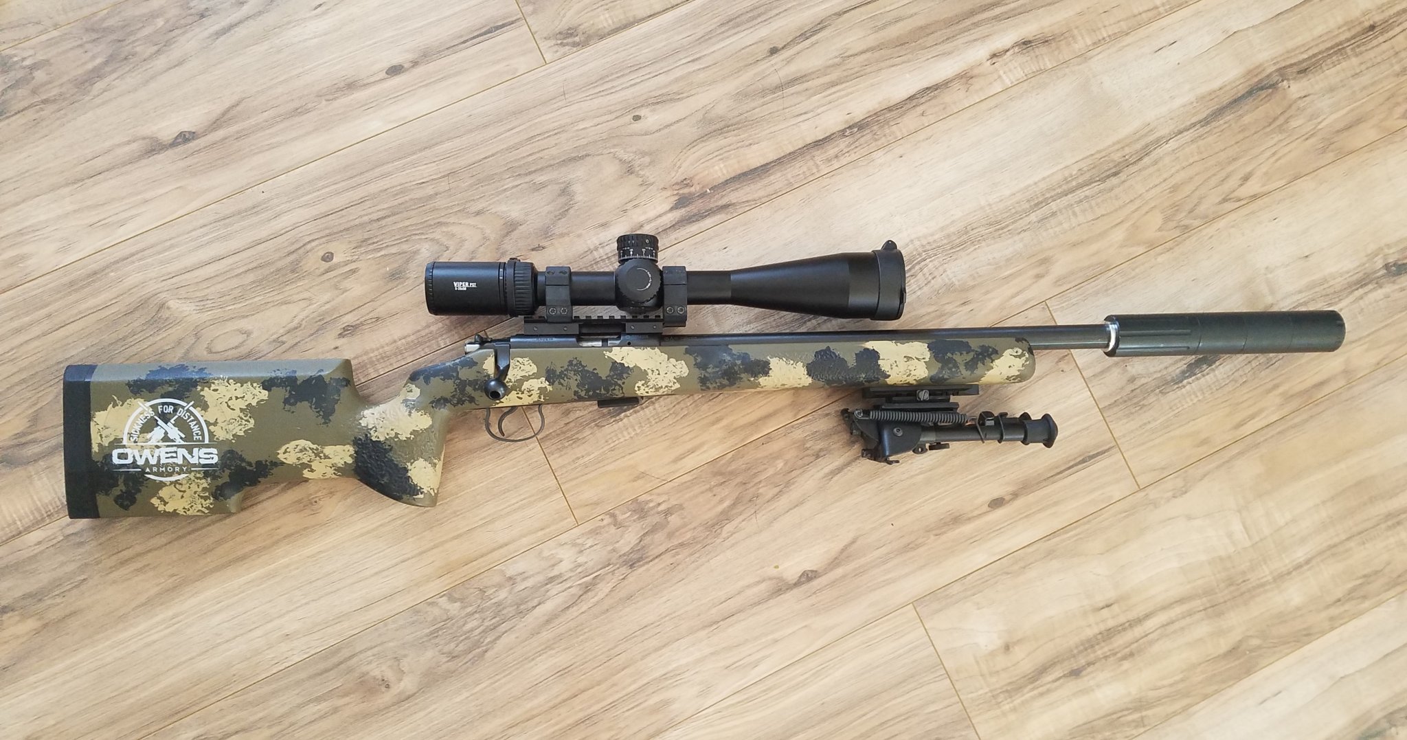

...another direction I went was more for elr 22 stuff. This pic is WITHOUT egw 20moa base but instead a BKL adjustable pellet gun scope mount. Since it lifts the rear ring portion up when adjusting the base itself (BKL 120moa adjustable 30mm base w/ 11mm dovetail) but leaves the front as a fulcrum, I am able to clear BOTH the barrel and bolt w/no issue. The base was a little over $100 and has been an affordable upgrade providing max internal come-ups alond with entire hold range. Happy camper here.

beautiful thanks mate that looks like it might just be what im after. ps mint looking rig ?
