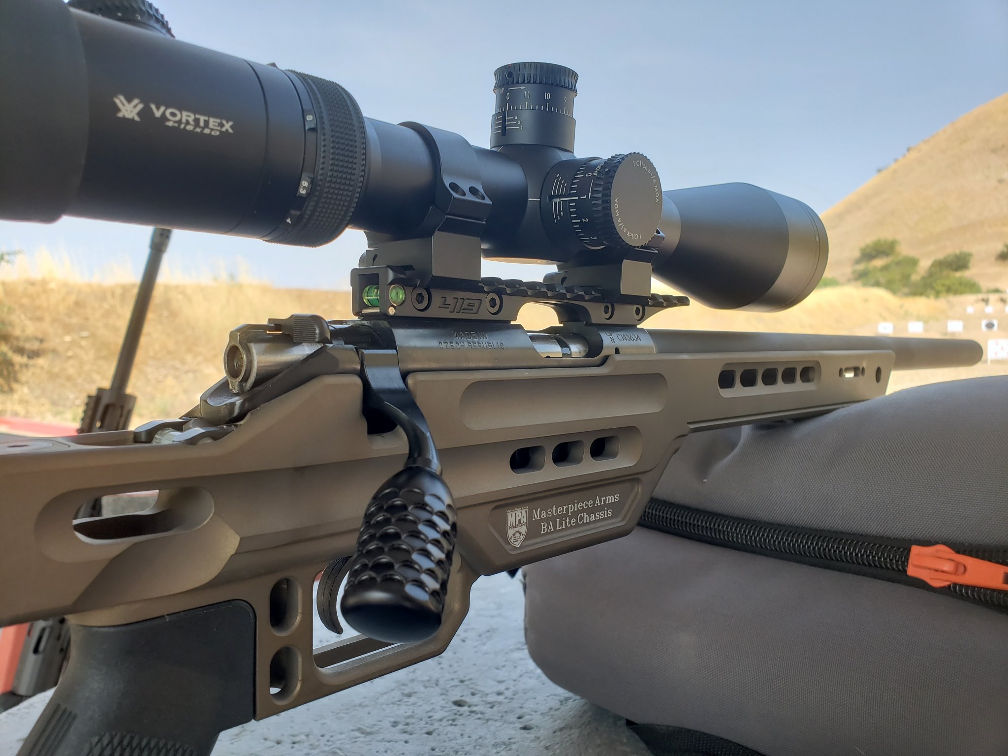

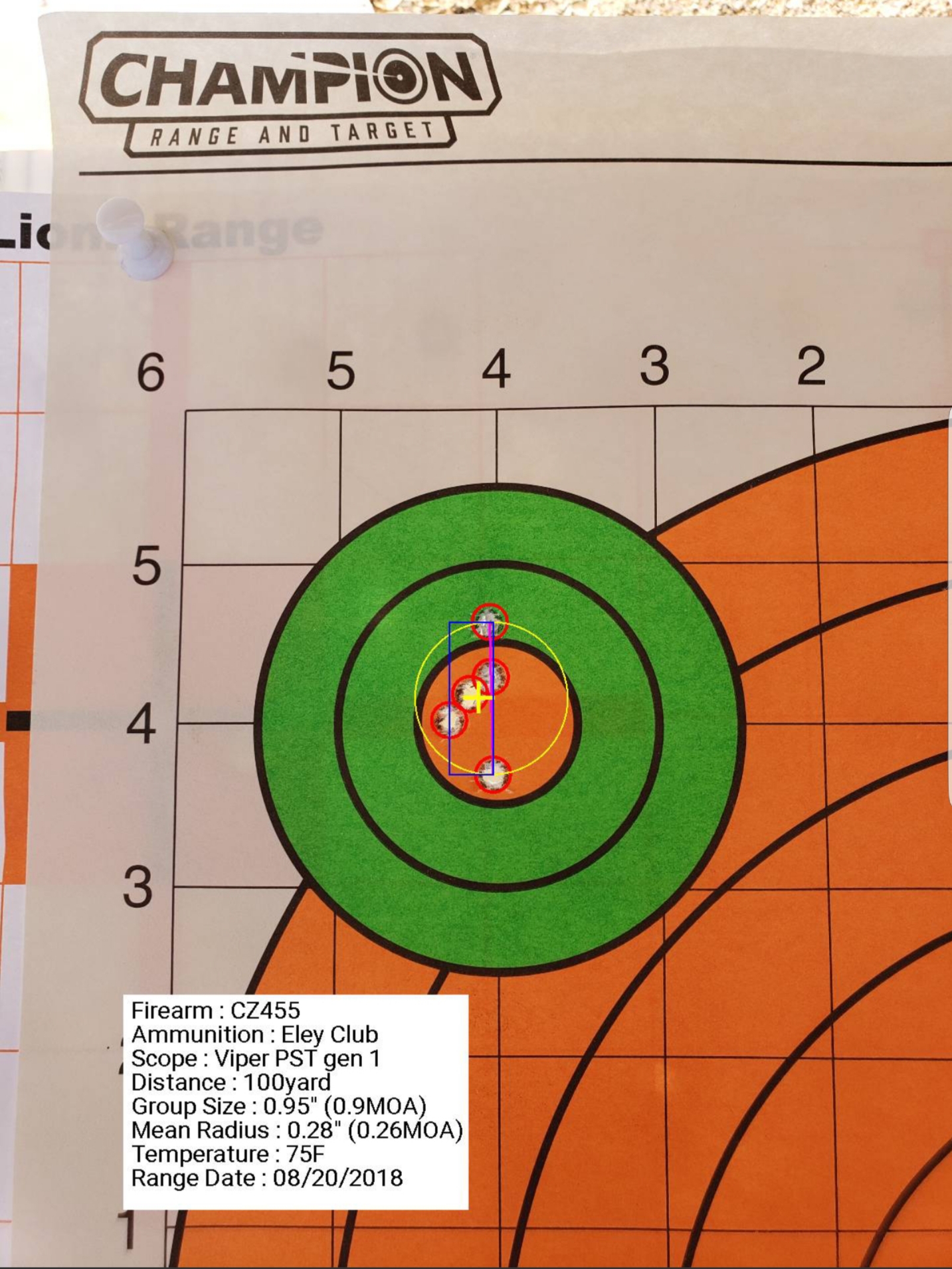

There didnt seem to be much recently on this barrel for the CZ so I thought I would post what I've gotten so far with it. This was the first outing with it to test function since I replaced quite a few parts. Got the rifle cheap so I wanted to have fun with it. It started life as a never been shot Lux.I used Ely Club since its been reliable in the past with my 10/22 and not expensive. I have an assortment of different ammo to start seeing what it likes that I hope to test soon.
The rifle is a CZ455 in an MPA chasis, Aera 419 30moa rail, Gen 1 Viper PST in cheap Leopold rings (old rings to test bolt clearance) anarchy outdoors bolt handle with knob and whistle pig 20" barrel. Trigger is still stock and it was shot off a bag at 100yrds. I was hoping for it to be a moa shooter at 100 yrds and so far it looks to be the case. It's a big step up from my 10/22 at least.
