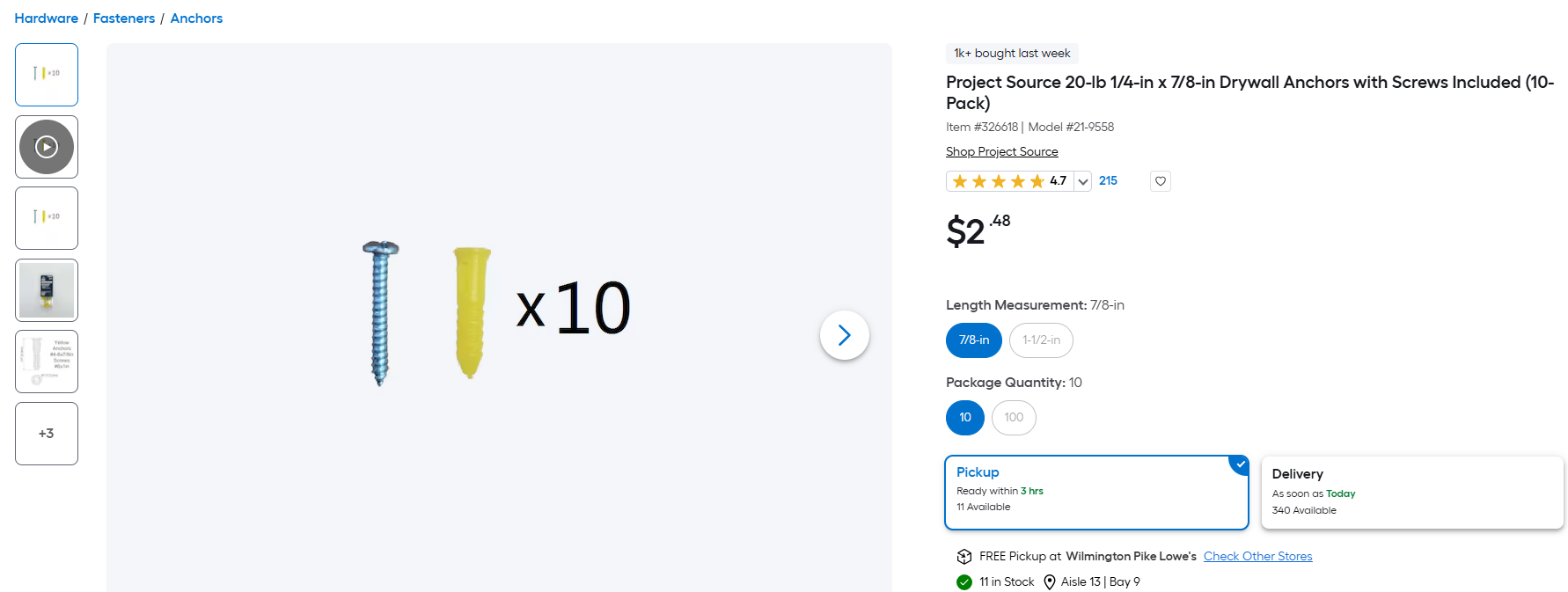

The yellow dry wall anchors work well and can be loaded into the magazine to practice positionals (ie: not put pressure on the magazine) and cycling the action (ie: CZs likes to be cycled with some oomph).
