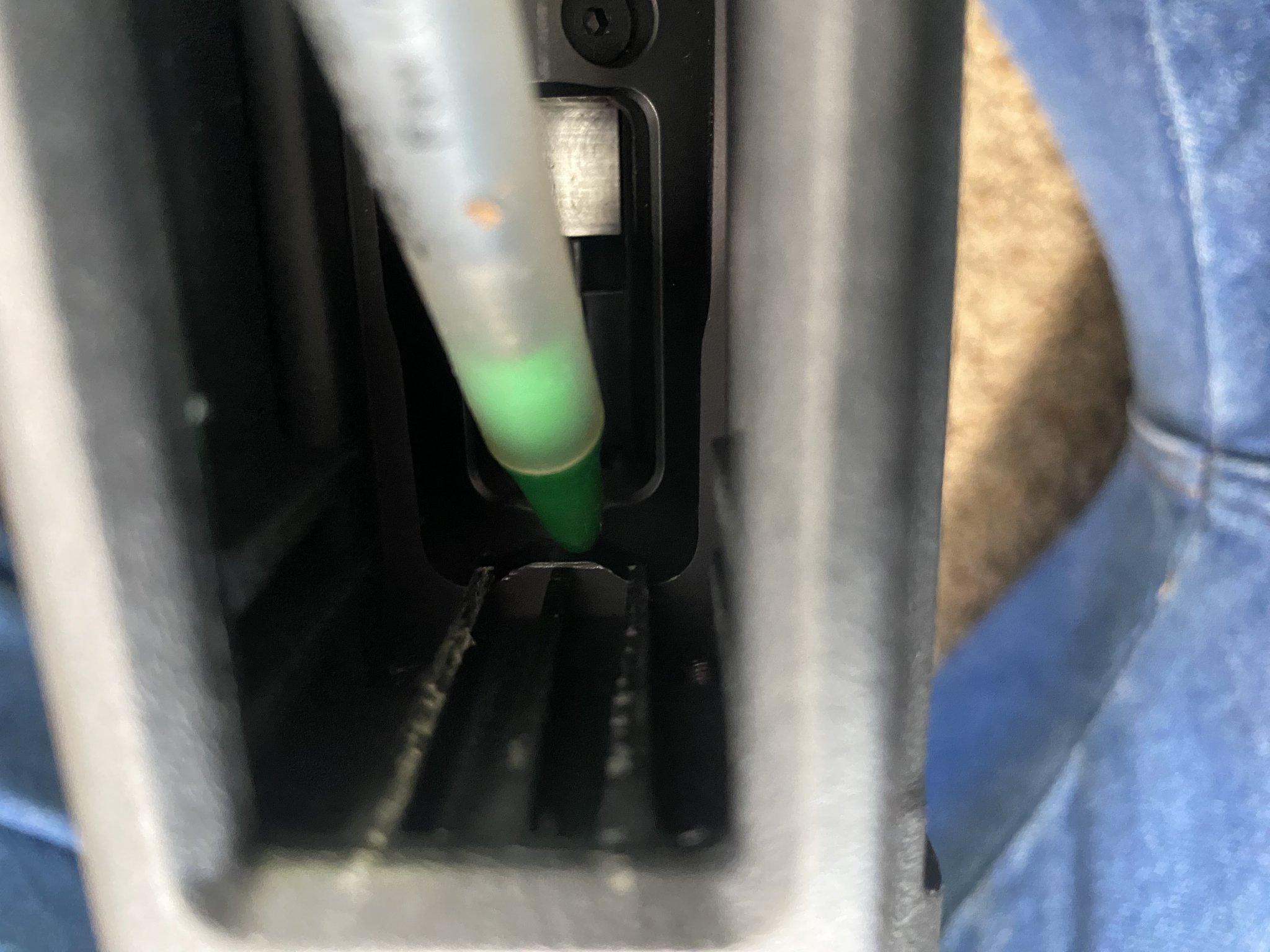

I have a Vudoo 360 in a whiskey 3. The forend mag well has maybe 3/16” of travel. Loosen the forend and push it towards the rear until it’s snug against your magazine. Make sure the three slides on the front of the mag well are flush or past the mag well of the chassis. I’m pointing at it with the green pen. That could cause your mag to hang up if not adjusted correctly.
I would buy the extended mag catch to have on hand just in case. After your mags get broke in, you might find it more reliable. I noticed when I dropped the Vudoo in my other w-3 with the extended mag catch set up for my 6.5 with AW mags, it tightened up the slop of the mag well.
Hope this helps someone.
Thanks, i'll give it a go.
