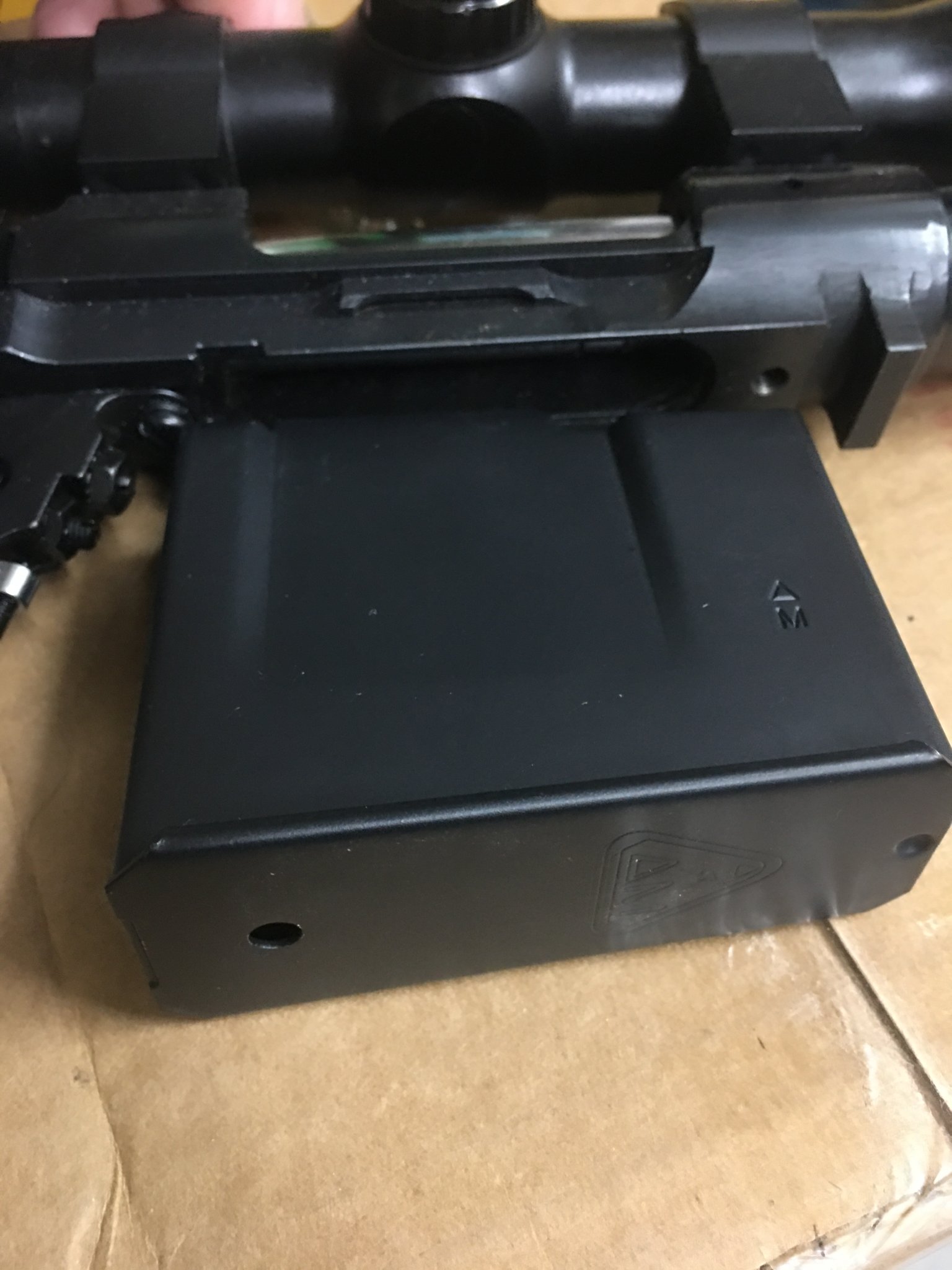

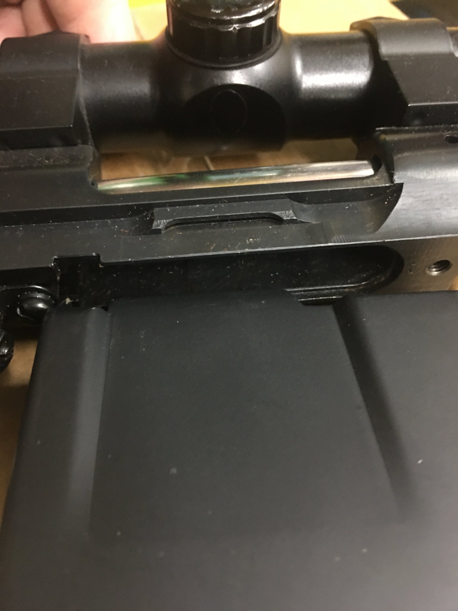

CZ527 and AICS mags
I’ll say it, not gonna happen.
AICS 223 magazine isn’t going to work for feeding a CZ527.
CZ 527, you’ll lose front action screw and/or screw that holds trigger in place to get AICS in receiver.
Additionally, magazine is wider than receiver at mag cut out.
Put AICS mag by Howa Mini and have similar but different issue.
You’ll lose feed ramp on front.
Move mag back, you’ll need to start hacking on part of the trigger assembly.
I don’t see either the CZ 527 or the Howa Mini being able to utilize a AICS type 223 magazine.
Maybe a Borden Super Short AICS type mag but the AICS 223 is just too long to fit in available space.
If you can shoehorn in a AICS mag to either action, you have better skills than I.
Yep, the well on the howa is wide enough for lips on metal mags. I’ve resolved the length issue with the Howa by using a spacer at the front of the mag, still working on the follower, as getting to feed reliably has been a problem.
Ahhhh, modify receiver and modify magazine.
I’ll probably just work on making better magazines for the Howa Mini, not willing to sacrifice AICS mags to feed Howa mini action rifle.
Wellllllllll...... i might have something for you. Came across it randomly. I love the Howa actions, one of my favorites. I was stoked when they annouced the mini actions and 6.5 grendel was one of the calibers as it is one of my favorites. Hell it is the caliber i built my first AR15(which i really need to get around to posting a thread about in here). But i was so bummed when I saw the weird plastic mags and front mag release. As long as you arent using a chassis, there is an option. The only thing is i dont know how viable it will be in the future as CZ is discontinuing the 527.
Howa mini to CZ 527 DBM
