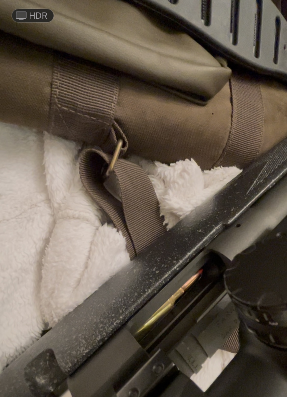

I’ve got a Dakota 76 actioned rifle that used to be a 22-250 but been rebarreled to 6.5 creedmoor.
It’s a floor plate mag. Hornady ELDX 143gr shoot lovely but jam nose to tail in the mag.
I’ve now moved to Hornady 129gr SST which don’t jam but when you stack 4 in the mag the rounds sit slack at the rear and tight on the shoulder.
This means the bolt can miss the round and not feed it into the chamber, just push it back under.
Can this be fixed somehow.

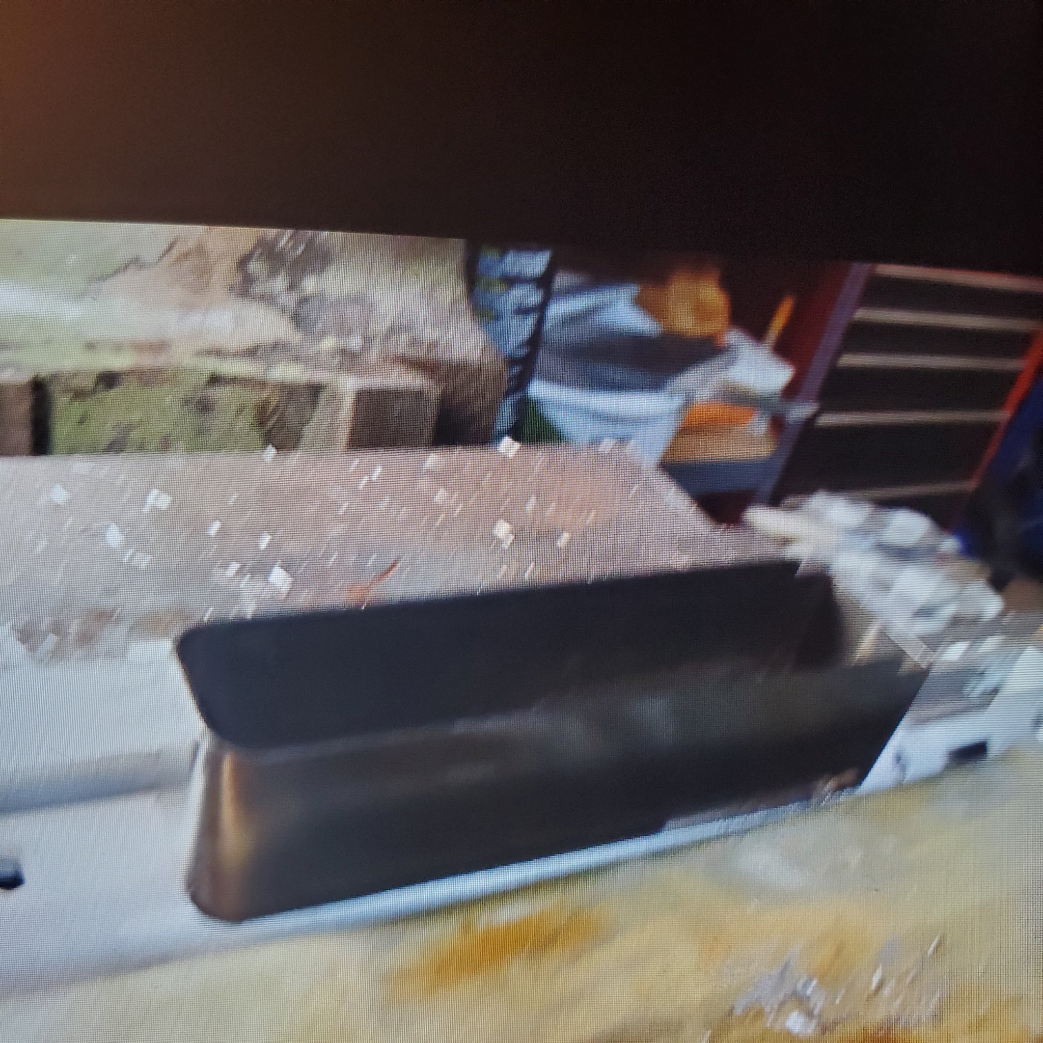

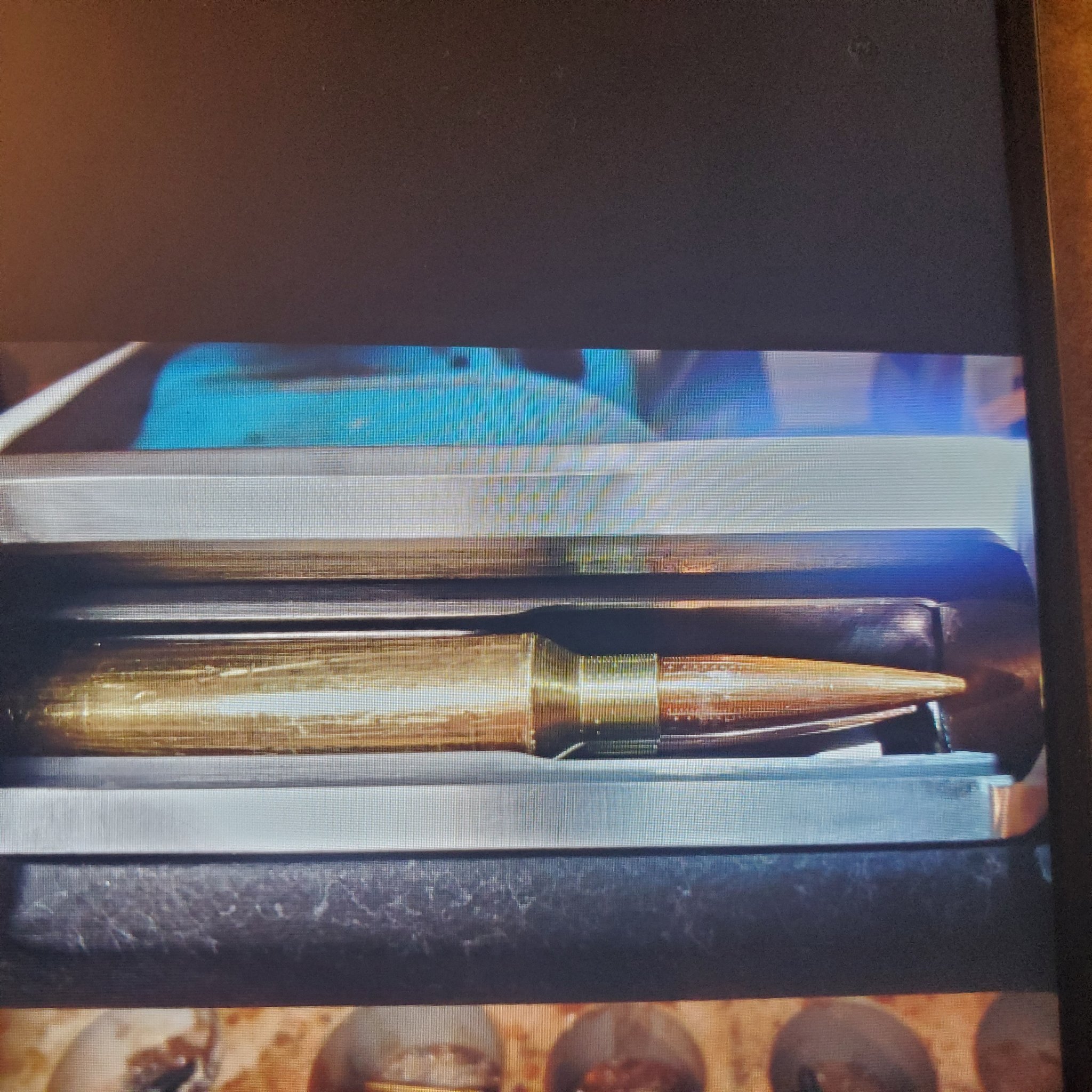

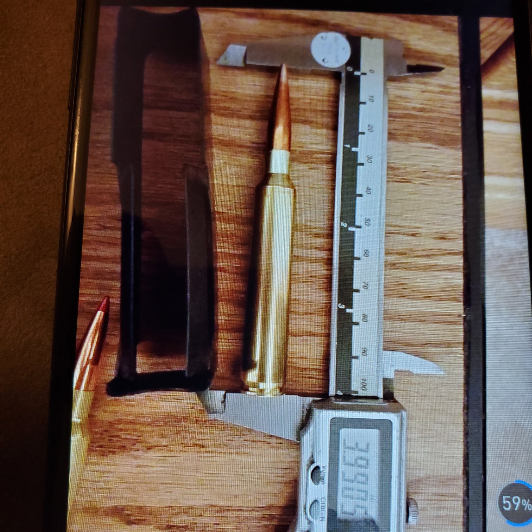

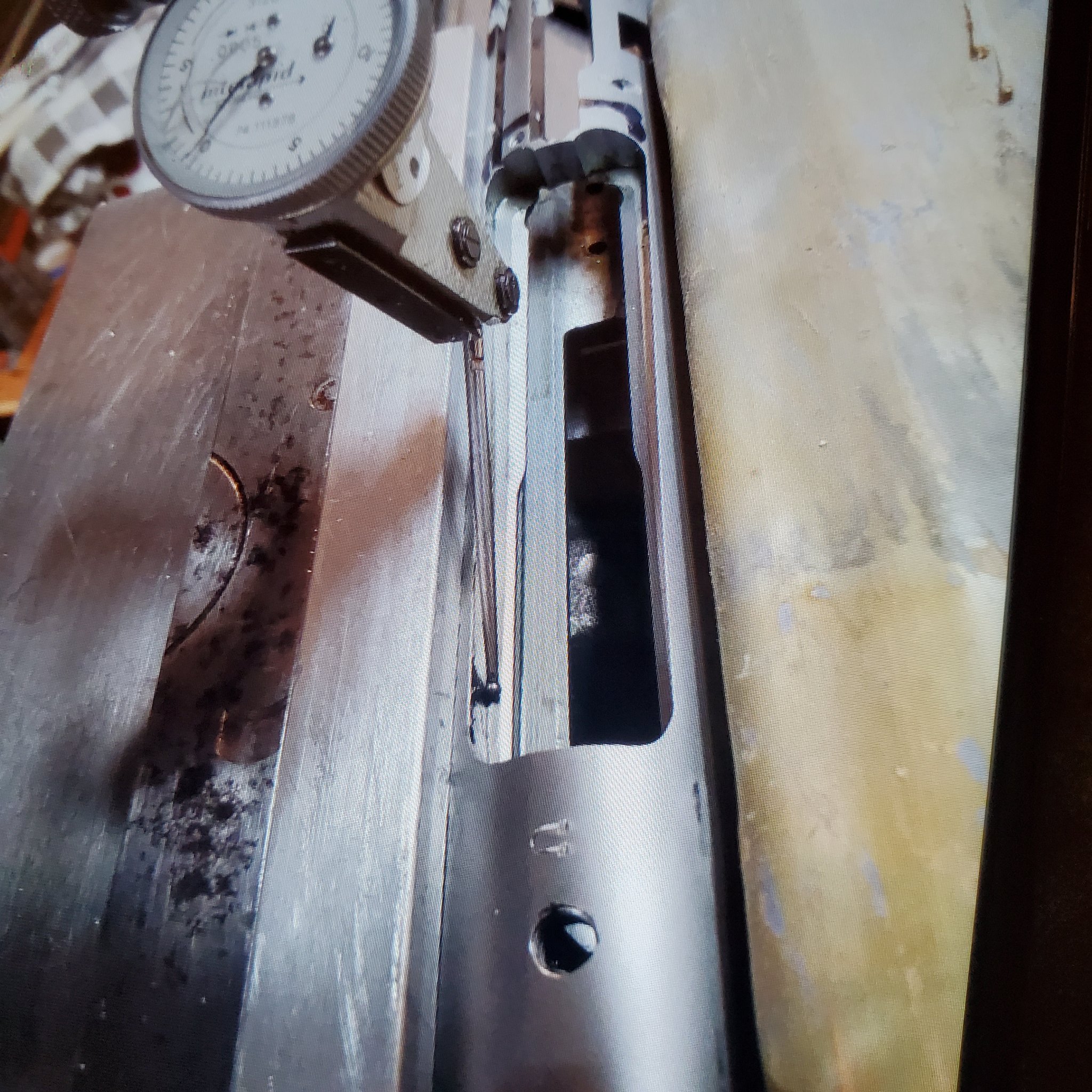

Here are pics of how I did mine... order Wyatts mag box, follower, and spring.
Indicate action, lead sheet to protect finish and machine aluminum V vise jaws.
Machine bottom of action to fit new mag box.
Turn action over, indicate in, and follow all factiory contours, indicating each angle.
Machine 1/4" off the rear bridge the top of the action, indicate and follow factory contour use correct factory radius on your carbide end mill.
Machine bolt stop back to get bolt back far enough to pick up 4" cartridges.
Install and adjust as needed.
Just measure, and machine as needed to complete the job.
A good Bridgeport mill does a great factory like job... not many own one, but a good gunsmith or any machinist can do this job.
