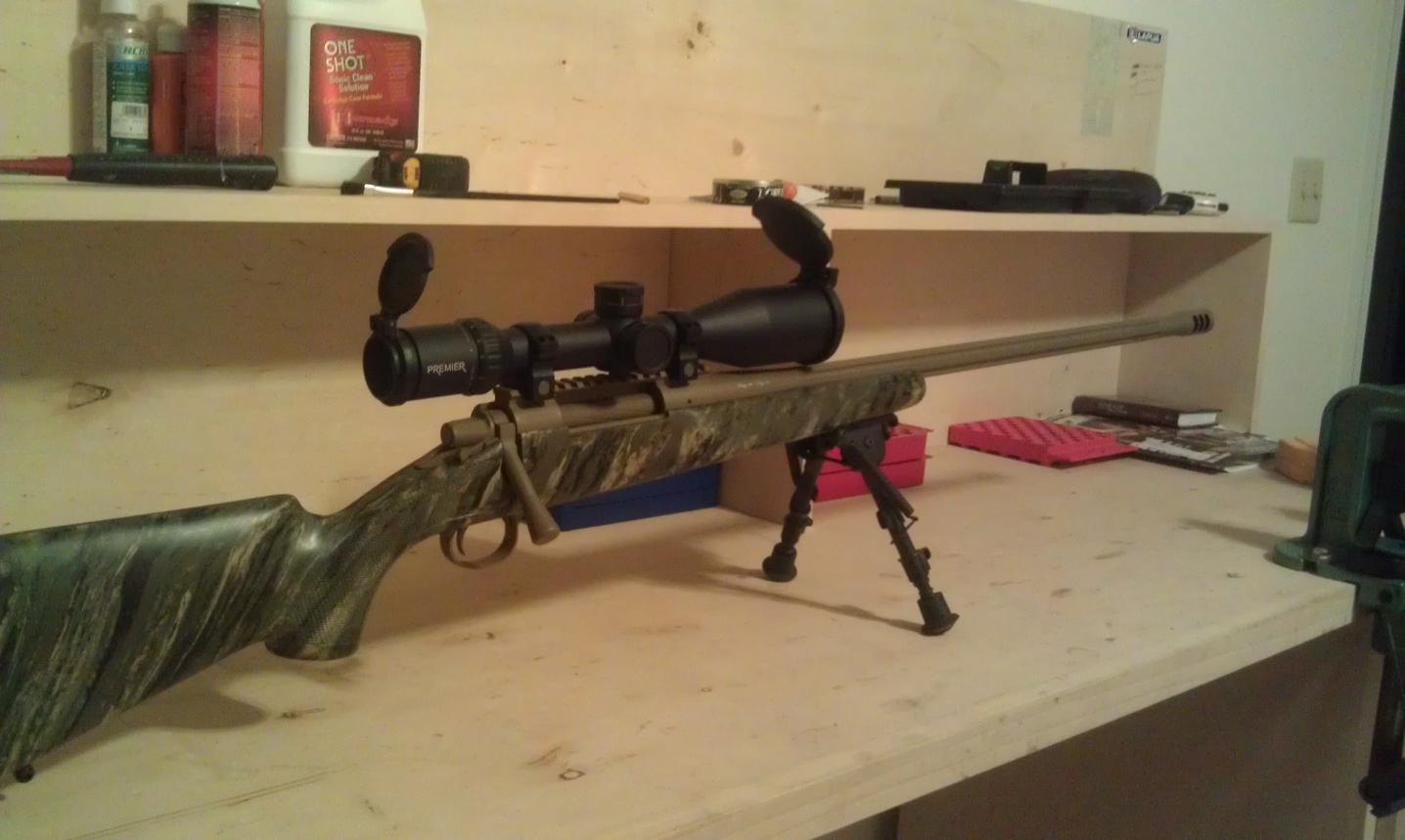

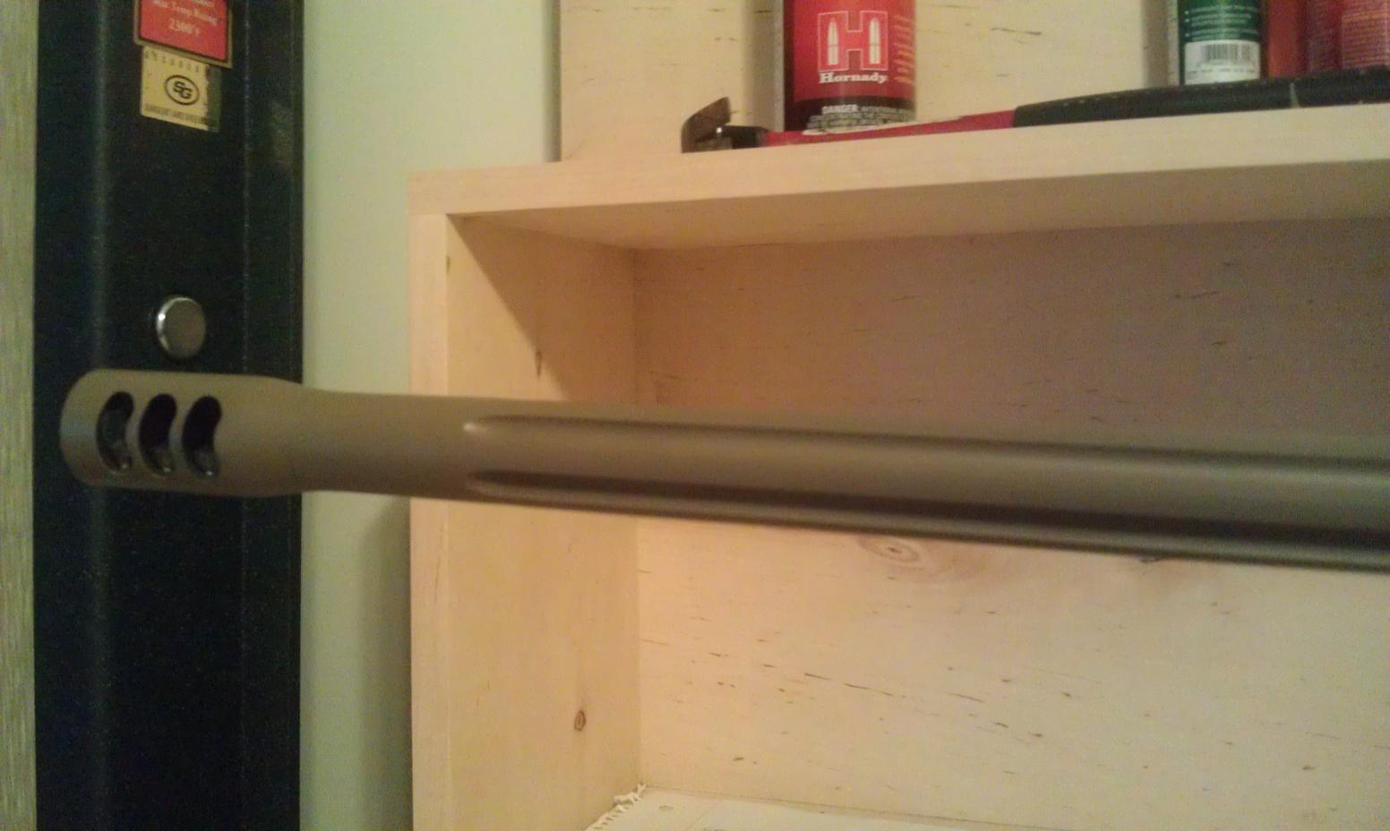

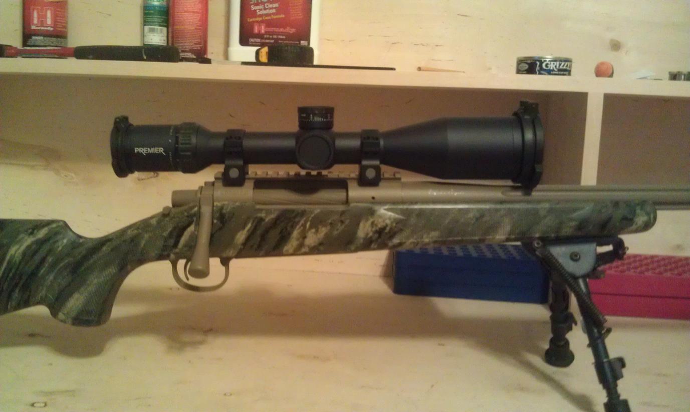

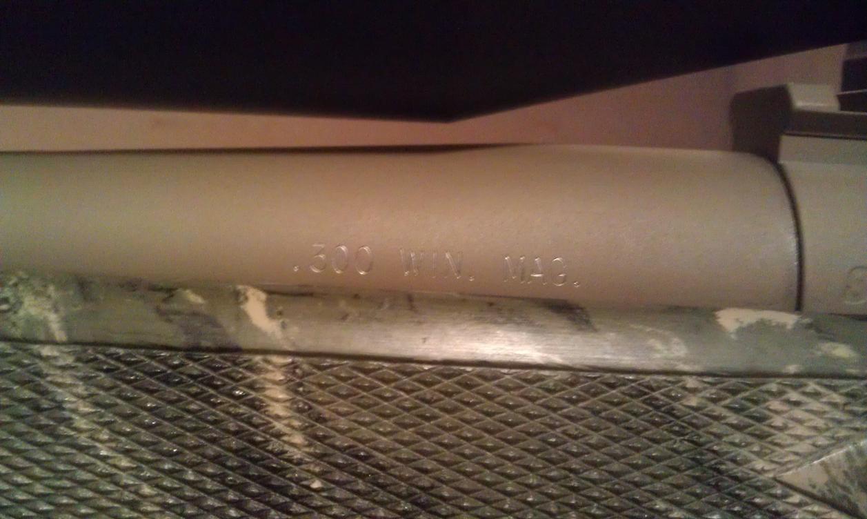

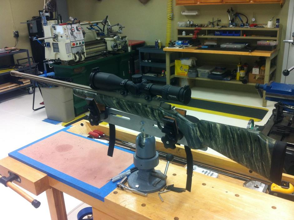

I just recieved these pics from Mr English and wanted to share my new 300 win mag hunting rifle. I want to thank: Stockys, Southern Precision Rifles (Bugholes), Kampfeld Custom, APA, CS Tactical (Mike) and Dana English for building my dream hunting rifle. I also need to thank Bob L Swagger since I copied his badass looking rifles with the Olive Marble stock and Flat Dark Earth Cerakote. Hopefully, Dana will recieve my Bat Tactical action soon for my 6.5x47 build. Dana has been great throughout all of this and comes highly recommended by me and Robert Gradous. I will post more pics when I recieve the rifle. I bought all of the parts and had them sent to Mr English. Parts are:
26" Bartlein Sendero Contour 1-10 twist
Surgeon 1086 with Mag Bolt Face action
APA Little Bastard Brake
Jewell Trigger @ 2 lbs.
McMillan Remington Varmint stock (Olive Marble!!!)
Premier Light Tactical 3-15x50
Nightforce Ultra Light Rings
Remington 700 Aluminum Hinged Floorplate

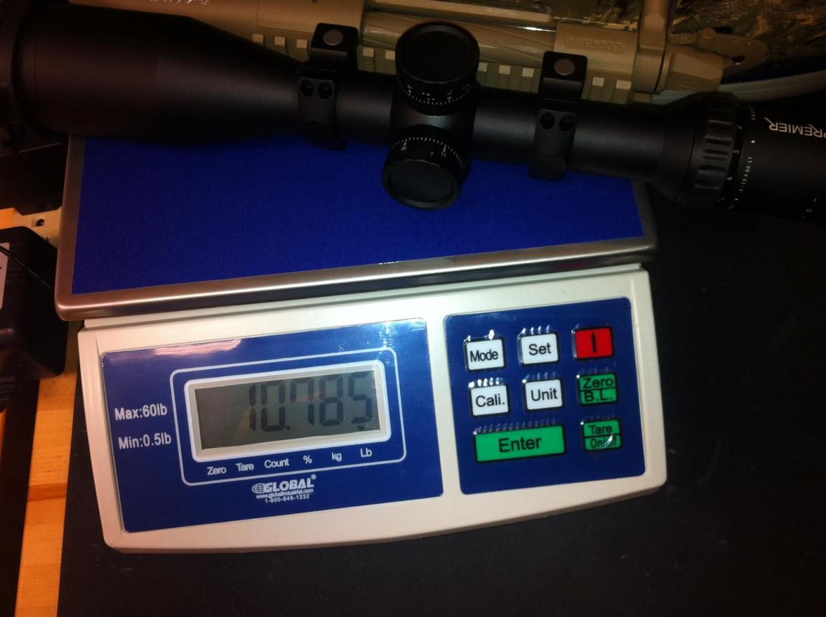

The rifle checks in at 10.785 lbs as pictured, which I am very happy with.

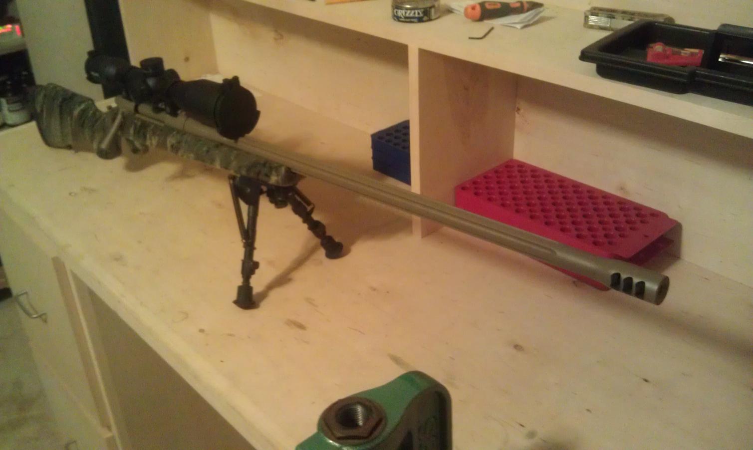

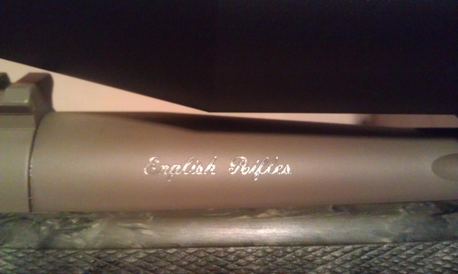

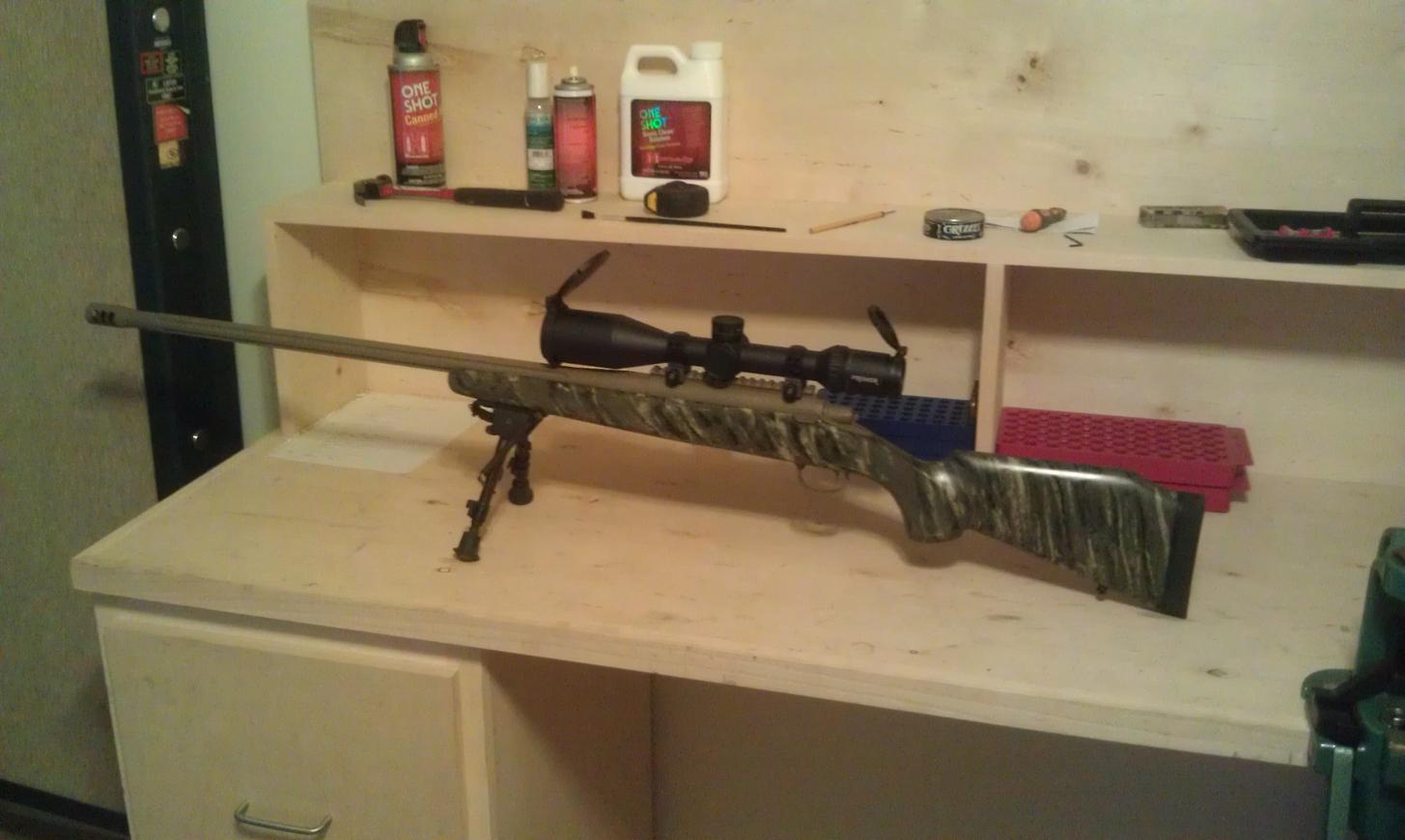

Just picked up the rifle this afternoon. It was getting dark but I had to shoot it. I can't believe how little it kicks, especially weighing in less than 11 lbs. I will shoot some groups Saturday morning and post up the pics. These are from my phone, so apologize in advance for the quality.

This Premier Light Tactical scope is awesome! I am very happy with this rifle and scope. Mr English really did a great job with this.

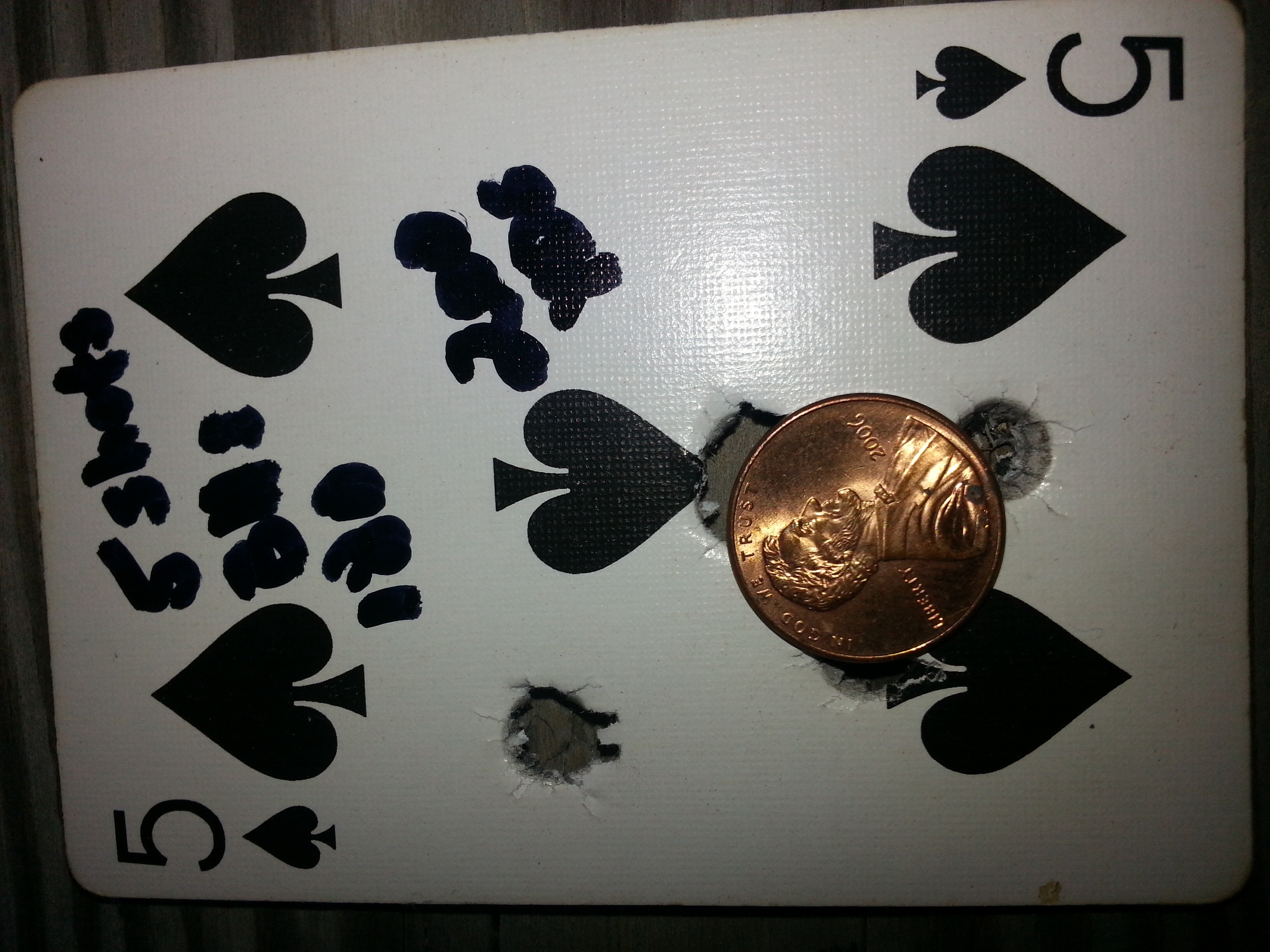

You are not allowed to hunt with a rifle in my county unless your 8' off the ground. I may or may not have been 8' off the ground. I was in a hurry to get my does so I didn't get any pics. As for the rifle, no pics of groups there either. What I did is load up 10 rounds of 208 AMAXs at 3.612 (Dana's suggestion) at loads of 75-76.4 in .2 grain increments of H1000. Granted, I haven't shot any of the 75, 75.2, and 75.4 grain rounds yet, but it seems like they all shoot the same. Shooting 3 shot groups, usually 2 holes are touching and a third is 1/2" to the right. I thinking its me. I just cleaned the crap out of the barrel and couldn't believe how much copper (blue) kept coming out on the patches. Dana said he shot it 14-16 times and cleaned it and I did the shoot - clean, shoot - clean, shoot shoot - clean for probably 20 rounds. I am sure the barrel is broken in. I did shoot my 76 grain H1000 load through the chrony and got an average of 2780. That load used to shoot 2830 out of my Gradous 300 win mag with the same 26" lengthed barrel. I guess the speed will pick up with more shooting. Anyway, I know the rifle is capable of one hole groups but the shooter needs to do his part. I will post some pics once I get those one hole groups. Have I mentioned that the Premier Light Tactical scope is AWESOME?!!!!
