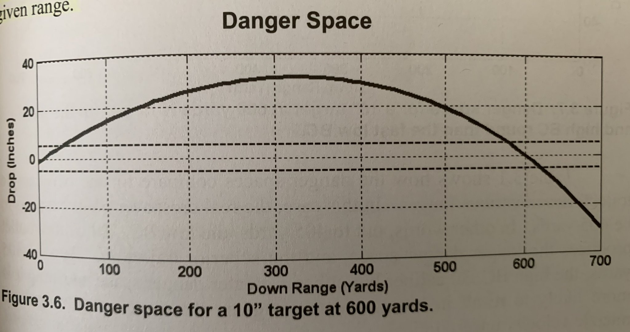

I know most of the top guys in PRS/NRL are shooting 6mm so I was curious how it stacked up against the 6.5cm when it came to danger space (DS). I ran calculations for both rounds (Hornady 108gr ELDM & Hornady 140gr ELDM) on ballistics calculator and checked DS at various distances. If I did not completely screw it up, I found that the 6mm had a larger DS up to about 375yds, where the 6.5 then took over.
If this is in fact the case, I'm wondering why so many guys are running the 6mm, especially considering wind drift is greater with lighter round. Is less recoil and faster re-engagement of target what is driving it? Love to hear from anyone, especially guys actually shooting 6mm in matches.
If you run calcuations and came up with something different, please feel free to correct me. Thanks
Edit: **Please note that these calculations were run in two different apps (first in Ballistics AE and then JBM Solutions) and came up with different solutions. May have been user error on my part. Please see below thread. Apologies.
I ran JBM's "Danger Space" calculation for a 6mm 105gr Berger Hybrid at 3050fps vs a 6.5mm 140gr Berger Hybrid at 2900fps (both these are common loads), and the 105gr had a ~2yd wider "Danger Space" out to the 1000yds that the app solved for. So I'm not sure on your claim that a 6.5mm has a wider "Danger Space" than a 6mm.

Okay, thanks for double-checking my work. I certainly don’t want to mislead anyone. I used the formula that Litz gave in AB book (zeroed at each 100 yd mark, set max range for 100 yds past zero and calculated using 1yd increments). Based it on a 10” target and looked at 5” drop in front of and behind zero. Where did I mess up? This was my first time doing this.
Note: I used 2960 fps for 108gr and 2710 fps for 140gr - what I found on Hornady site. I think that was with a 24” barrel.
I don't know where you messed up as that method sounds correct and is similar (the same?) as the JBM Ballistics app. If you want to try the JBM app, here it is:
Just make sure you check the box "Include Danger Space" on the bottom.
Okay, thx. I will check it out. I used the Ballistics AE App.
Caffeine, hangover, wild night, lack of sleep, poor fundamentals, etc is the biggest "danger space" no cartridge will makeup for wobble during positional shooting. The meat and tatters are 400-700 and almost everything out there is fully capable at that distance.
Can someone explain this danger space for us less educated in terms.
one way to think about it is how exact do you need to be with your range estimation. It basically says how much error you can have in the range and still hit a target of a certain size. Typically 10" is used as the target height. You want this range to be longer. For example, a target can be 400 to 425 yds away (25 yds of "danger space") and the bullet will still hit it with one ballistic combination. Another ballistic combination could have a 405 to 420 yds range (15 yds of "danger space") and still 'hit'. Obviously, the first combo is superior.
You can solve for this long-hand, or you can use a ballistic app (like JBM above) that includes the calculation. It really isn't used very much, so don't hurt your brain over it. Generally and broadly, you want the fastest bullet that retains the most velocity - that combo is nearly always superior, whether it is wind deflection or "danger space".
I’ve added a picture below from Applied Ballistics to hopefully give you a better understanding. For the particular bullet being profiled, the trajectory “occupies the height of the target from 579 yards to 620 yards. This means that the 10” target is in the danger space of the trajectory for 41 yards (from 579 to 620 yards). Naturally, longer danger spaces increase the likelihood of a hit on the target.”
Basically, flatter flying rounds (better BC) will have larger danger spaces. However, depending on how far you are shooting and the rounds you are comparing, there is a crossover point. If you are comparing a lighter and heavier round, the lighter round with greater muzzle velocity will have a larger danger space but only to a point. That point being where the heavier round maintains it’s velocity longer and becomes more likely to hit the target after a specific distance. What that distance is makes a big difference when you are weighing in other factors, as was mentioned, like recoil, tracking shots, quick target re-engagement and the distance(s) at which you are shooting your greatest percentage of shots. Barrel life may be another factor but I’m not sure how much it applies here as I am not as familiar with differences between 6mm and 6.5mm.
