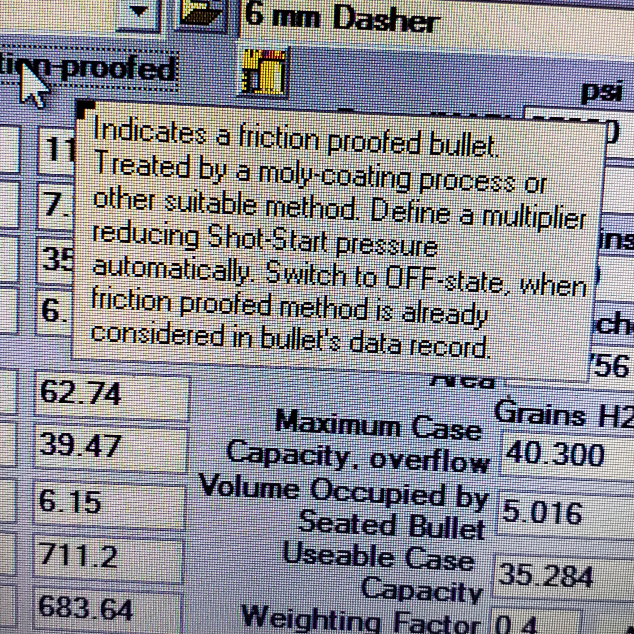

In GRT, is there an entry for a value for coated bullets? It seems to me that should factor into the cartridges overall PSI. Thanks.
QL has coating value plus several others , FMJ, solid copper, lead, jacketed, etc.
The start pressure is higher or lower depending on the type of bullet or coating as the bullet engages the rifling, where pressures can spike in a millisecond.
On coated bullets friction is a bit less so velocity will sometimes be a bit lower..so add a fraction of a grain of powder to get the same velocity in smaller csses, or more powder in larger cases.
