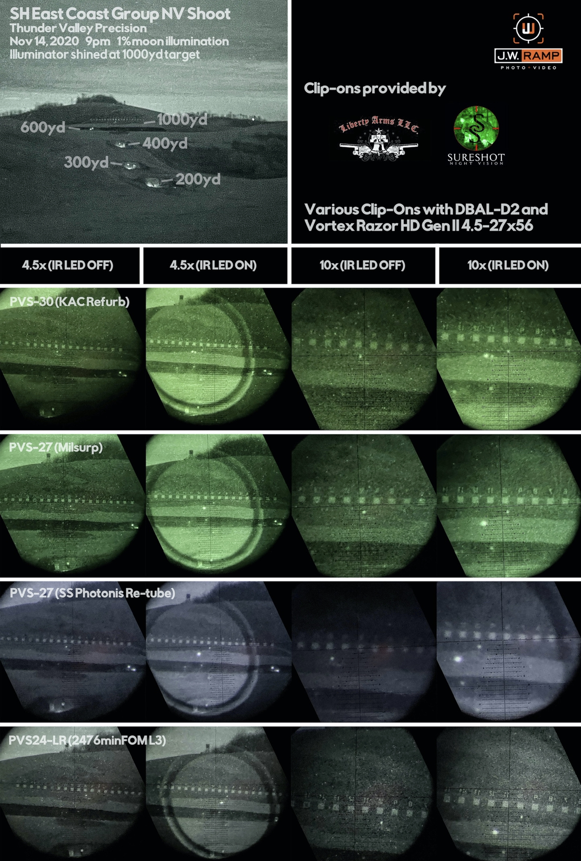

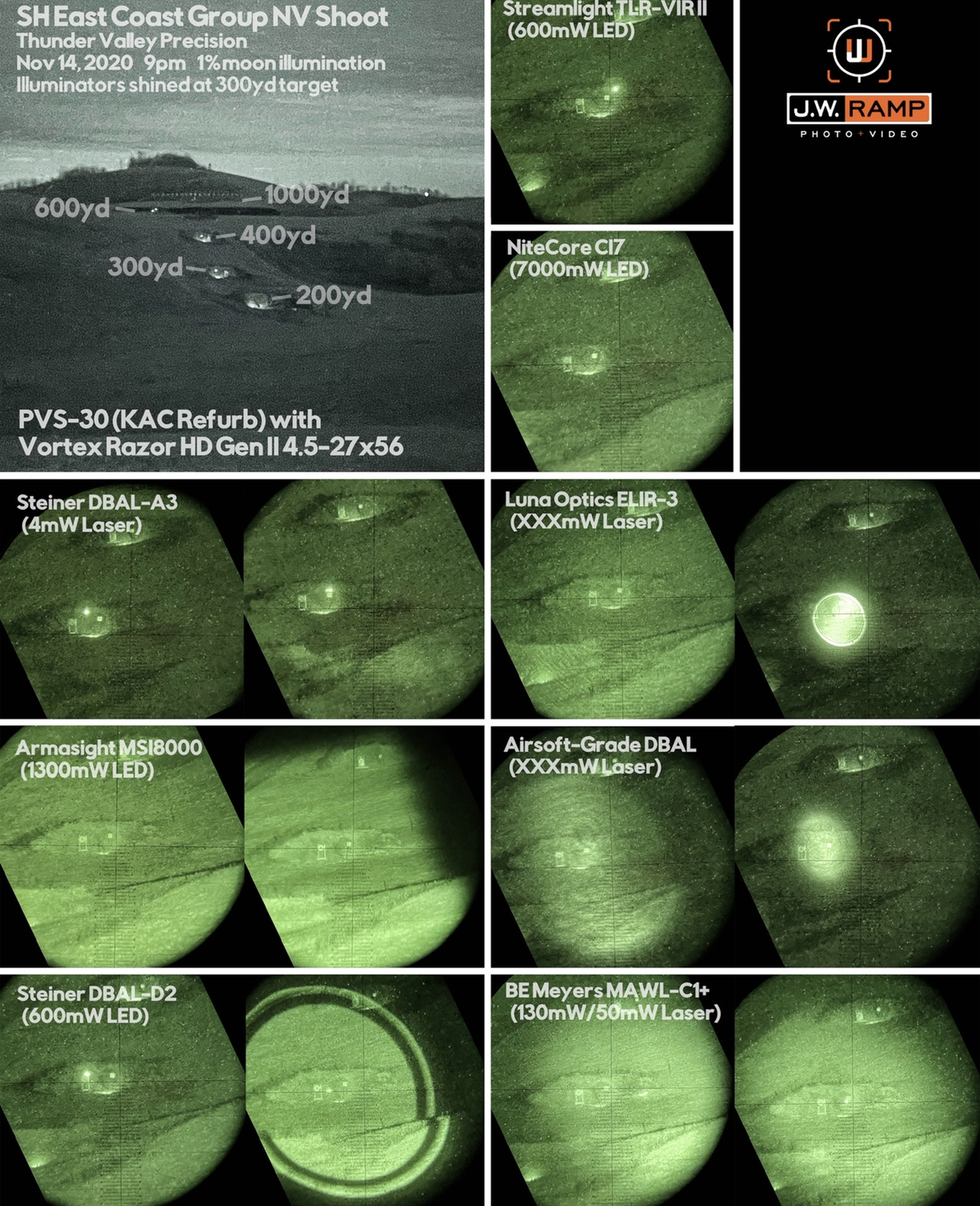

As has been stated a thousand times before, useful range for these devices depends on many different factors. Here’s a few examples from the group NV shoot we did last November, with a handful of devices at 300yd and the D2 at 1000. Very low ambient light helps greatly in their effectiveness. A big moon night, foggy conditions or a bunch of man made lights to fight against (photonic barriers) would hurt the brightness of the IR beams.
