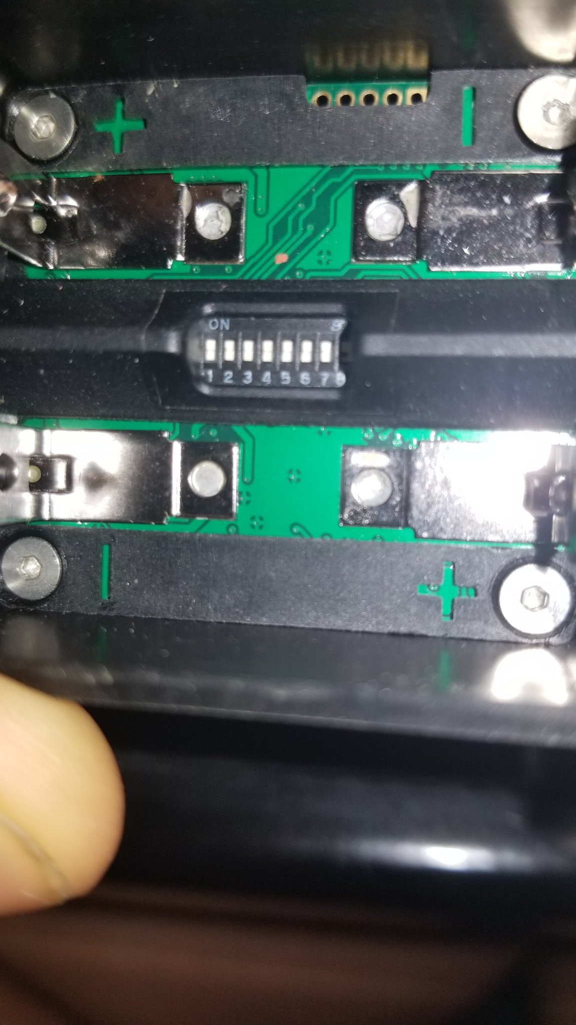

    I have a DBAL-PL and want to change the programming. My understanding is you can flip switches inside the battery compartment to do it, but I can't find a guide to know what to flip.
    Anyone have a manual you can pic that page on? Steiner dosen't have one to download.
    I was able to get a manual from Steiner, thanks for the thought though.
    Switches
    1. You get two functions, press hold and either single tap or double tap
    2. Null
    3-4. What does single/double tap do? Light, laser, both
    5-6. What does press hold (momentary) do
    7-8. Button alignment - can do V-I, I-V, I-I, V-V
