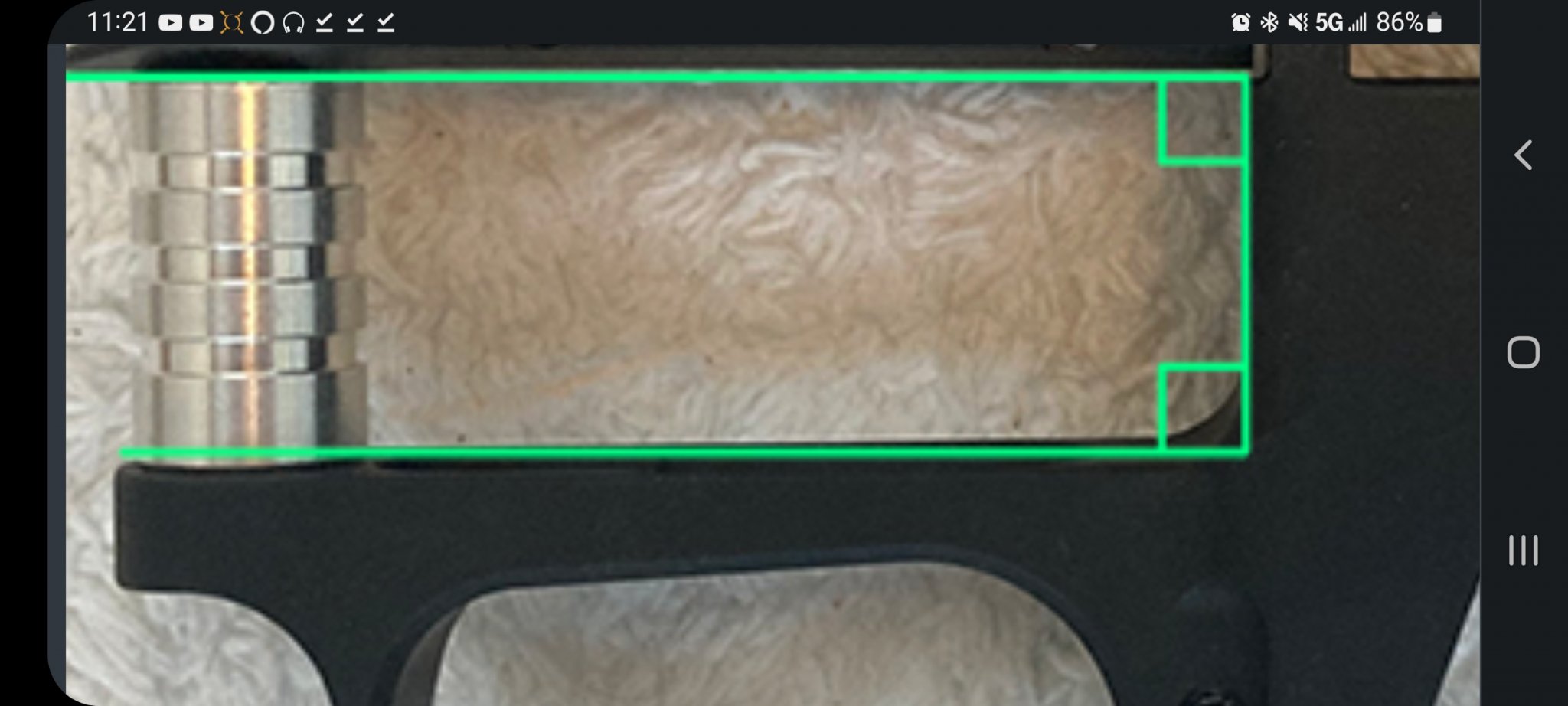

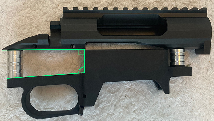

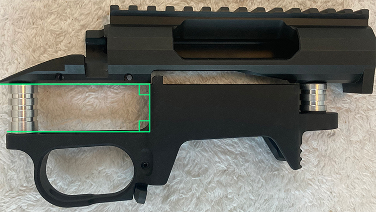

My in-progress McMillan A5 was ordered with Surgeon SA DBM inlet. I have both Surgeon DBM and KMW MK-I, Gen II DBM. I thought the two DBM had the same inlet. However, mocking them up with my LPA Fuzion action, it looks like there is a difference. Will this be an issue if my stock is inlet for Surgeon?
And even if it isn't an issue, if my rifle smith beds my action/stock/dbm for one, and I want to install the other, I'm guessing it won't work?
SURGEON:
KMW:
Given the choice, owning both, I would go with the KMW.

Yeah, the KMW looks to be the nicer DBM, having both here side by side. However my stock is inlet for Surgeon. I don't know if the different angle will matter or not. My smith will bed it either way.
I initially ordered stock inlet for Surgeon because that's just what I've always used. But then I couldn't get my hands on a Surgeon DBM, so I purchased the KMW. But then the Surgeon became available and I grabbed it just in case. McMillan told me they don't have an inlet program for the KMW...

I would pull out some calipers and measure the green boxes again. The kmw box seems off. It's more angled.
On McM and CMS inlets, both have they been working.
If you or another shop actually beds the hardware with full perimeter contact bedding, the will not interchange.
Then again if you do a full bottom hardware bed with almost any brand hardware, you will likely not be able to interchange even the same brand hardware. Machined inlets are fairly forgiving inside the footprint. Full perimeter epoxy bedding is totally unforgiving, many times within the same brand/model hardware.
Got it, thanks. So your DBM should fit McMillan's Surgeon inlet. But once bedded, they won't be interchangeable.
