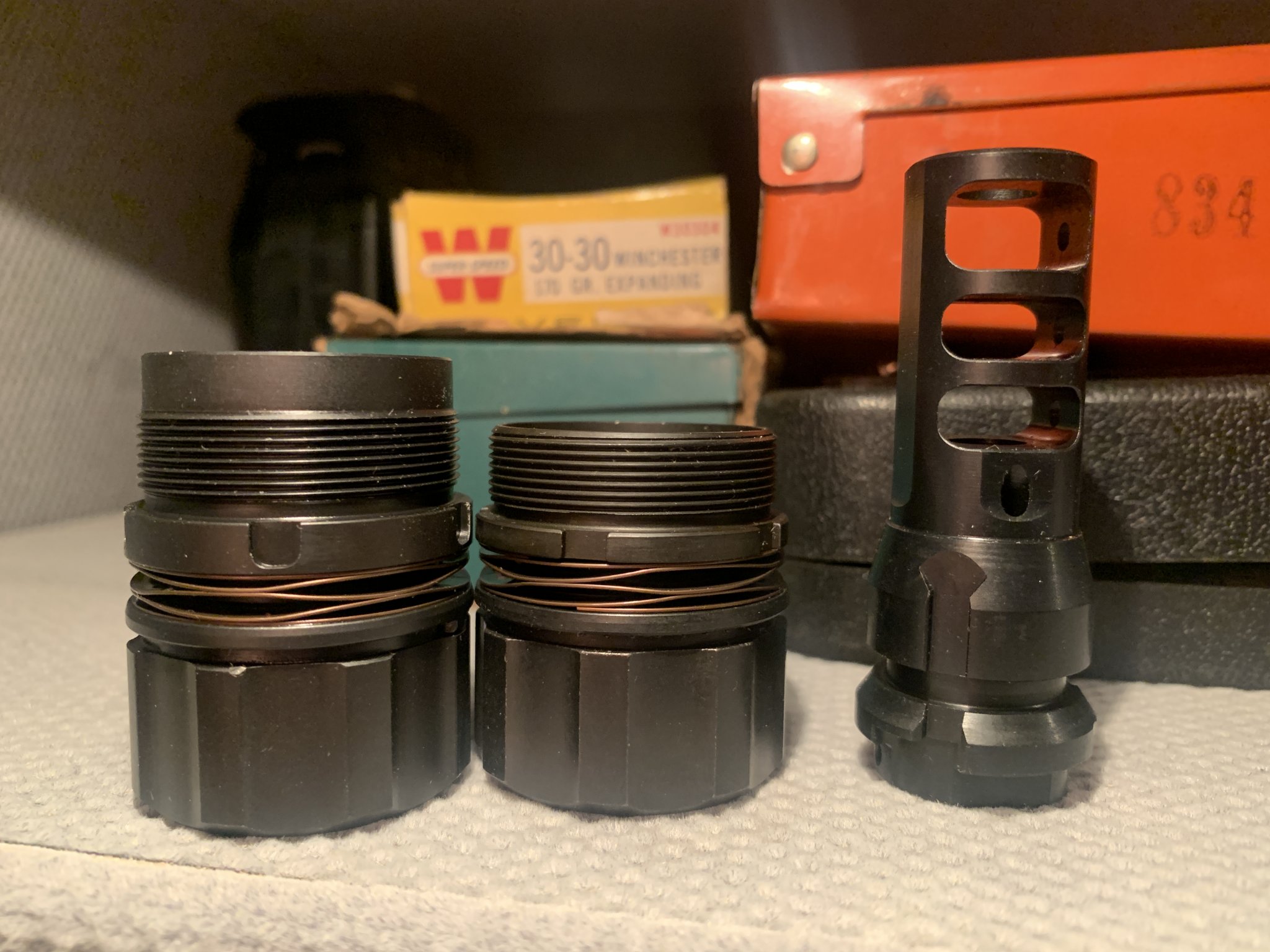

So I’ve had two brand new KeyMo Omega DA428 for awhile but just got another new one in the mail and the néw one looks different. It’s not the micro. Does anyone know of DA changed things up? The middle one is the new one in question.

That is interesting.......... Both of mine look like the one on the left in the picture.
I sent the pic to Dead Air directly. They confirmed with the newest batch (that just went out to all distributors in the last 2 weeks or so), that this is the newly designed (and lightened) version. its just as strong, but they trimmed away the fat some, and shrunk the nut some, about an oz lighter, but it is 100% legit and this will be the design for all newly made ones from now on.
Thanks everyone for your input, i am just glad it wasnt a knockoff.
Just a heads up. I just got a shipment of 6 new style DA428 Omega Keymo mounts. None of them lock up with either the standard brake or the micro. Tested all of them. The new ones measured a .4 to .5 mm larger spring gap and had .35mm play when fully tightened on a brake. I contacted Dead Air over web but I'll call them tomorrow. I literally just checked this out today, so I suggest if you bought and received a new style recently to make sure it locks up.

I called them about this because I noticed the same thing and it’s been a while back but I think there are two diff runs of them.
Update from Dead Air. Something I didn't know but the keymo system is completely user serviceable without any tools. The omega mounts I got were out of time by one revolution. Just had to tighten them over the stop once and they lock up great. Dead air has a YouTube video on how to set the timing for your mounts. Suggest you check it out if you run into the same issue.
