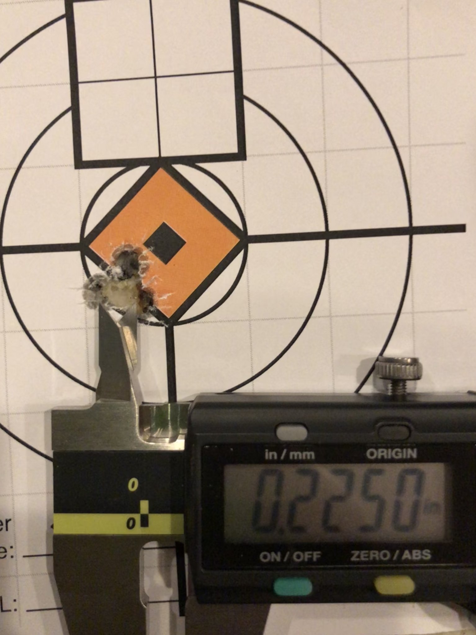

Had a chance to test fire a Sandman K before I bought it for my PR in 6 Dasher. .4 down and .3 right shift but was repeatable. Accuracy was single hole well below half MOA. I bought it and it is currently in jail to run on my Dasher. Great mounting system and you can swap the end caps for different calibers.
